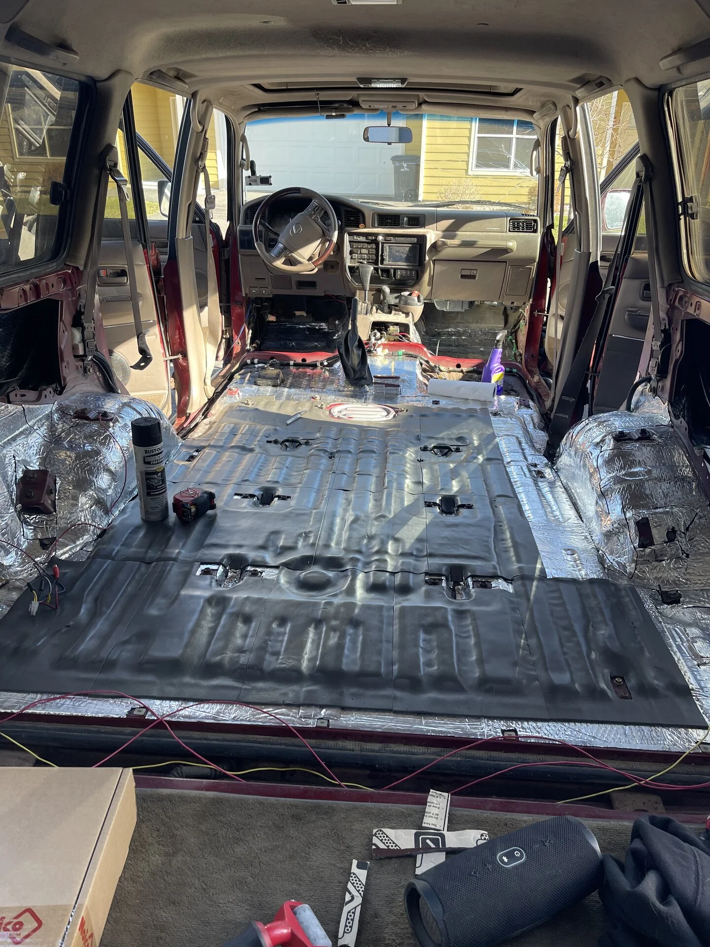

I tore the whole interior out to do some sound deadening and found some rust spots and repaired them.

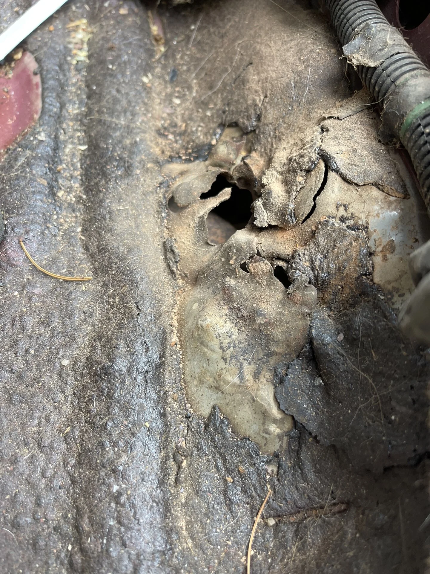

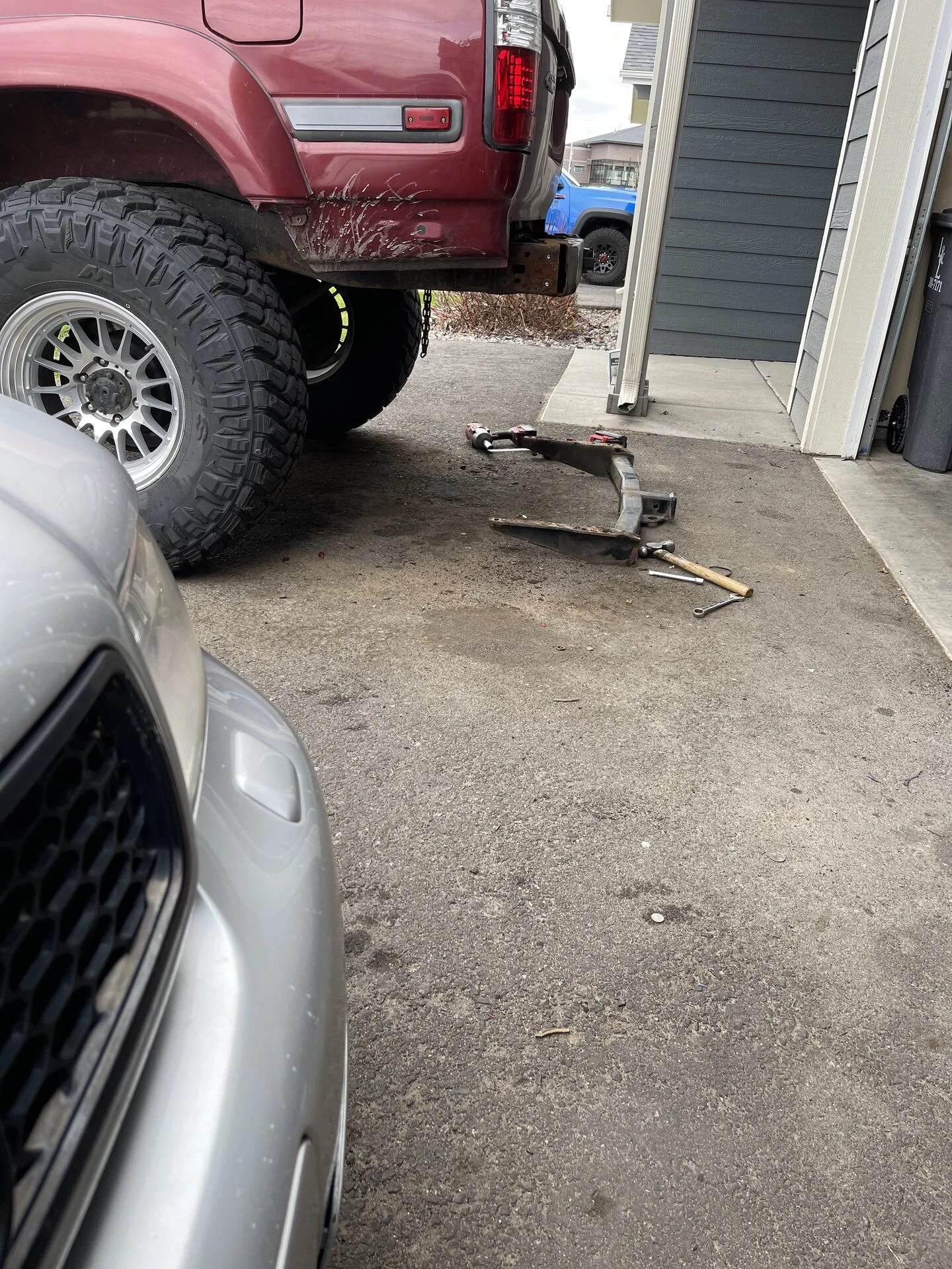

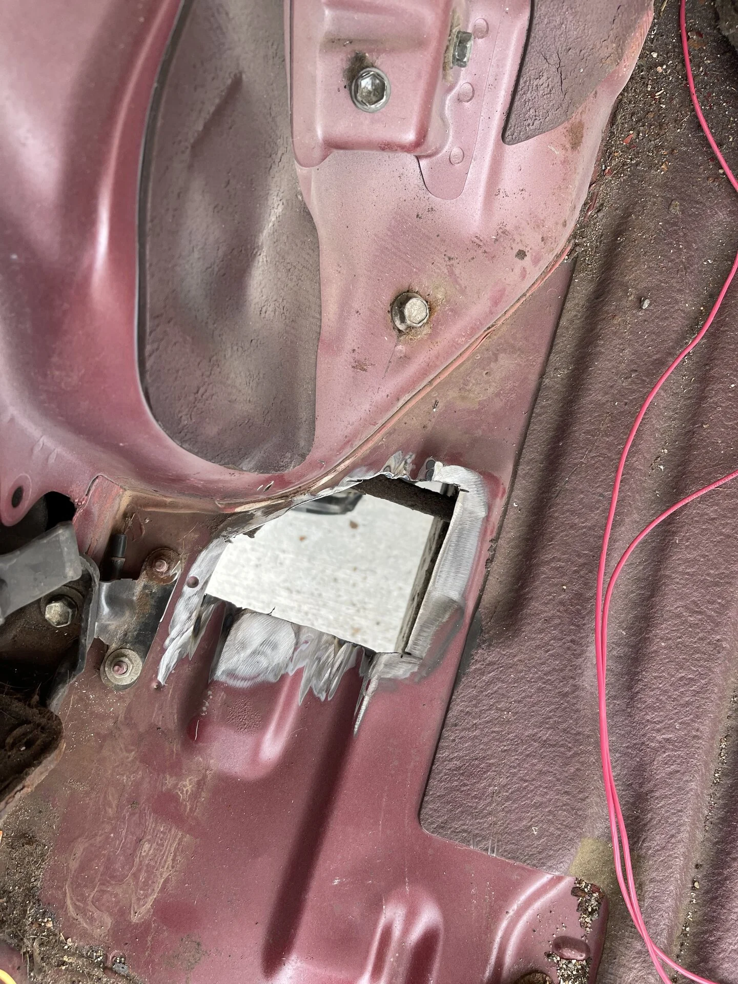

The previous owner had a shop reroute the exhaust above the frame rail. They did a terrible job in numerous ways. Here's how the floor looked under the rear heater.
Here is a shot of the interior fully sound deadened

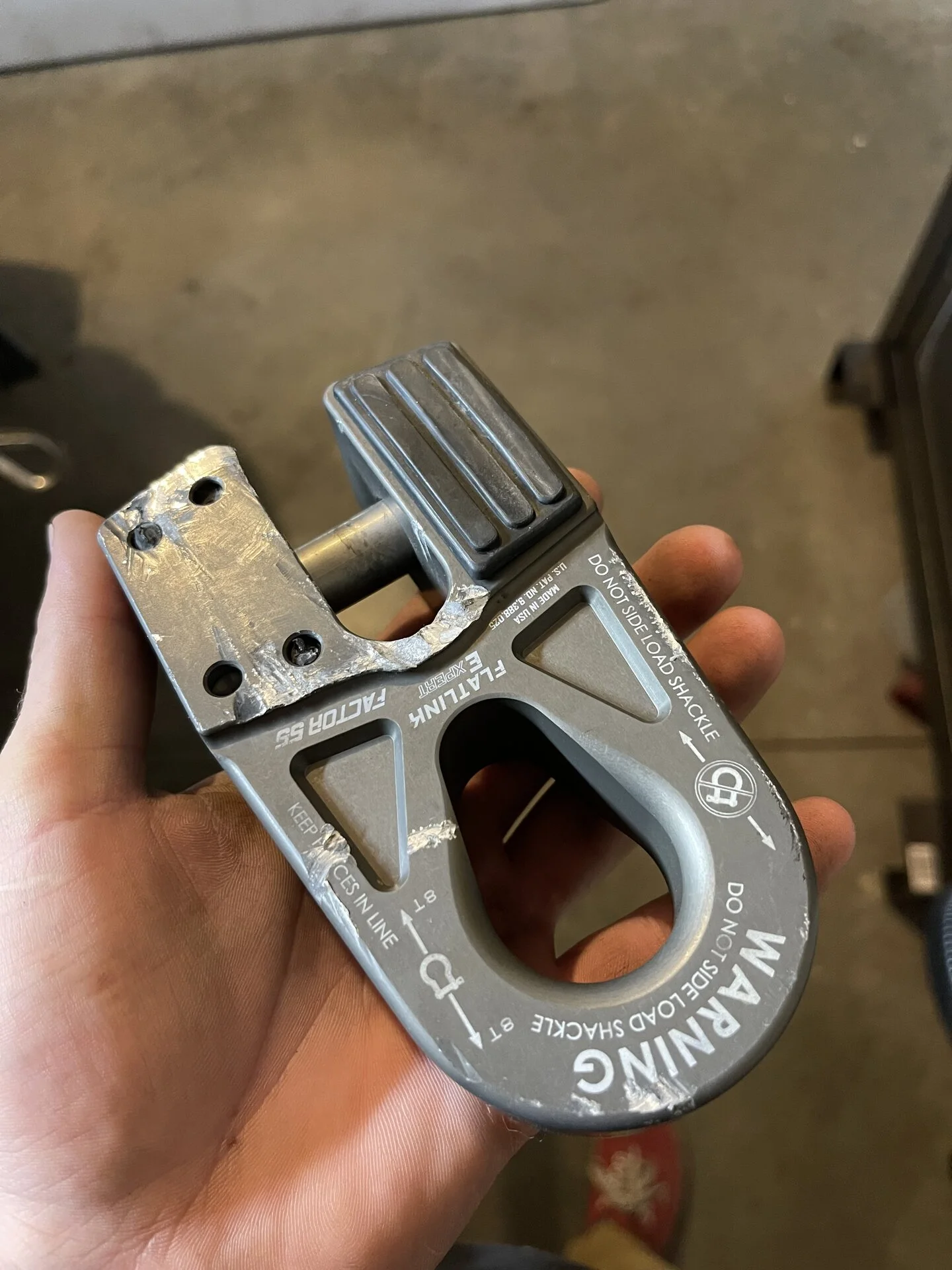

Then this happened. Same thing happened with my last 80. Wrapped it with some duct tape while I waited for the new one to come in.

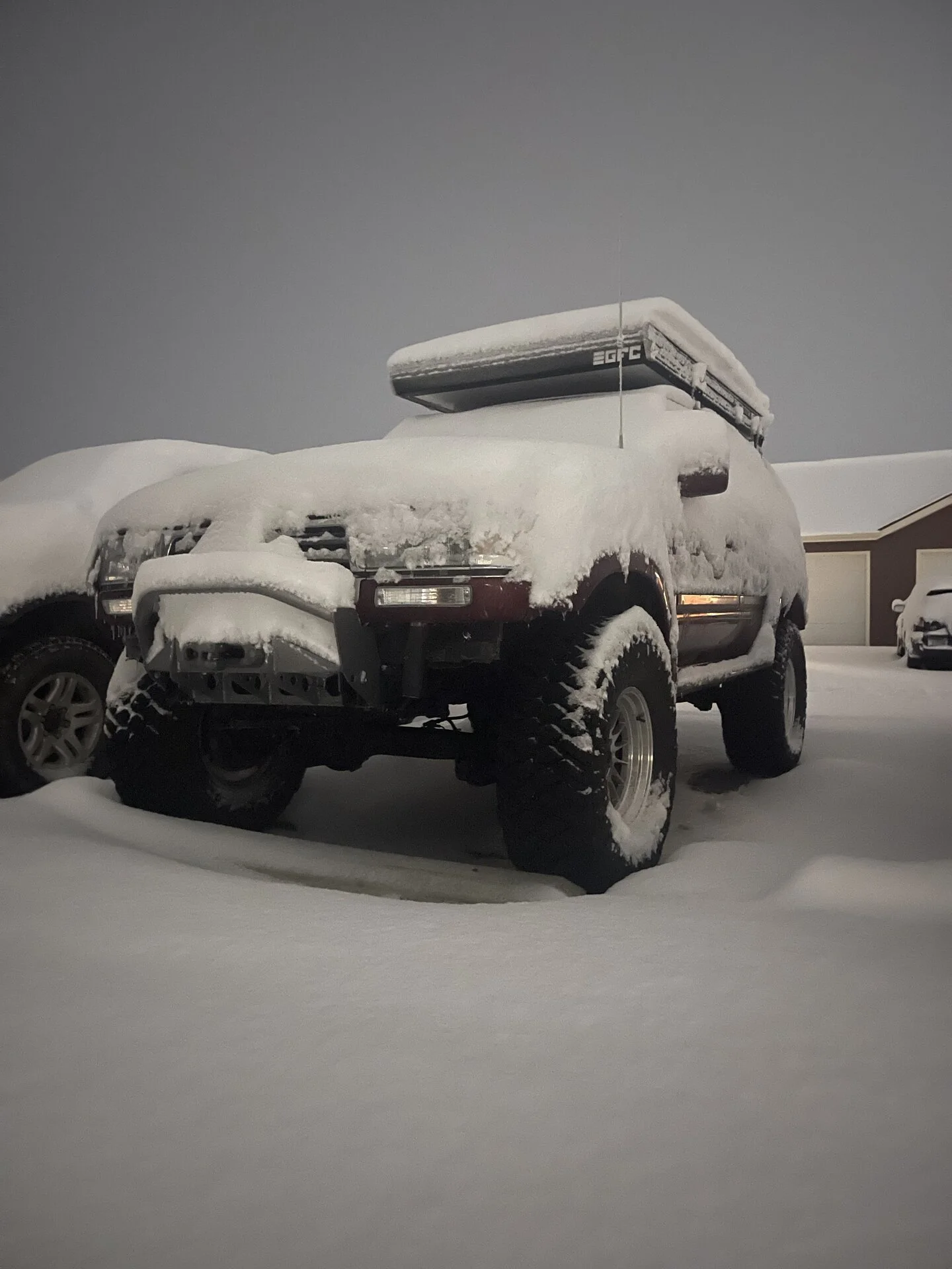

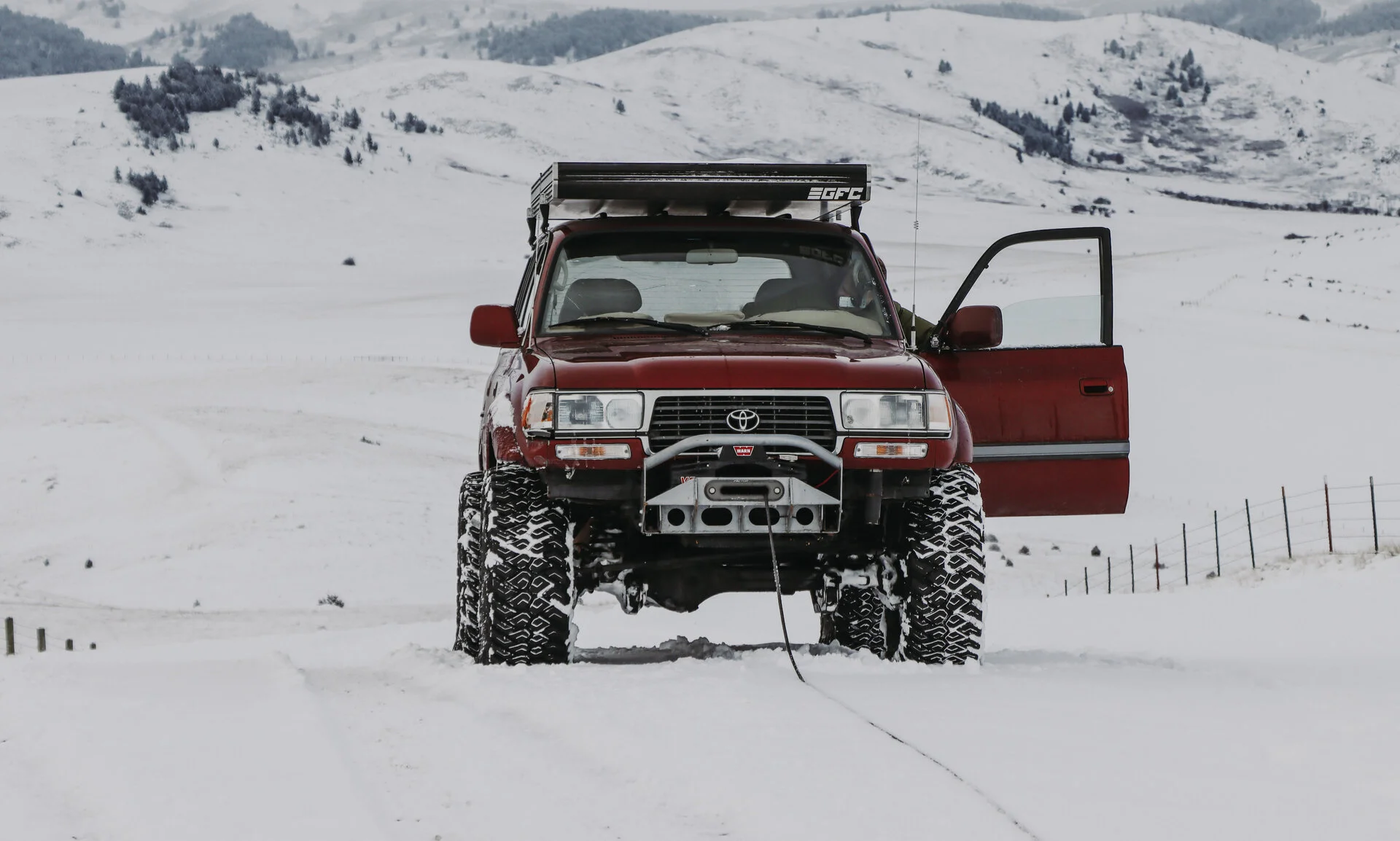

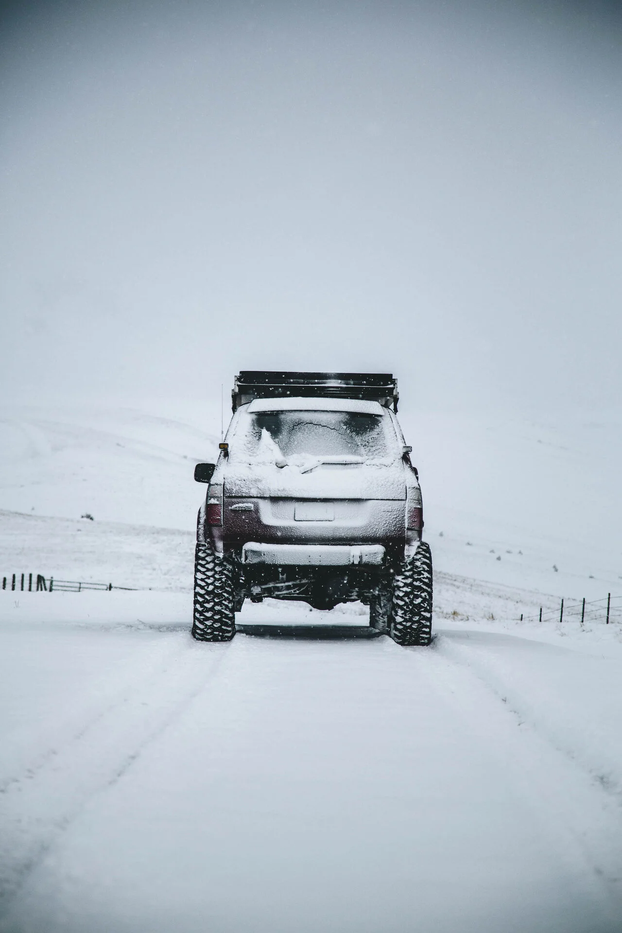

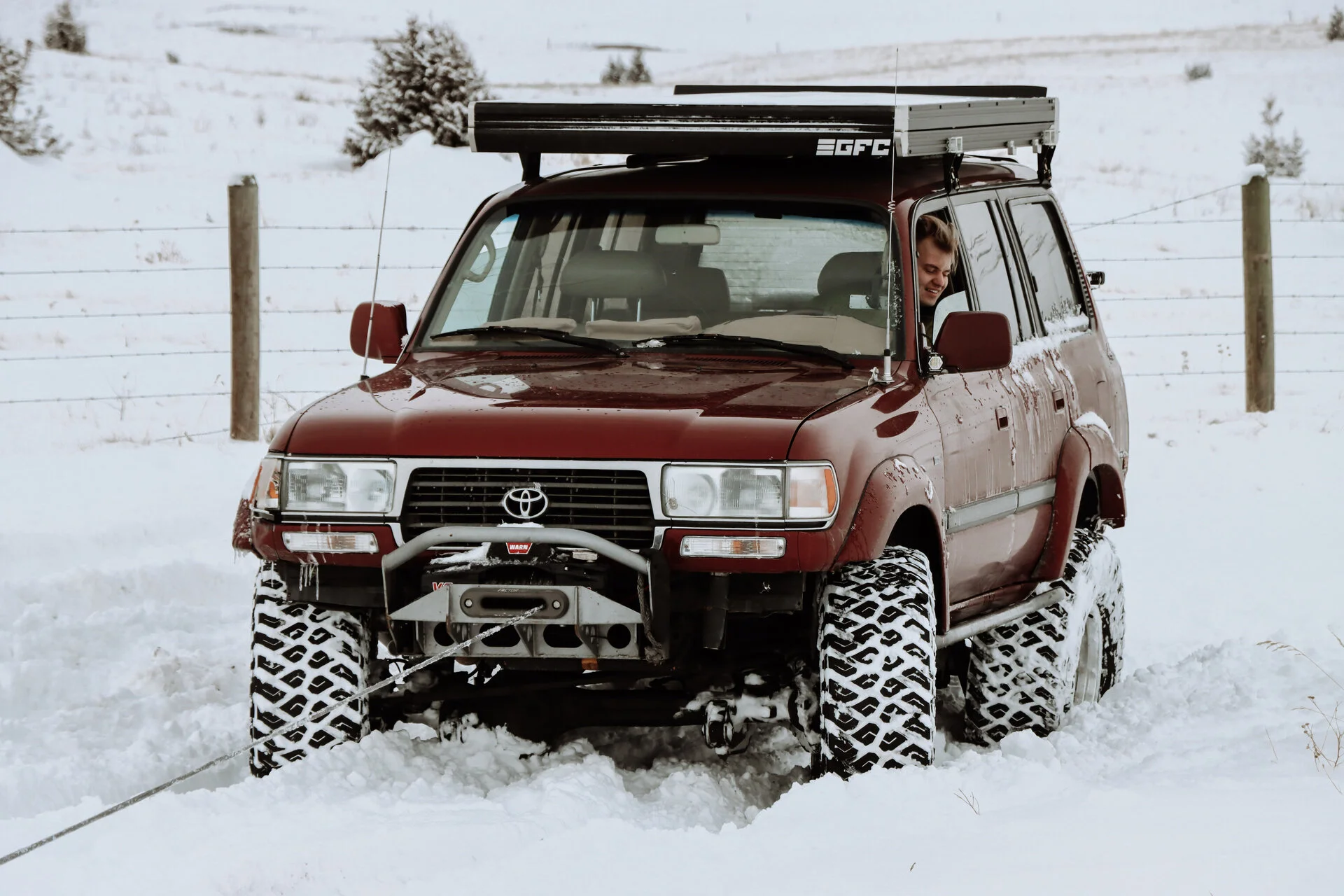

Snow fell and proceeded to have some fun trying to get stuck.

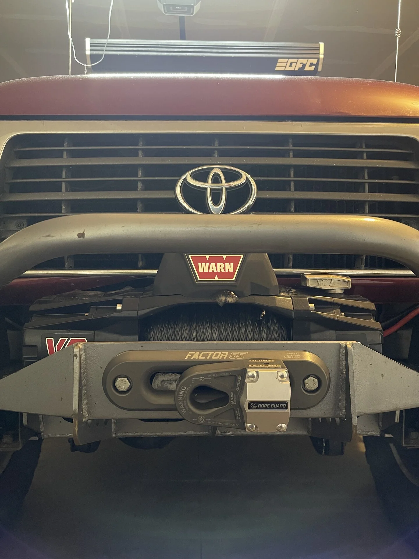

Next, I installed the rope protector that I got when I also bought the flatlink. I definitely should have just installed it at the very beginning...

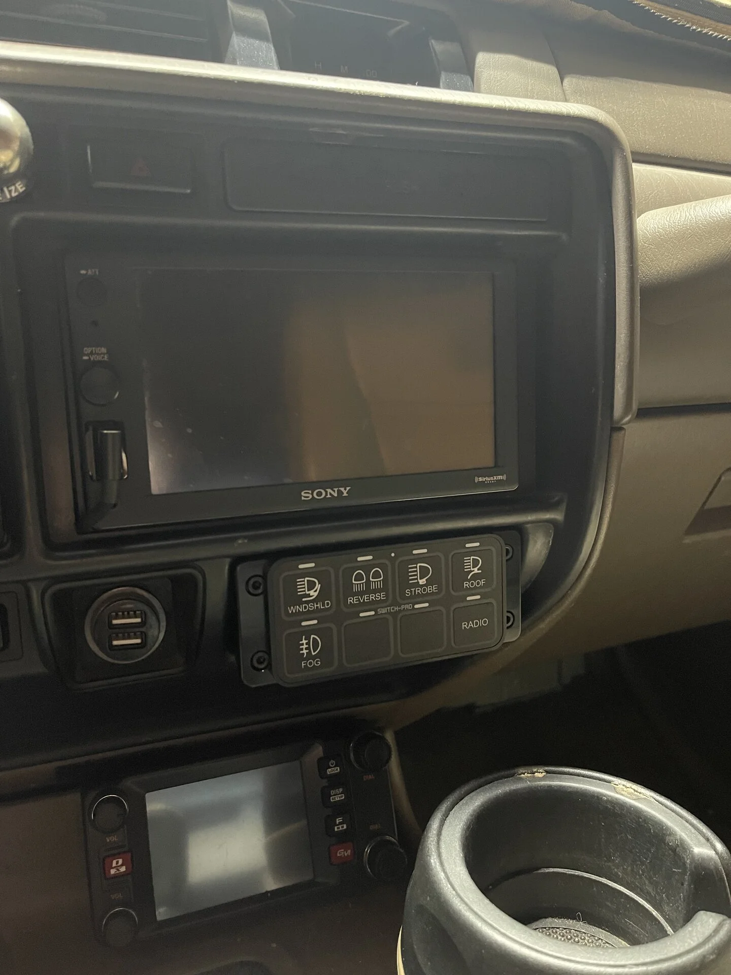

I was finally able to mount my switch pros panel. Here you can also see a better view of how I mounted my HAM.

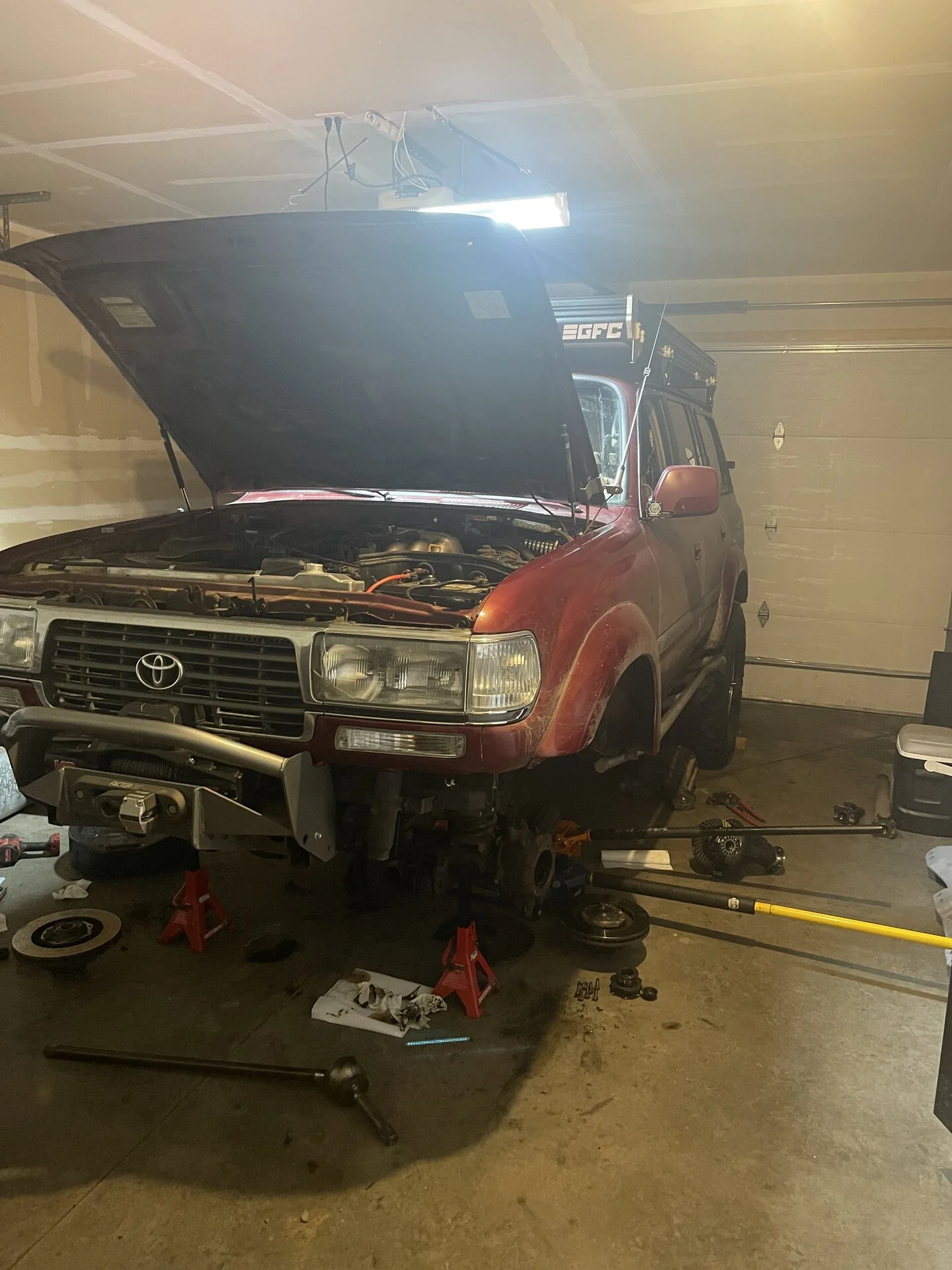

I pulled the axles apart to regear the diffs to 5.29s.

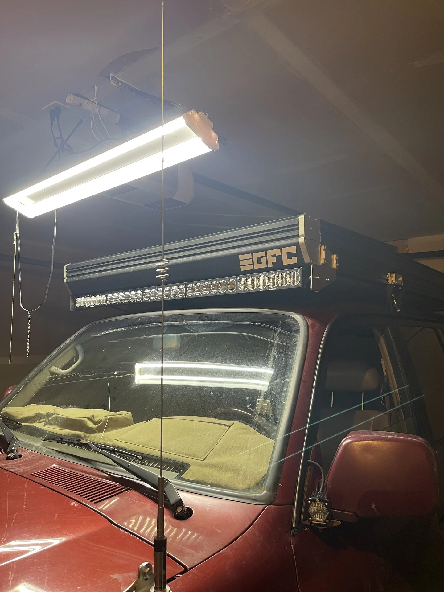

While it was sitting in there, I made mounts to attach my light bar to the tent.

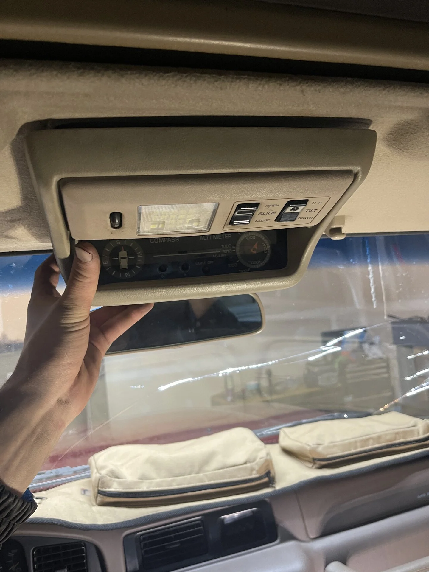

I found a JDM roof console gauge thing locally and have still not put it in.

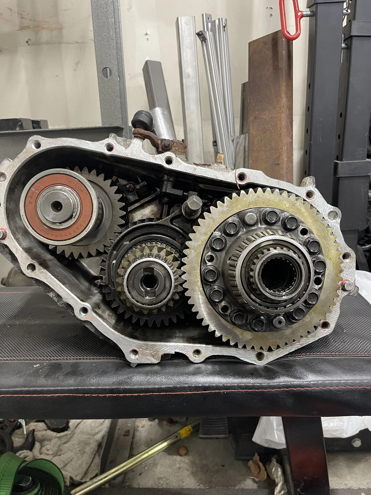

One of the engines I got came with a t case, so I took that apart and installed 10% underdrive gears and 3.whatever:1 low range gears. Then I just needed to swap t cases. badabing badaboom.
OH! While I had the t case apart, I welded up the viscous coupler to create a spool because these arrived.
Now it became a real Land Cruiser

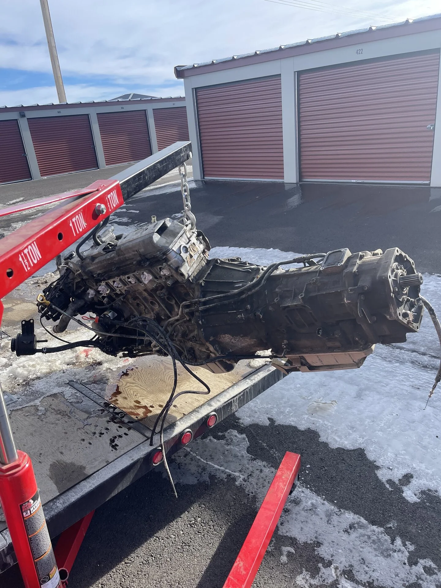

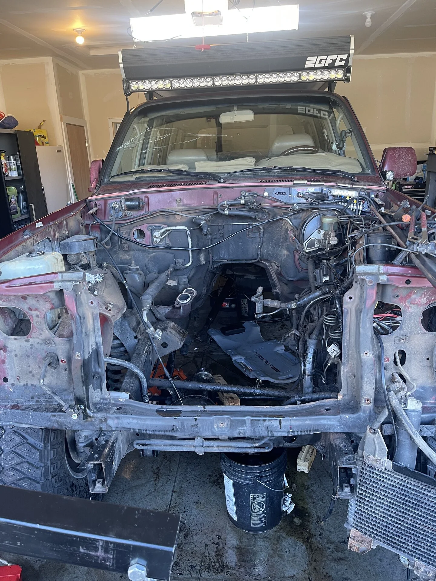

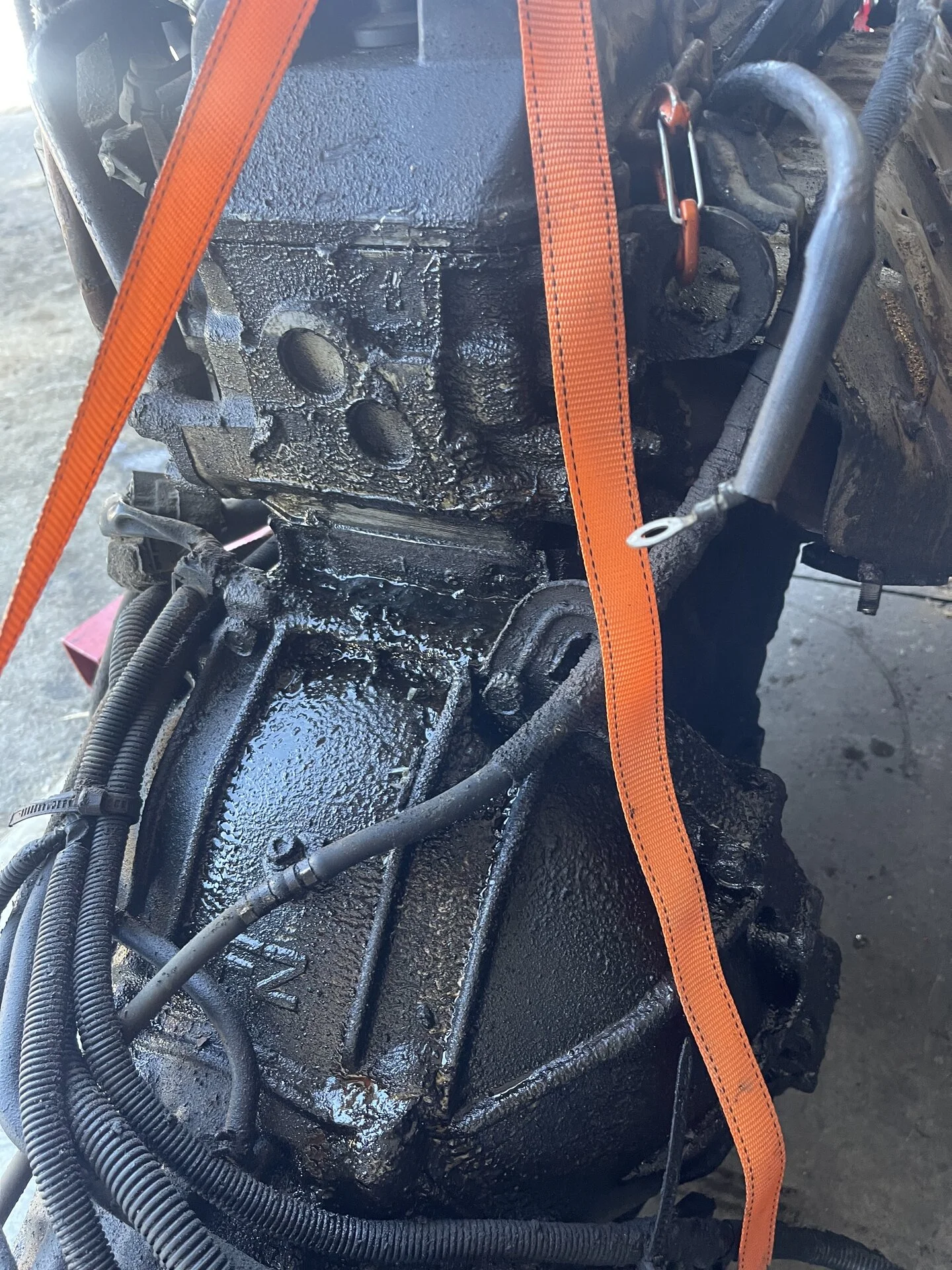

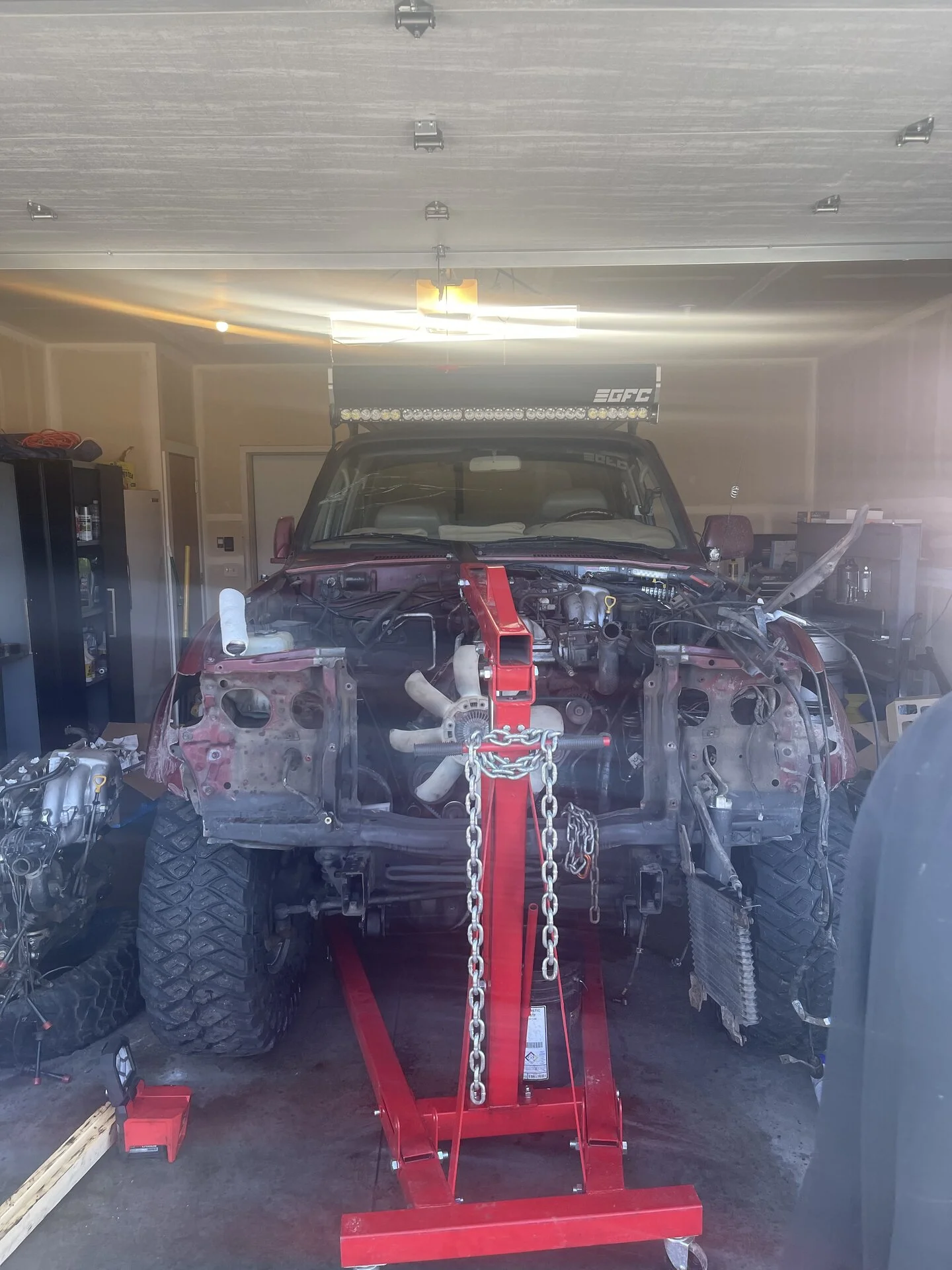

By this point, the engine was springing new leaks left and right. There was a constant drip of coolant from the back of the block. It was time to yank it out, so into the garage it went.
Once the engine was out, I could see where the coolant was leaking from. It was coming from the head gasket behind cylinder 6. Better to leak out than in I guess.
