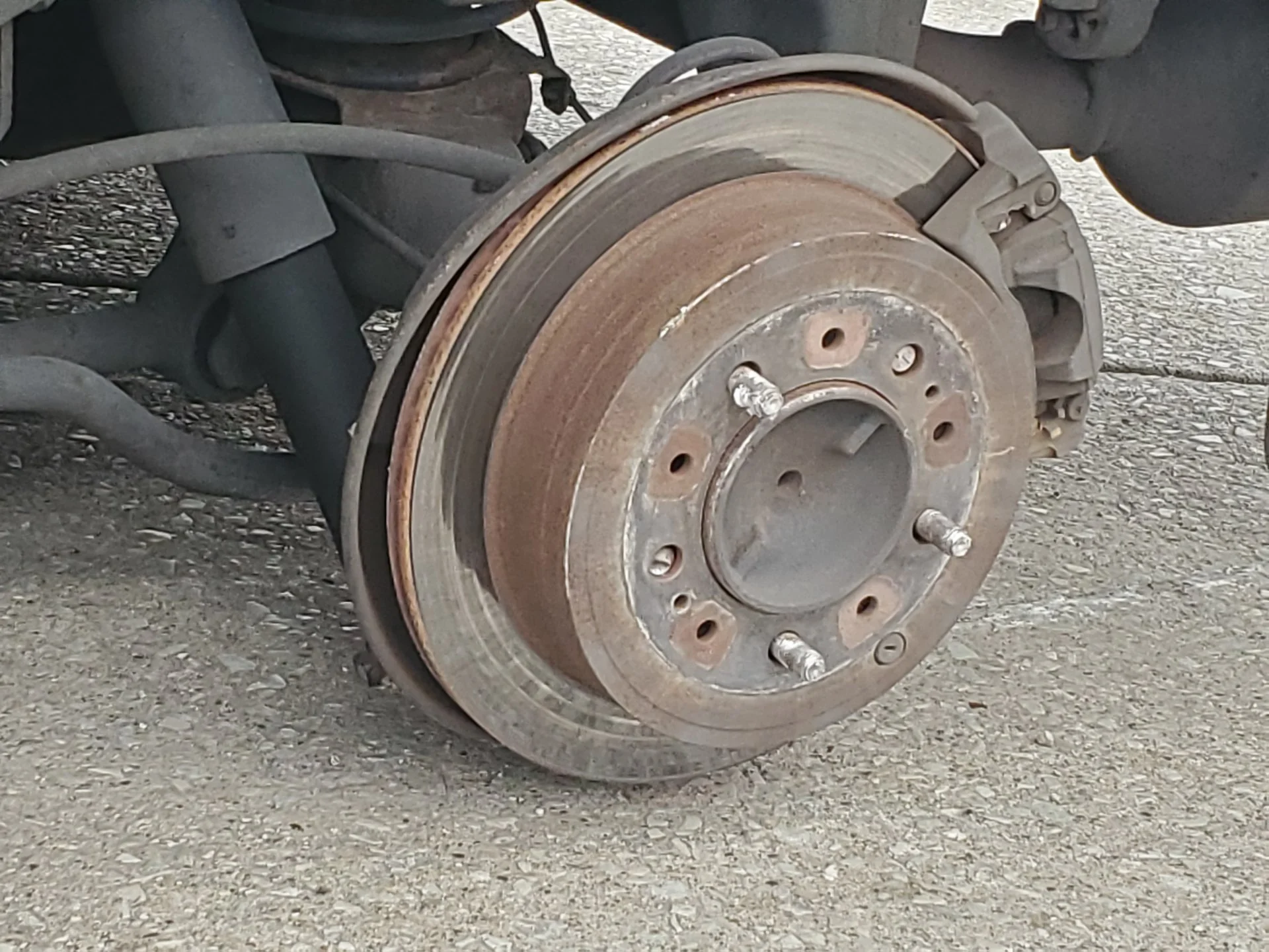

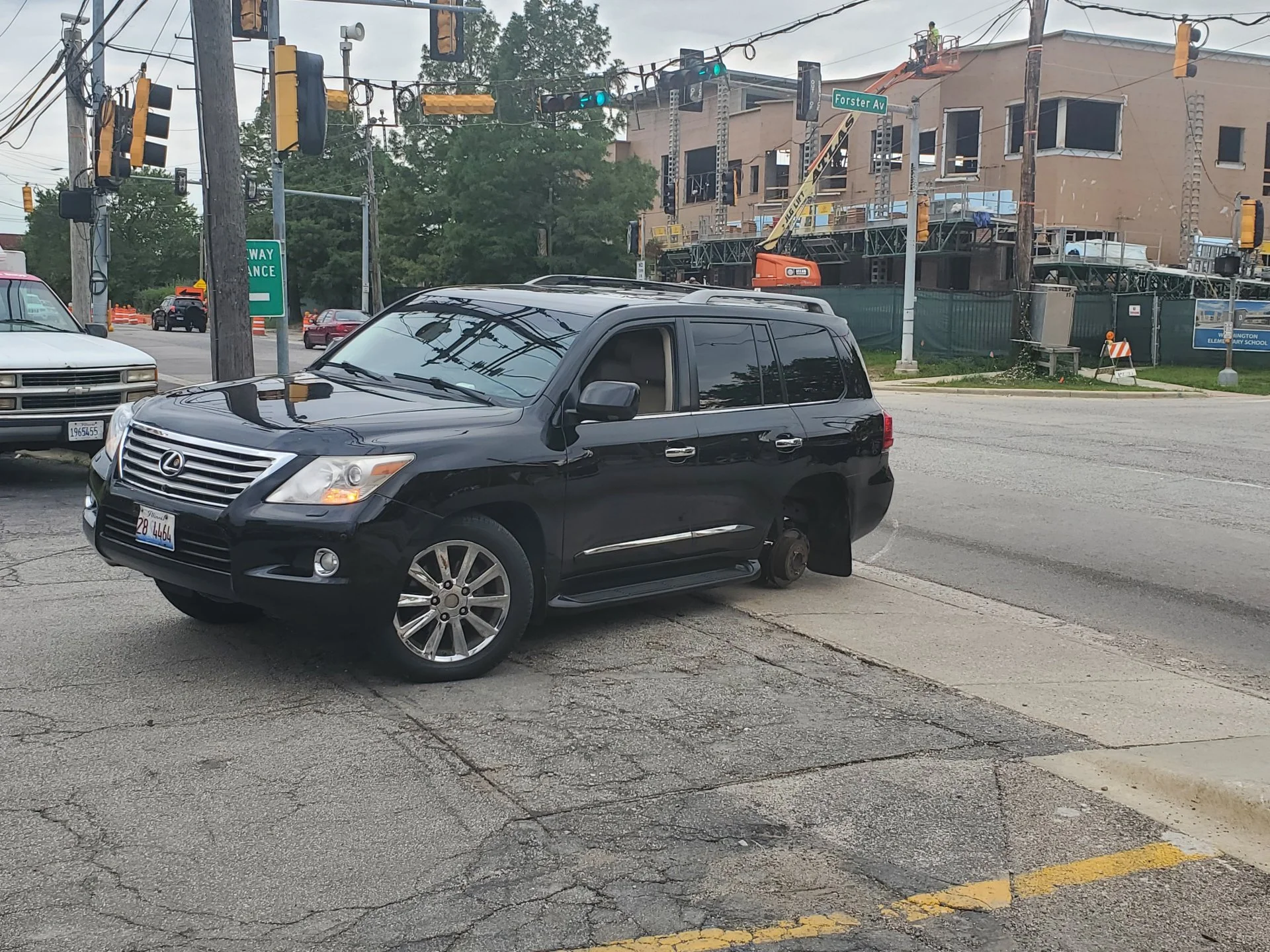

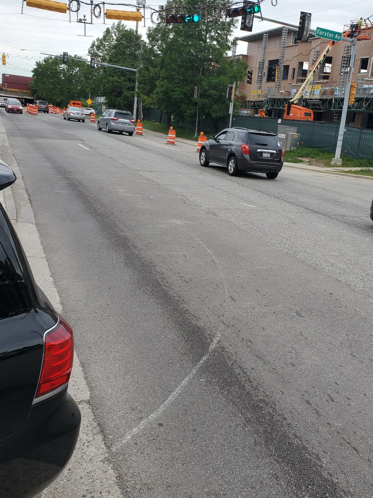

Yeah, Unbelievable, but this happened Friday Morning. Tires were installed Thursday afternoon. Fortunately, I was slowing for a red light when driver rear tire rolls 30 yards into the car opposite me at the red light.
I scraped a nice 20 yard arch to dead stop. Had a Flatbed tow the car back to the guys that sold me the tires.
Shocking how they addressed this. Since they were unable to fix, Manager encouraged me to drive it home with three studs before the tow driver intervened.

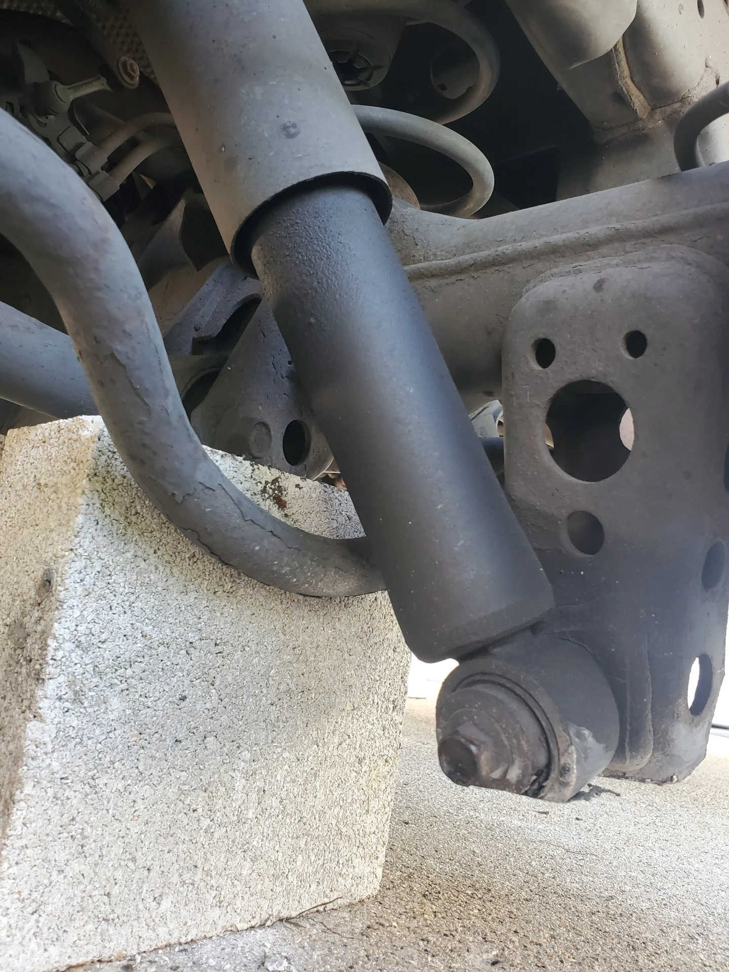

I'll add some pics to this in a minute, but there's a little body damage and my brakes suddenly got spongy.
No evidence of any leaks. Rear Shock is toast, but I'm able to drive. Found another mechanic to replace all the studs. Discovered non of the tires lugs had been tightened. Could have been any one of the tires that fell off.

Make sure to check the lug holes in the wheels out well on all four tires. They get wallowed out pretty easily. You can see aluminum in the threads of the lugs on the wheel that fell off, I'm pretty sure that one is toast.

Are the brakes still spongy? The initial feeling could be because the brake rotor wasn't clamped to the hub face, which will push the rear caliper piston back more than usual.. when you hit the brakes it has to move a lot further than normal to actually clamp that disk. If the spongy feeling didn't go away after a few pedal presses once a wheel was mounted, could be something else.

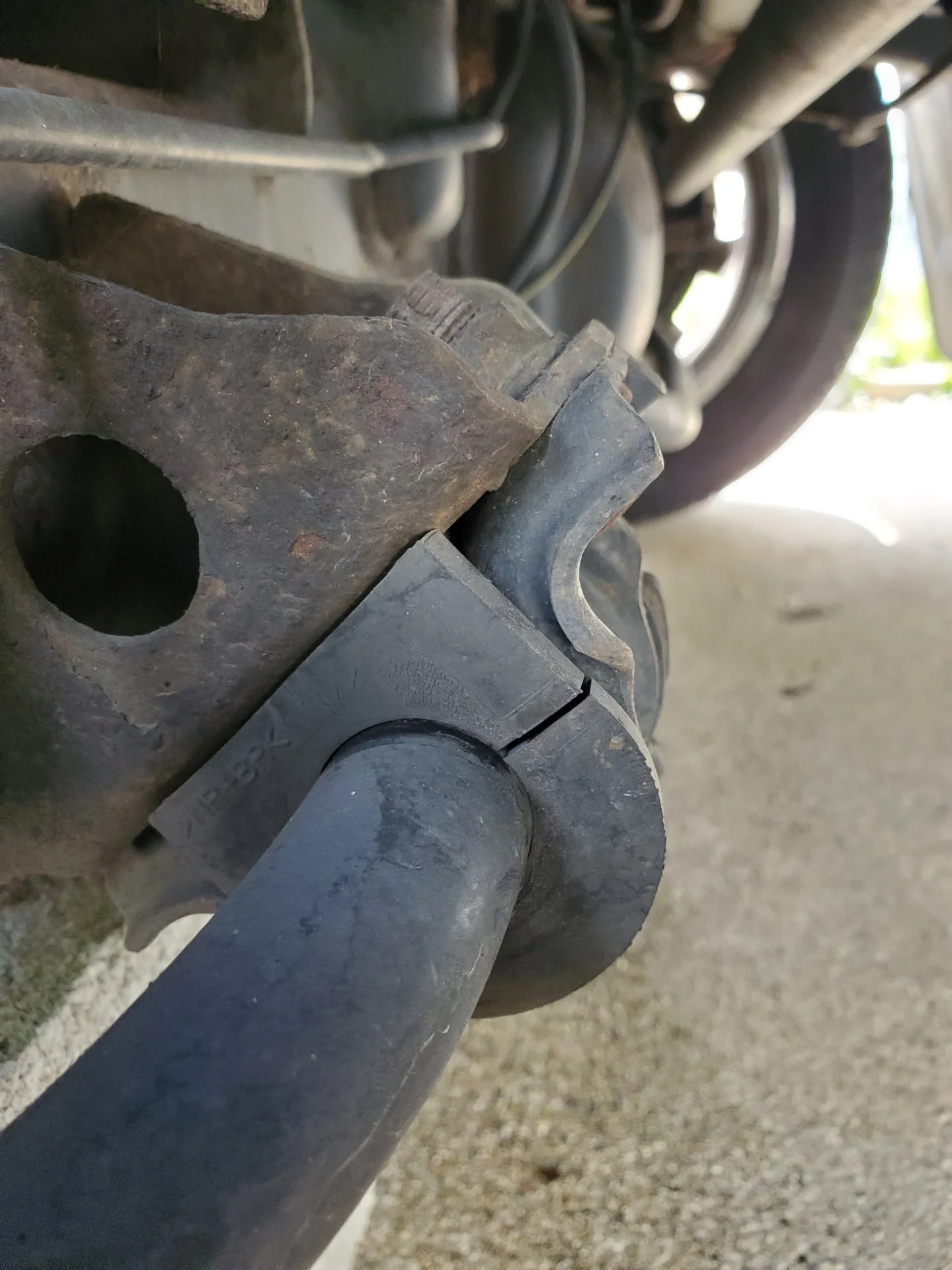

Also your last picture of the sway bar bracket is normal, that curved metal is supposed to be like that and the gap in the rubber. The rest? yikes.
