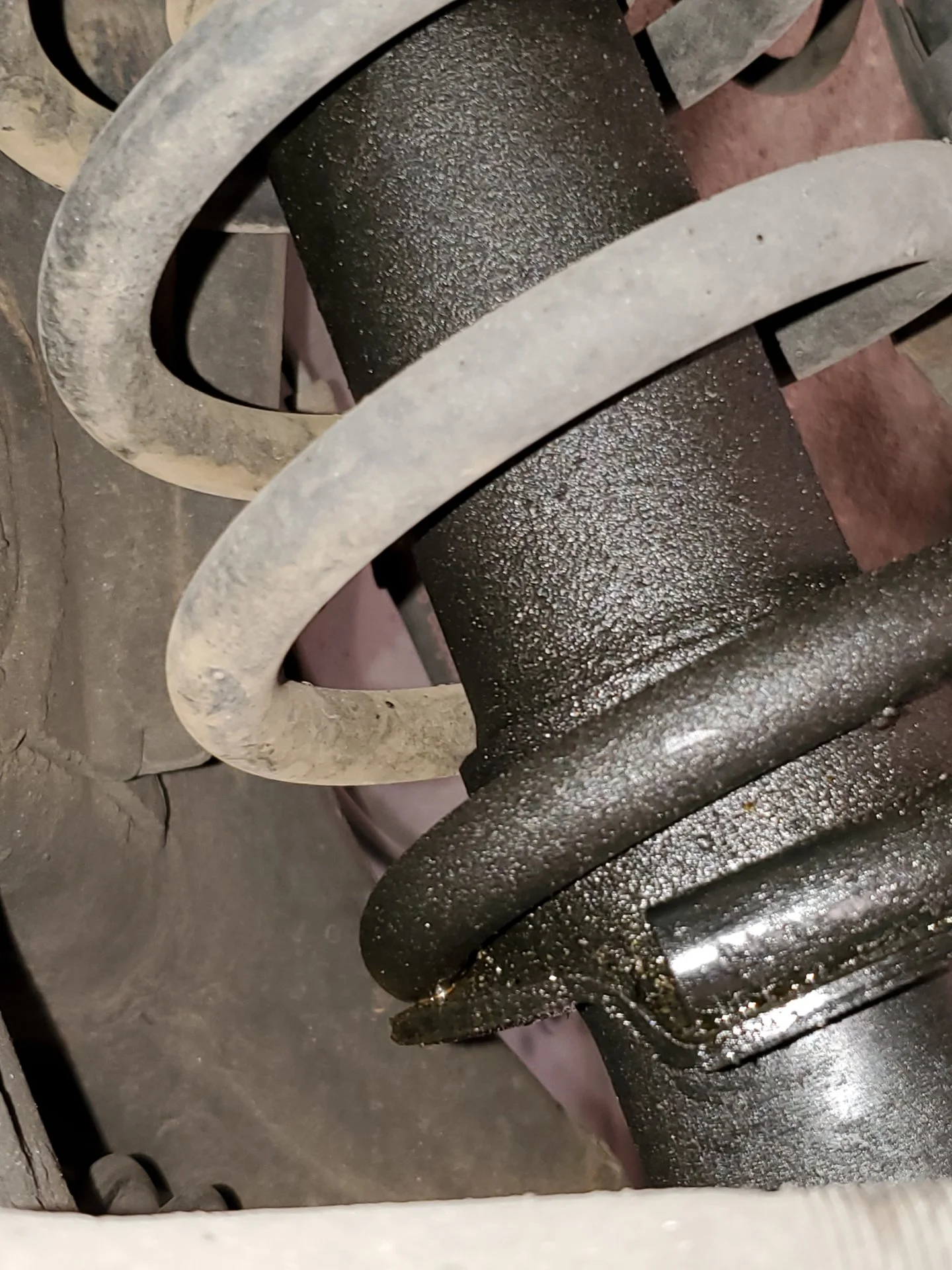

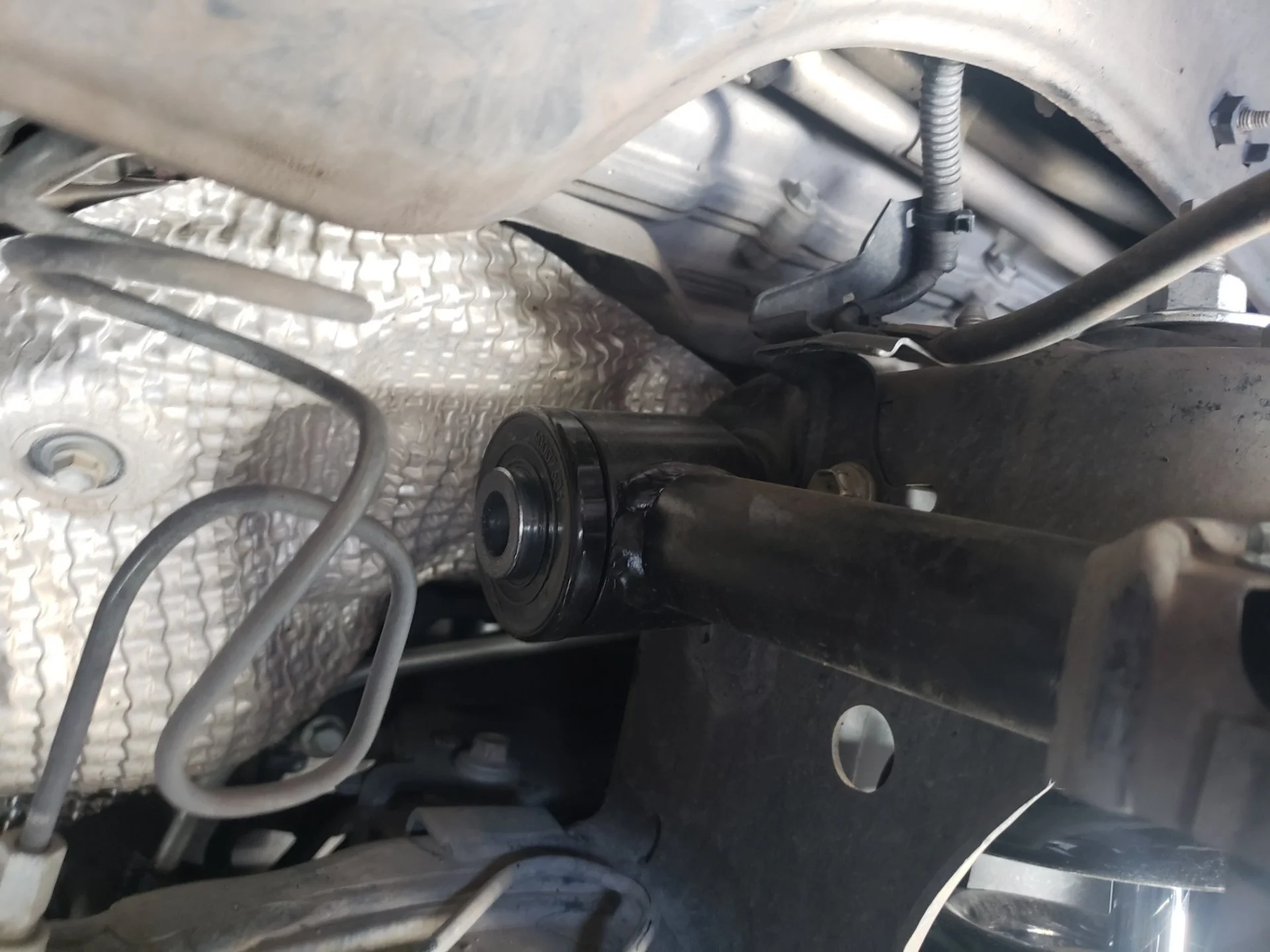

This service was handled by the same tech who just inspected my 570 for damage from the tire; he provided the estimates below to fix the damage caused from the tire and then some.
Rear Shocks-$1040
Rear Caliper Silde Pins Siezed; $471 [$46 in parts and $425 in Labor] (why not just a new caliper?)
Both Front Struts Leaking Fluid: $1555 [$710 labor & $844 parts]
Flush for $169.
I decided to have my local guys handle the Caliper issue to get rid of my sponge problem.
Ultimately, they replaced the pins on the left and the caliper on the right. Whatever.
There was no mention of any leak when he replaced the actuators 4 months ago. Obviously this is new.
So, I go 285,000 miles with only having the Starter, Alternator, the bull**** 02 sensor/charcoal replacement jazz, and a power steering pump fail on the Lexus LX 570. Everything else is original. No maintenance outside of oil and pads and that's also going 100% Regular Gas as of 2015 (no difference at all, btw). Half the things that failed were from user error.
The pump was definitely user error as I believe the Charcoal canister my error as I always over topped with gas. Yeah, I know. BTW, new canister did nothing.
But, after my 6 ton rig scrapes itself along the concrete, rotor, and shock absorber, is it not highly probable this impact 'inspired' the leak upfront. I mean come'on. The car's been almost bullet proof 12 years and 313,000 and suddenly I'm being stuck with these byproducts of my vehicle being body slammed by BS out of my control events.

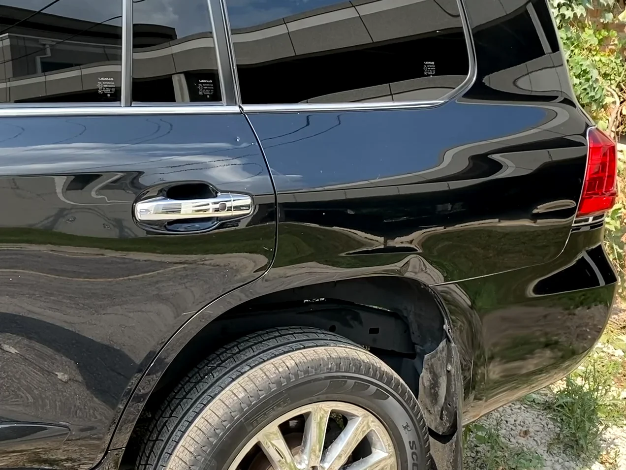

FYI, body damage pics added.
I’d find it very unlikely that the rear wheel falling off caused the front shocks to leak. You just probably didn’t notice before the incident made you look.
Even the rear ones at this mileage are most likely a regular replacement (you can see that they are a bit darker at the bottom where there is moisture from a slow leak - pic with the wheel off when it broke) as well as the caliper / pin issues are a Chicago thing (rust belt)
Btw: you can buy original Lexus rear struts for about $60.00 a piece online and the replacement is pretty easy - I can't see it costing over $1000.00 unless someone is making a pretty good mark up on this.
