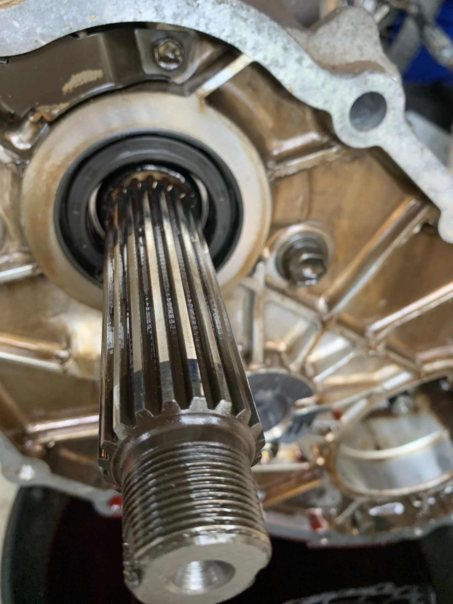

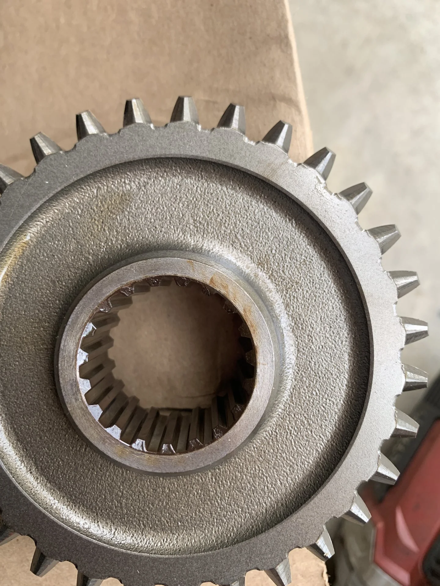

Check your input gear splines for wear before you get too far. Highly highly recommend a long spline input gear if you aren’t planning on doing 4:1 gears.
How do the splines look?
The "splines" are on the inside bore of the (any) gear. The "teeth" are on the outside.
Gotta take the gear back off to see the splines.

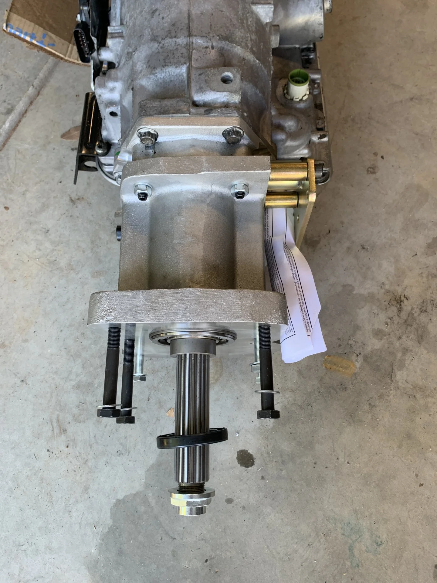

Last question for today - I'm using the stock cross member and want to be sure the transfer case is as close to the stock position as possible. I tried fitting the transmission mount to the AA adapter and noticed the two bolts that connect the mount to the crossmember are offset, not centered. Any thoughts on of this should be offset toward the engine? Or offset towards the transfer case?
