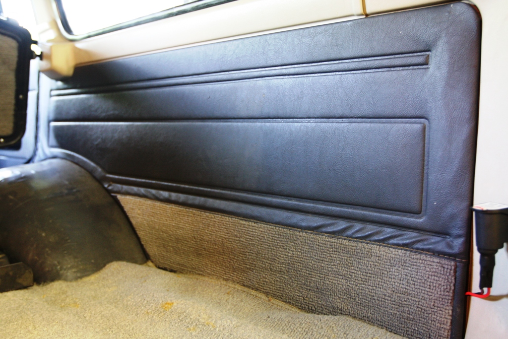

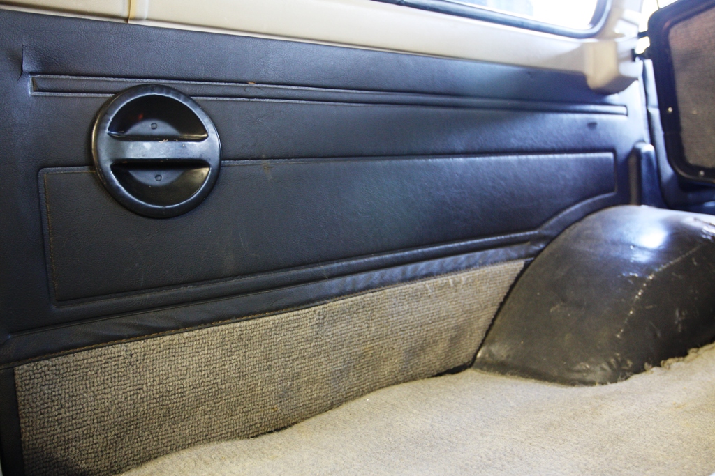

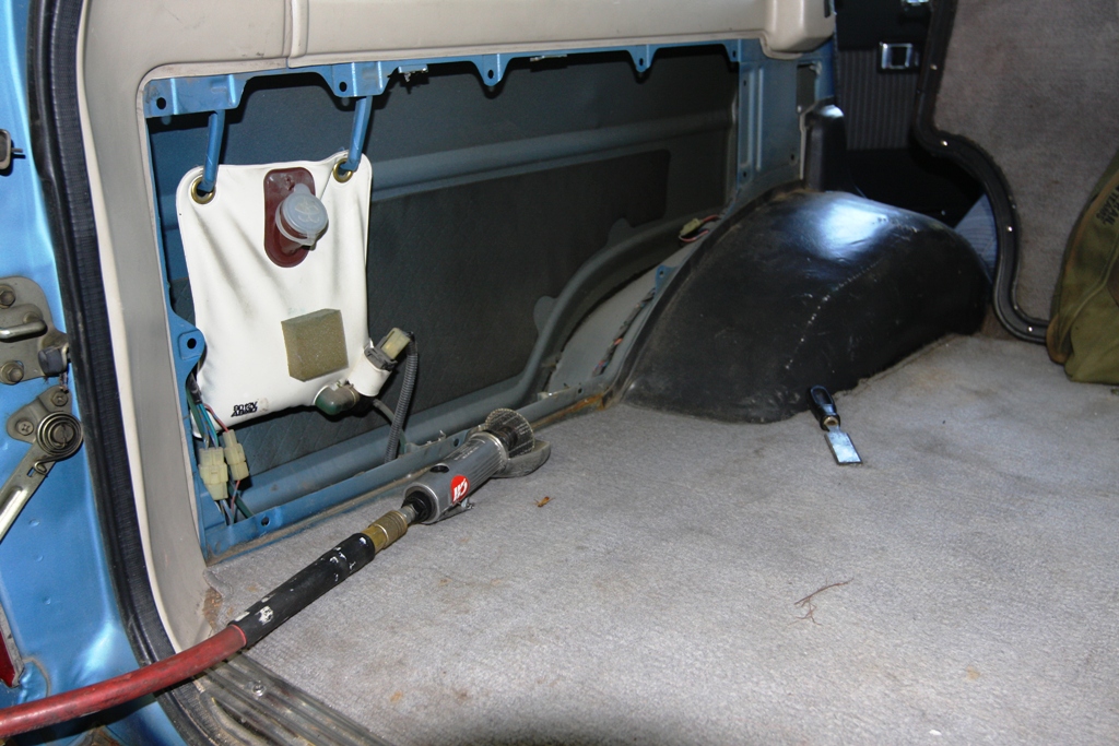

I started on the driver's side as it is the easiest. All I had to do was remove the panel, then remove the plastic inserts that hold the panels in place.
From there, you simply remove the 2 vertical supports. Either with a sawzall or a cut-off wheel. If you are super anal you can drill out the rivets, but I made sparks instead :smokin:
wagongear.com suppplies all the hardware. Stainless Steel button heads are pimp.
About 5 minutes later it was bolted up. I moved my washer bag to hang on one peg and pushed it to the rear for more storage room in the cavity.

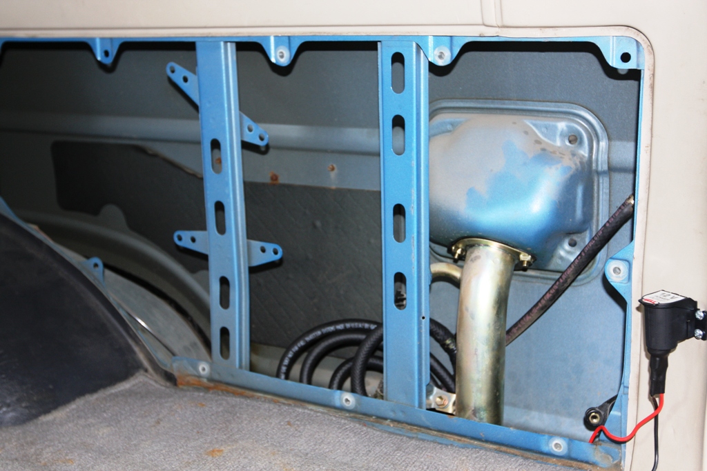

The passenger side is a bit harder to deal with because of the fuel evaporator unit that is located on one of the crossmembers.
I picked up some 5/16" and 3/8" fuel line to relocate the evaporator to the back right corner. For the record, you need this much hose:
Here is what it looked like before I started and with the evaporator removed.
I extended the lines and mover it to the back out of the way.
Here it is tucked away in the corner

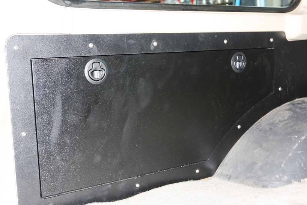

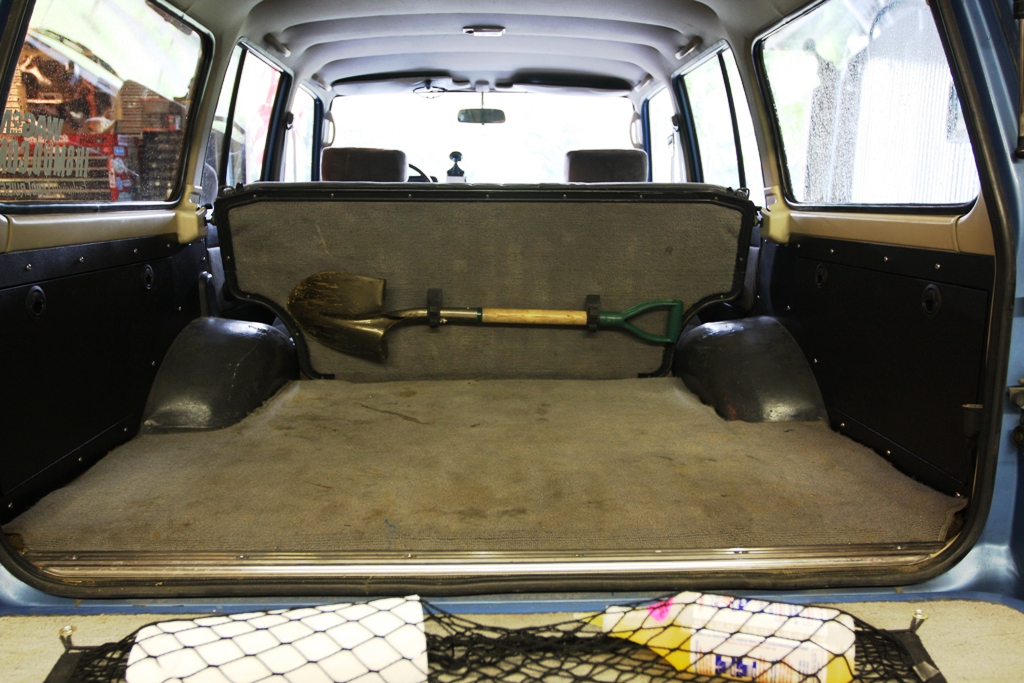

And the final product....
Here is the final product...very clean. These were about $450 shipped. Much less than quality drawers and they don't take up the space and weigh as much as those things do.

It looks like after you moved the fuel evaporator that you have a bunch of rubber hose coiled up. What is that for?

As for the hose, that is just the way they are routed. The vents are all pointing to the front of the vehicle, so the new hose has to bend about 160* to go in the new direction needed to relocate to the corner.
