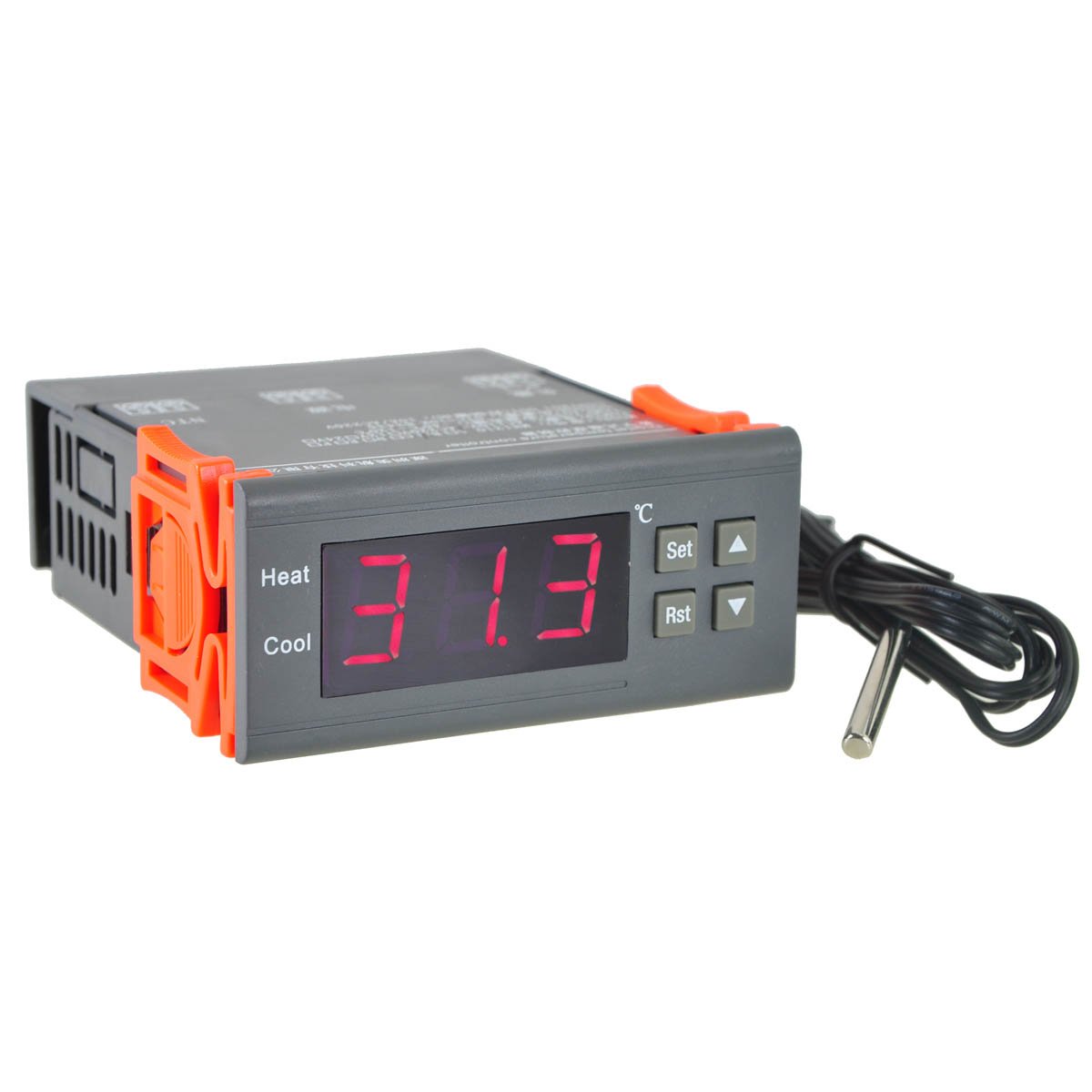

After pricing new ARBs and Engels I'm now back in the mode of "one last try". Ordered a new thermistor from way-cold.com and will see if that helps. Next step may be to bypass the controls altogether and try one of these.
C° only?
Not sure if C only. Lots of similar looking controllers on the Bay. Will cross that bridge when I get there.

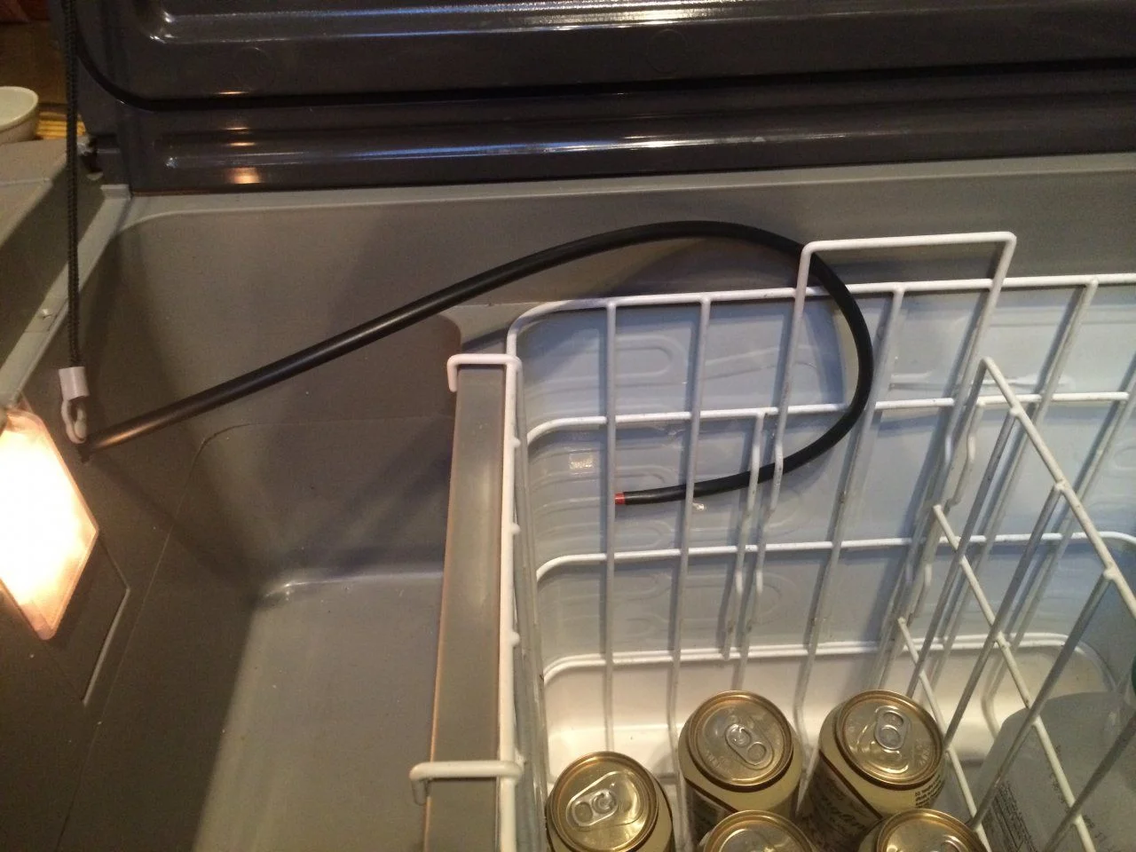

So I installed a new thermistor this evening. Will report on how it performs tomorrow.

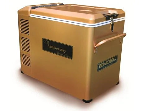

The last 12v failure was last straw, so i bought a gold engel as pictured. Only had it for 6 months and it lives permanently in back of wagon for the wife to put shopping in, time will tell but I have never heard a bad thing about engel reliability.

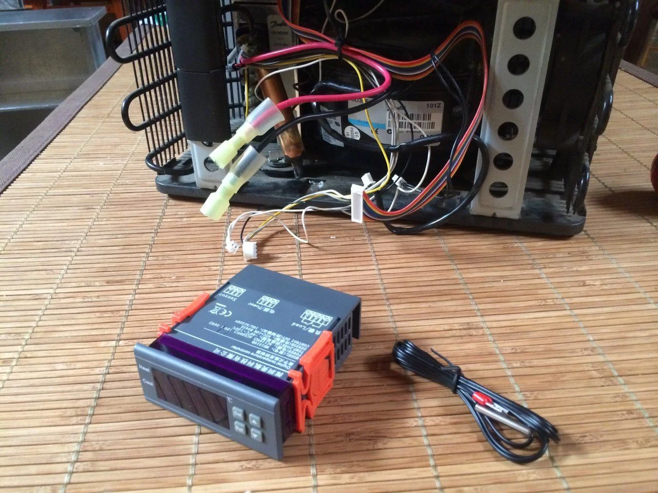

Spent another $15 today:
Okeler 12V Digital Thermostat Temperature Controller
I'm going to bypass all OEM circuitry and connect this directly to the compressor. This comes with it's own thermistor. The plan is to do a temporary install with wires coming out of the cabinet and just velcro this to the end just above the carry handle. I'll just run the thermistor cable through the open lid, close it and throw a couple towels over it. Then if all goes well through test phase, I'll figure out a way to mount the controller in a more streamlined manner. The main feature that will be bypassed is low voltage cutoff, so I'll have to be more careful about monitoring my battery.

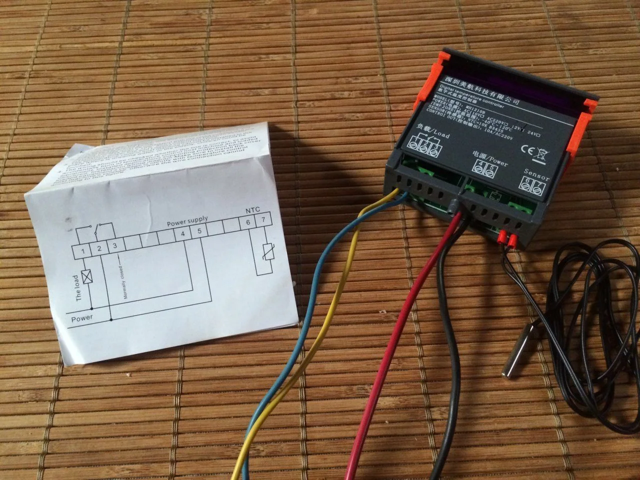

So I finally got around to hooking up this controller. I guess I should have gotten an engineering degree, because I can't get this thing to kick on the Danfoss for anything. The Chinglish instructions are horrible.

It was my birthday yesterday. My wife spent the last month conspiring with my friends and family and a vendor in Dallas, TX to arrange for this. Just couldn't be happier! I'm sure my wife had to bite her tongue as I spent Saturday afternoon trying to get the p.o.s. Waeco working again.
