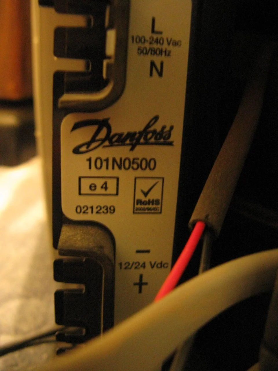

Do you have the board in the picture below available?
It is inside the pictured plastic box
That's the only board I didn't replace because I couldn't find a source for it. I replaced the main PCB mounted to the end of the casing where the power plugs into and the upper control PCB.
So, yes, I have the original, but I suspect it is the primary failure in my case.

What is the part number on your board/black box?
I'll have to check. Been a while since I even looked at it. I don't think its visible in any of my previously posted pics either.
