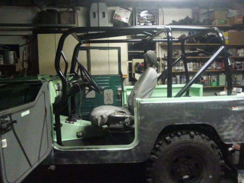

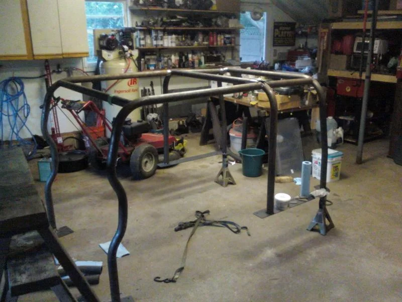

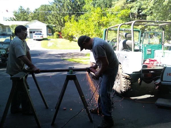

Metaltech cage fit up went well on Saturday, thanks to Dan and Mike. I don't think fitting a cage is a one man job.

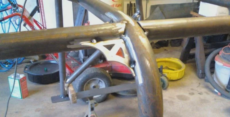

We made a basic template for 90 tube cuts and got to work, c-pillar, then b-pillar and finally the front A--pillars. The first notching took maybe an hour....cutting and grinding an 1/8th to a 1/4 at a time. The final tube notch at the end of the day took maybe 10 minutes.
Anyway...it is stout as hell and really a nice product. I still have to finish fitting the triangular tube attachments, and gusseting...but am close.
i have had a lot of those aw sh&t moments :hillbilly: glad to here you got it all cleaned up and nothing was harmed

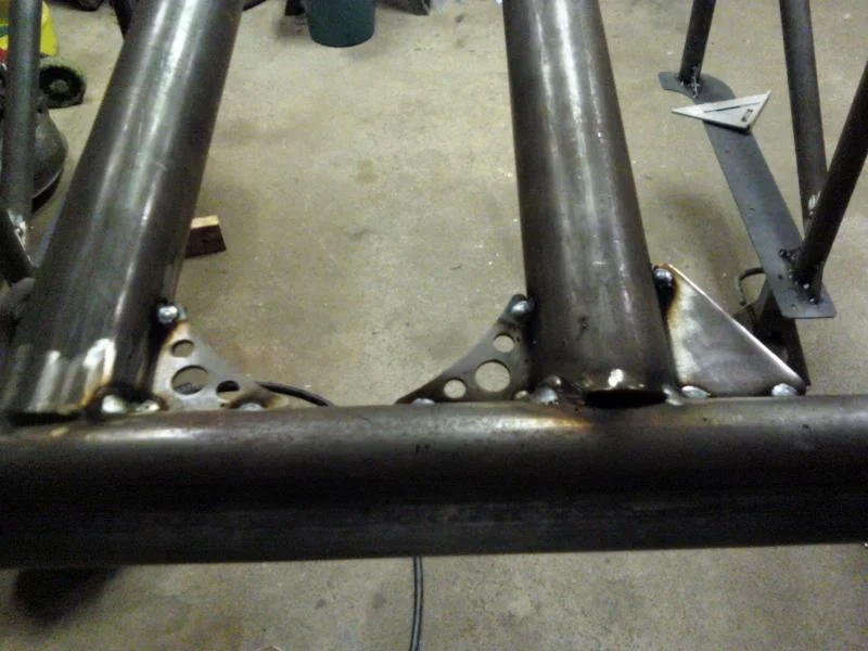

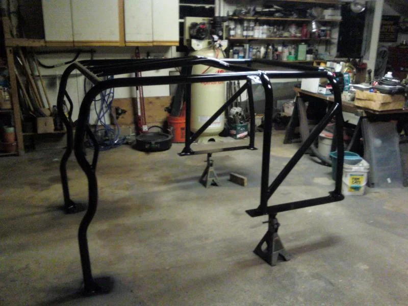

Loads of additional work left for the cage. On Sunday I was able to fit up and tack the rear diagonal supports, as well as a whole crap load of gussets. I think I counted 26 gussets. Most of the gussets are 1.5 x 2 inch triangles at 1/4 thick mild steel...very stout. I also added some gussets with punched holes for attachment points...figuring at some point I would need tie down areas in the bed. I added a bit of spider gusset bling near the door....couldn't help myself.
Metaltech designed a diagonal support near the door opening, which I will not use. I just don't like the look. I figure I have over compensated with the additional gussets and will be fine.
I still need to clean all the joints with a flap wheel, splash some prep-all degreaser, and then do final welding.
For paint I am thinking about buying some SEM etching rust inhibitor rattle cans....its a nice product and pretty hard paint.

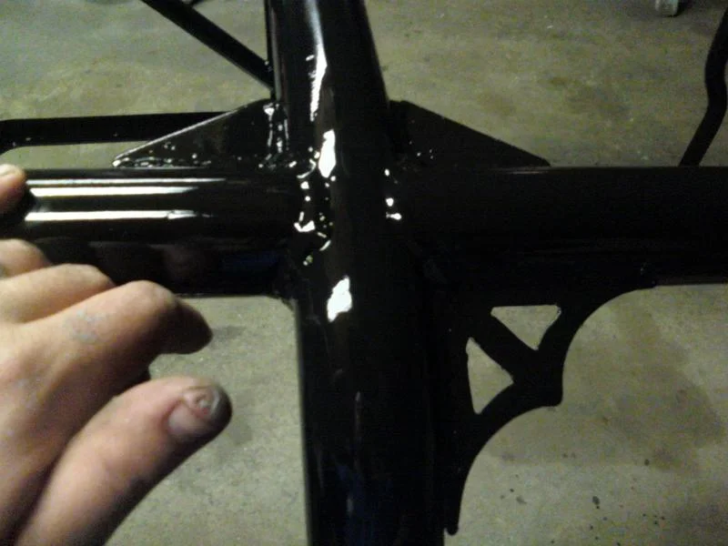

welded up and painted. 2 cans of 15 oz industrial rustoleum primer...+ 2 cans of 15 oz industrial rustoleum glossy black....
Wifey helped me load up the cage tonight...surprised the hell out of me.

Thanks for the nods on the roll cage. It looks good with camera phone pics....
Huge props to Dan and Mike for their assistance. I wouldn't recommend doing this by yourself for the first time.

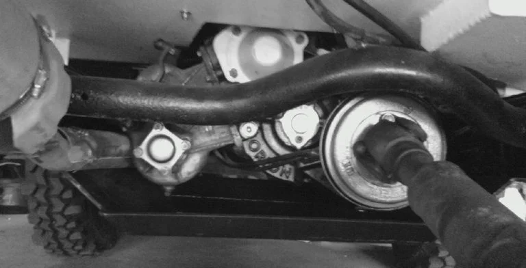

I got my IPOR skidplate in the mail a few weeks back. Lance and his Vermont born fabricator named Jack worked some magic with the plate steel. Since I am running a PTO his crew modified an existing skidplate for me, based on a sketchy drawing I sent them. It fits up perfectly. I did go ahead and add an additional 4 inch plate to the front of the skid, which is visible in the picture. I also drilled a drain hole. Essentially it is a basin under the tcase, pto, and tranny....no need to make it a pond.
Kudos to the IPOR shop.... (try lance@ironpigoffroad.com with questions about their products)

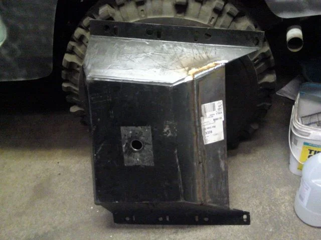

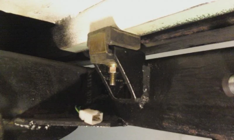

I also fabricated some rear body tub mounts and finished mounting the tub. There are two mounts that attach the tub to the rear crossmember, my new bumper.

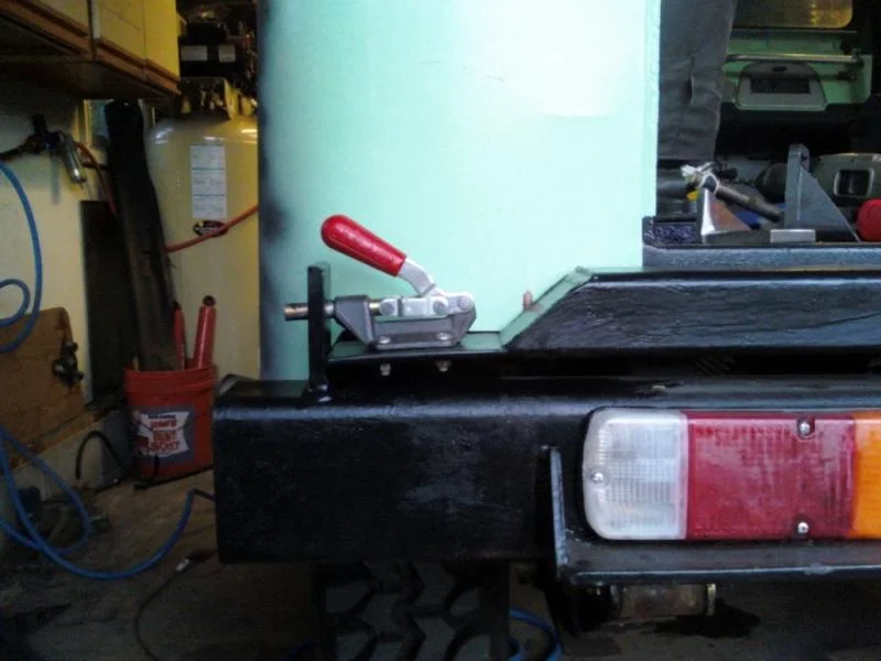

Finally, I think I am all done with the latching mechanism for my swing out tire carrier. I will post a picture shortly, but essentially used a Destaco clamp, and a piece of 5/16. It is a simple system, but should work fine for holding the swing out in place.

pics of the tub bracket and swing out below
