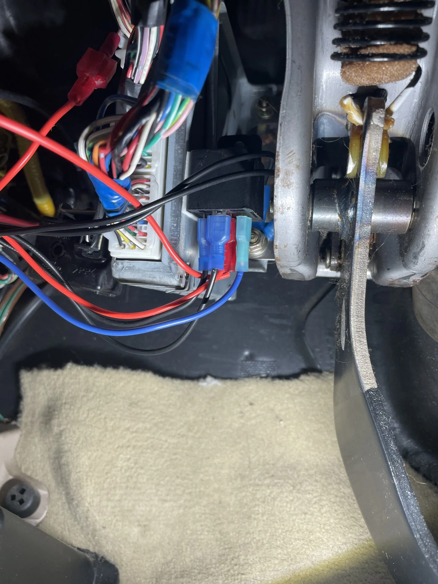

Finally got around to doing this.
Big thanks to both @LostAfrican for the relay wiring diagram and help and @aedgington for selling me his LX last year! Of course thanks to @Odyseuss for starting this thread.

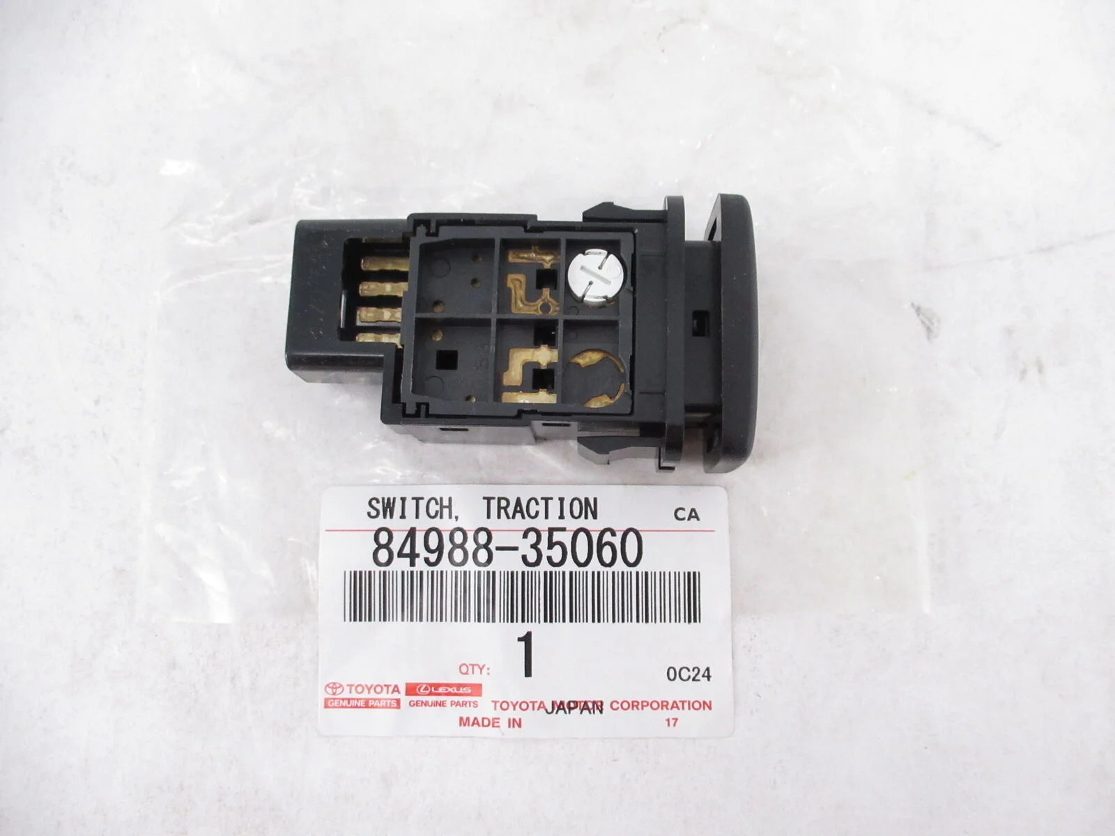

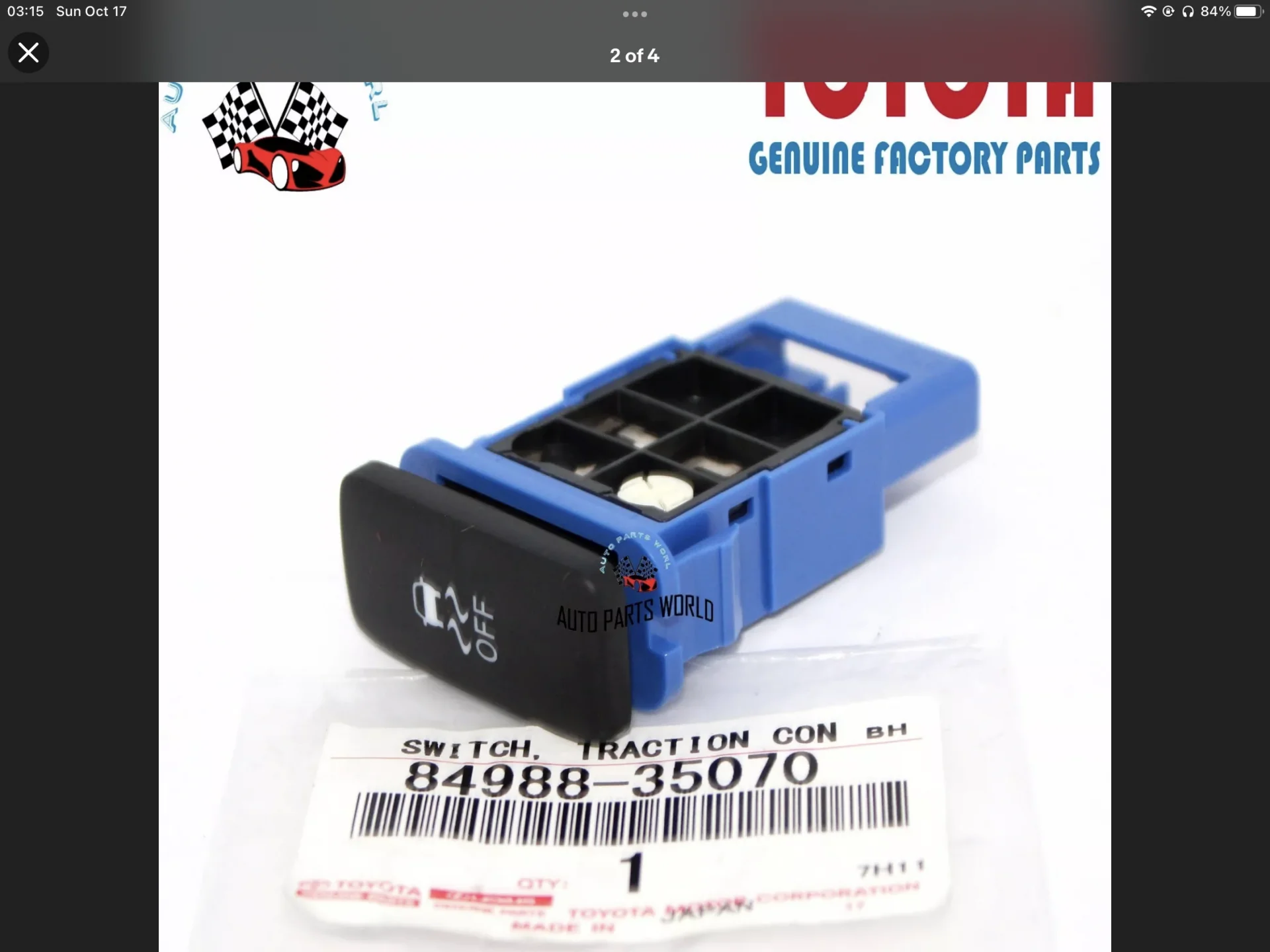

I used @LostAfrican 's relay method and wired it up to a switch that I made using parts from a 4Runner/FJ A-Trac Switch and VSC Switch. The A-Trac Switch is a non-momentary switch so I used its internals but used the VSC switch button and housing because the housing had the same type of connector that was already present (and unused) behind the switch panel to the left of the steering wheel. Originally, I purchased only the VSC switch had attempted to convert it from a momentary switch to a non-momentary switch however I did not have luck in doing so. YMMV, and the instructions to convert it are below:
I'm really happy with the end product, its exactly how I wanted it to look and work. The only caveat being the filter on the VSC light is orange and not green like the rest of my dash buttons. Hopefully I can find a green filter soon!
VSC Switch 84988-35070
A-Trac Switch 84988-35060
5-pin Dorman relay attached to side of the ABS, BA, VSC, TRAC ECU
Finished product!

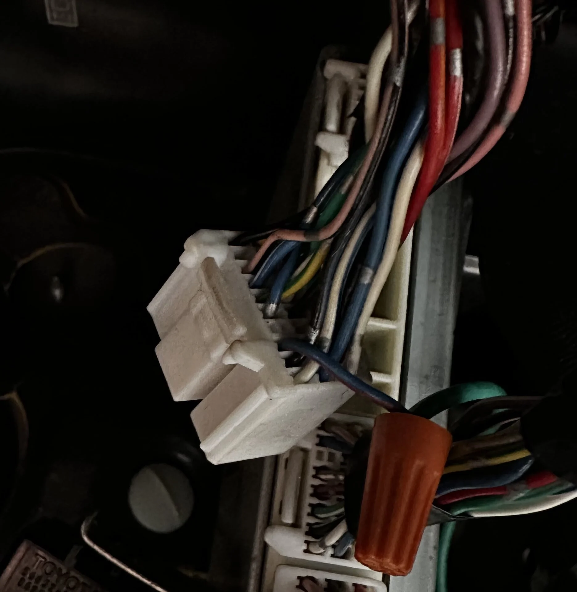

So, I did this today on my 01 Land Cruiser and I’m not 100% sure I did it right.
Found A43, found pin 3 (which was a different color for me, but the pink/gray/black was present in a different location). Connected pin 3 to ground. Started it up and no VSC OFF light.
VSC off didn’t illuminate on startup (does it usually, I’m unsure now). Anyway, here’s a pic. You can see the pink/gray/black stripe on the other end opposite from pin 3).
I haven’t taken it for a drive to see if VSC will act up, but the lack of VSC OFF makes me think I could’ve screwed it up.
