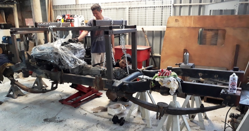

Then the bonus - they have got the engine and gearbox hanging there in position with just the 4x4 lever to remove so it can be positioned properly in the chassis and the new mounting points made up.

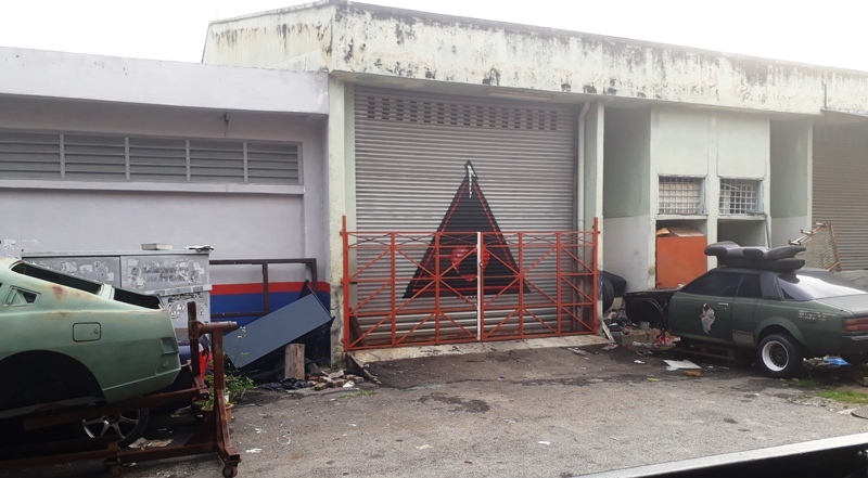

Went down to the cabin shop and surprise he was open and not one bit of progress has been made on the cabin except they say the cabin cross member is ready for collection from the laster cutting shop - so why have the not collected it - oh we were closed all last week. Crikey!!!!!!!. Another customer was there pulling his kit out he is in our watch this workshop group.
Due to my current health state I have left the cabin there to be worked on with the threat no weekly visible progrss via pictures it comes out, including him not sending pictures as that means no progress. Next update due is this Saturday.
Another member of our watch this workshop group is on the warpath on FB and letting loose with his opinions lol.
This panel restoration shop is putting itself out of business the biggest customer just left with his huge deposit spent by the workshop with no work performed and others are spreading the bad service word. He is the only one who can take court action as our amounts are not considered courtable *^* sigh - Mine is the last paying cutomer left and that is only on a week by week basis.

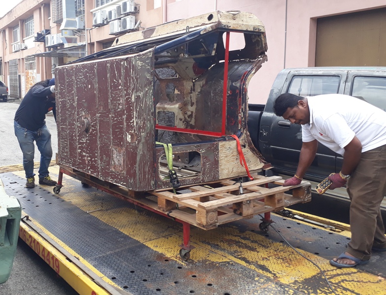

Meantime we load it into the tow truck and the last paying customer leaves the workshop. WIth no workers and all 4 current paying customers gone (still owed their deposits etc) and future customers being wanred off on FB the future looks bleak.
Finally 3.30pm its unloaded at the Chassis shop

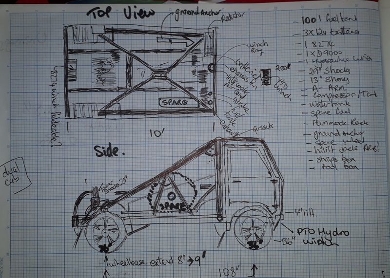

I have been doodling away on the design of Volvo 2 and its looking like this, now I need to get this onto a proper scale drawing.
Crikey it's a struggle just to walk back and forth to the desk to write down the measurements the heart goes nuts.

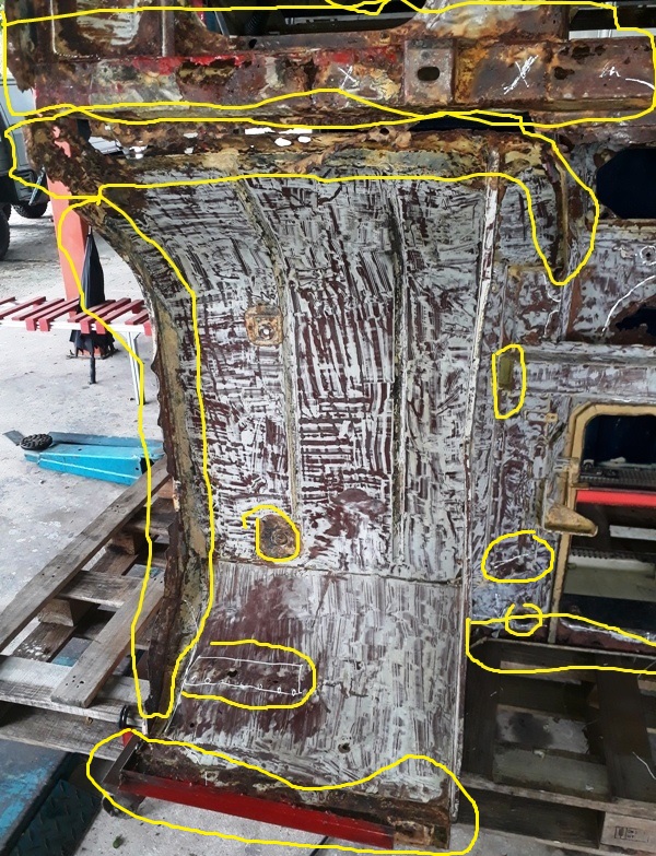

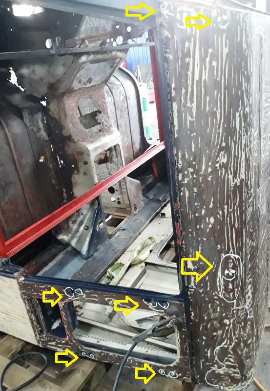

Once the measurements are taken it's time for a really close inspection of the cabin in the bright light.
There are 31 separate areas on the top half which need attention either a dolly hammer or just welding up holes all of which can be fixed up quite easily just time will be 3-4 days.A couple of area need cutting out and new pieces welded in,, We can get these laser cut before hand and just weld them in.
Then there is the cabin bottom. its a lot worse than I thought we go through marking issues areas. Andrew asks how much for a cabin from Sweden I tell him. He says buy it this will be constant draw up laser cut trial fit/bend then recut and oh more to cut and the wages cost will be huge.
So I contact Tatanka on FB they reply in less than 30 minutes. yes we still have the cabin we will get a shipping cost for you to Malaysia.
Left side of cabin areas marked for repair.
Middle of cabin areas marked for repair.
Right side of cabin areas marked for repair.

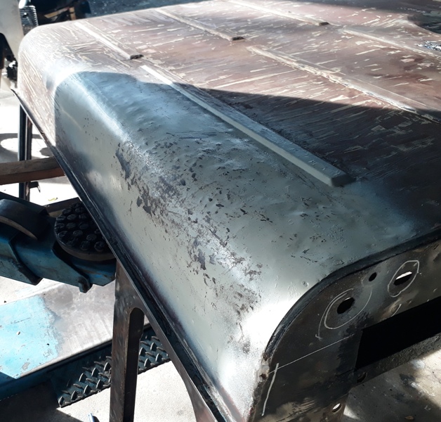

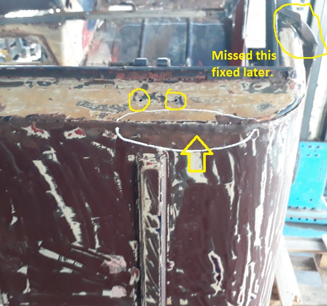

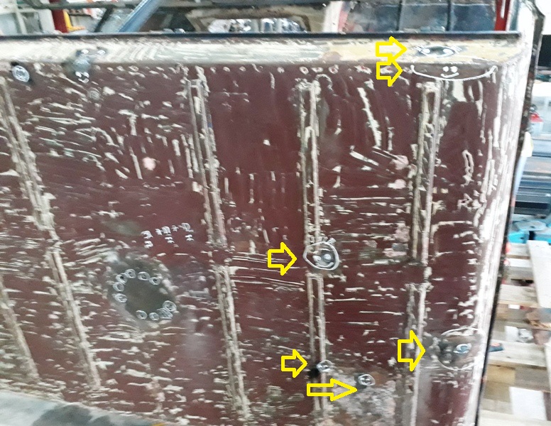

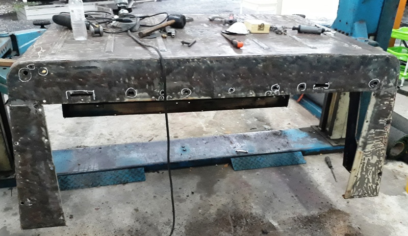

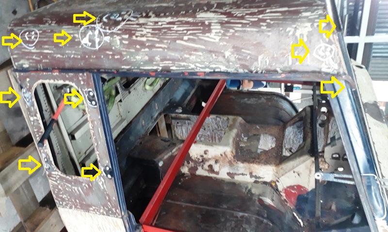

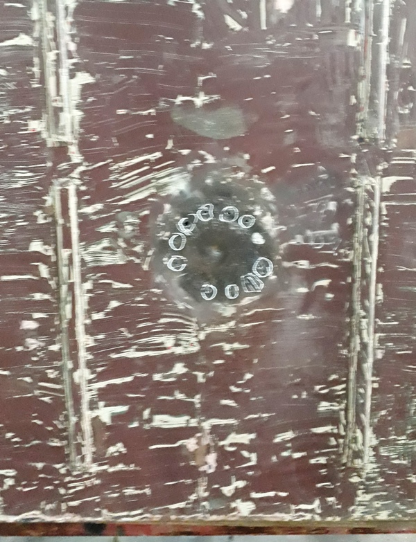

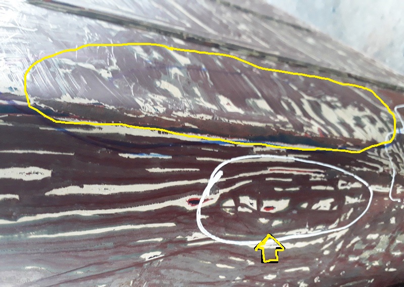

I decide before pictures of the white circles is needed there are 31 of them to repair. I'm given the bangladeshi worker to do the welding and I can do the dolly work.
Left side
Roof top
Right side
Only takes me 10 minutes to knock out 5 dents with the dolly hammer and the curved dolly.
Then I see several dents and issues I missed. They are marked for repair also.

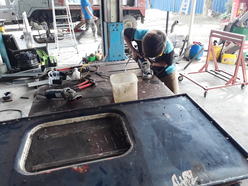

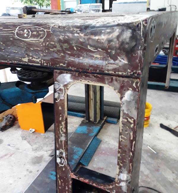

Rapidly we make progress each window has 8 bolt holes to be welded up. The TIG welder makes quick work as I prepare the holes for welding tap and sand etc.
All the smiley faces are repaired ares 2 holes filled or one. We find several pinholes and they are drilled until no more rust and a circle cut out and repaired also.

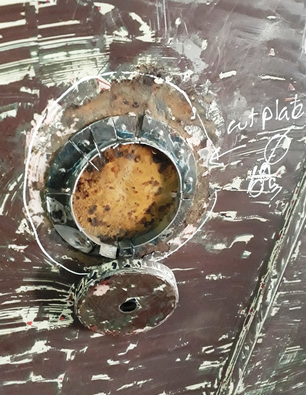

Then we decide to remove the spare tire carrier off the roof. Man i'm so happy I did its a rust haven. Now I need to get the IPOH shop to do same to Volvo 1.
One hour later I have it cut out in about 12 sections and wire brushed down. More work is needed to pull out the dent and fill the holes. I have also saved myself cutting a 8" plate and welding it in double bonus.

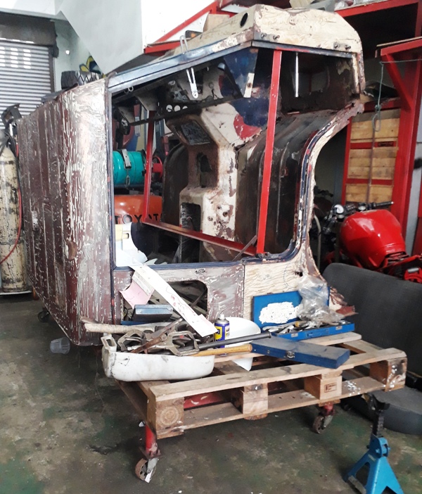

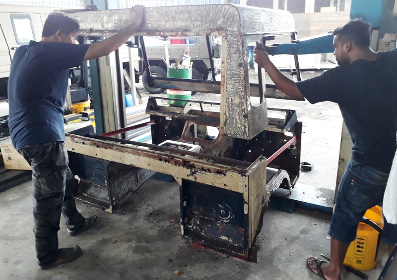

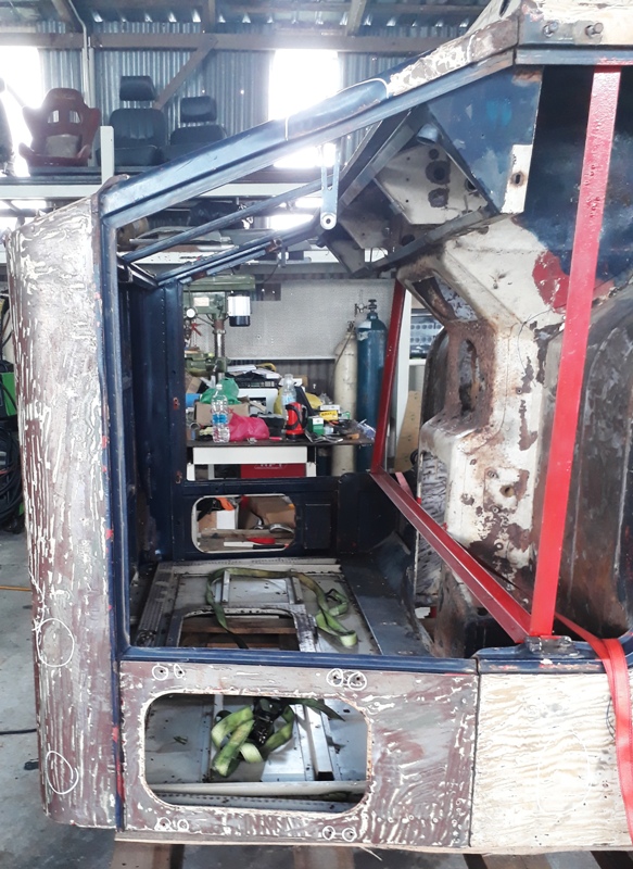

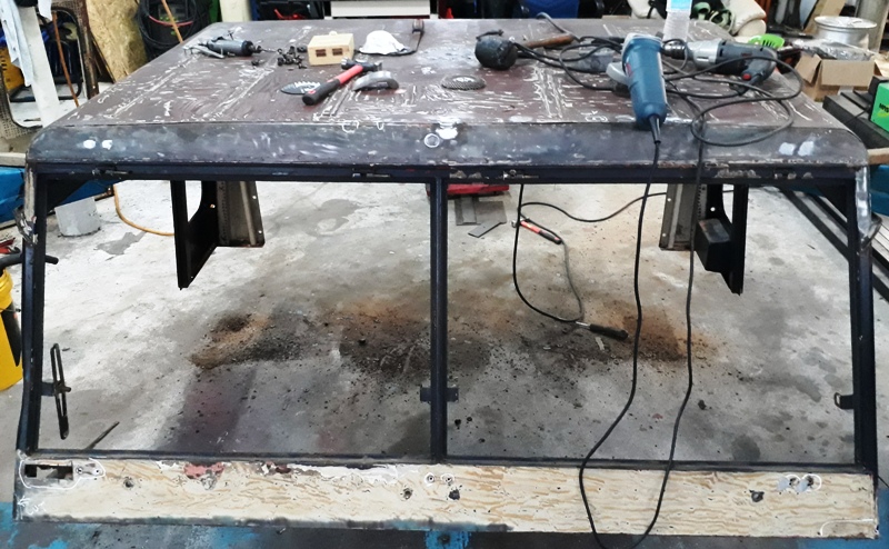

They help me split the cabin, remove the rear panel and leave me the top hanging on the car lift. Then it's all mine andI work my way around identifying more little rust holes to drill out and repair. I cut out sections of the front of which need replacing THey are going to make new pieces and weld up during the week. I am getting my Toyota mechanic to come assist us in reassembling the Volvo axles on the chassis so we can move the Volvo around the shop.
I wear a wire brush out cleaning the paint off. However, The damage caused by the "expert restoration" shop using a scrapper and a heat gun is immense deep gouges everywhere in the steel sigh.
Splitting the cabin was an engineering feat lol using the car lift.
The rear of the cabin needs a little work before its ready to paint.
The front not as bad as I thought only 2 areas cut out.
The rear panel I will tackle next trip it has about 4 areas needing cutting and replacing.

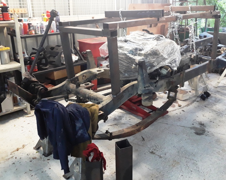

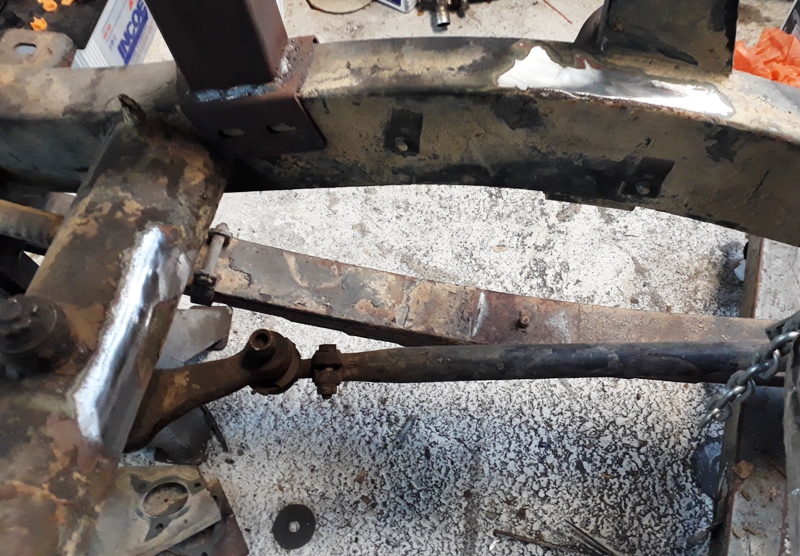

Early start at Volvo 2 workshop. First job finish cutting of the engine mount and make the 2 vaccum brackets welds I had cutof the chassis look like they had never been there no marks nothing to be seen by the vehicle inspectors.
3 hours later 2 of the 3 weld cleaning operations are done then I have to make way for the Volvo axle asssembler to start weaving his magic one of my friends offers to help him while I go play with the cabin top.

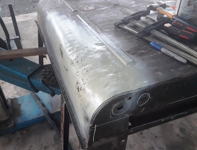

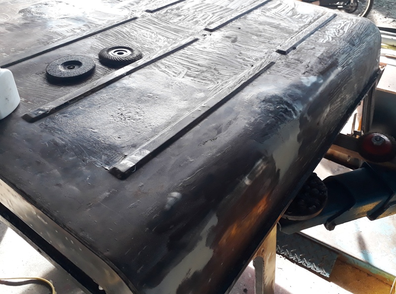

After 3 hours I finally have a lot of progress on the 4 dents/awful creases on the roof and it's starting to look factory again.
By 6;20pm and packup time it's really improved I still have one crease line to remove and then just concentrate on removing all the dents and finish putting the proper curve into the roofline. Next weekends work.
The Volvo portal assembly area we ended up not completing as we could not find the 2 locker cogs they have gone missing sigh.
The cleaned up vaccum brackets on the chassis.

Allen was there working on his Pinz. Only one thing to do tap the roof dents more. Then it was lunchtime at restaurant "Silly Billys" how apt.After lunch they started welding up the holes in the cabin but the welds were not sticking on the back panel due to the rust content. So we marked the strip covered by the channel and I cut it out. We are going to weld a new complete rear panel on after I clean the rust up with PYE.
Then it was back to the roof tapping until 5.30pm its starting to look ok 3-4 more hours and the roof might be finished and shaped and smooth.

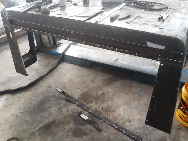

We discussed how to fix the rear panel I might have to make pieces by hand to weld in.
The rear panel after I perform the surgeons cut.
The roof damage is slowly being pushed back to the factory standard.

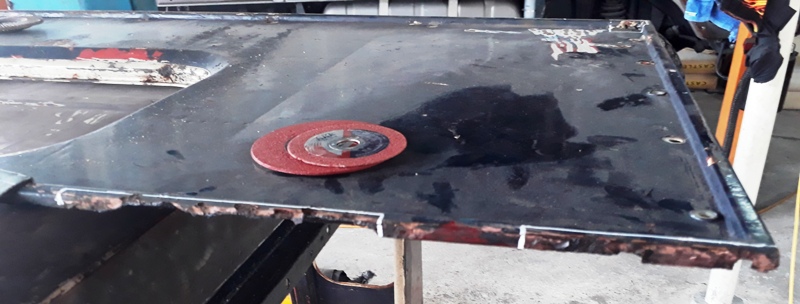

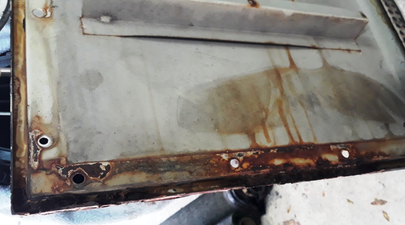

Jim your next challenge is to remove all the rust from the bolt on rear panel by 30 JUne else it will rust away. This tape will self desctruct in 5 seconds lol.
More rear bolt on panel damage.

I tap away on the cabin for over 2 hours and it's pretty straight now by the bit I have tapped out is out 1mm more than I need for it to be flush all the way along. The right side is flush. I will try and fix it next weekend some more with a small amount of heat.

Then I tip the cabin over and applied the PYE rust converted 2 layers into the cut made last week and cleanup all the welds by flapper wheeling them flush.
Every other old rust scars are PYE treated the same to prevent the rust coming back. I'm told the new rear panels will be here next week to weld on.

I have help today little Joe from the kids home wants to spend the day with Grandpa and he is good help. His job wire brush the rest of the roof for me while I tap more of the big roof dent then start on the rear panel repairs.

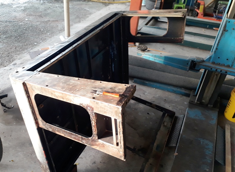

Mark then cut and make a new piece
Wire brush
Weld in and wait and repeat the exercise 8 times more. 4 done 4 to go.
A corner piece is really quite trickey to do so it needs a second go.

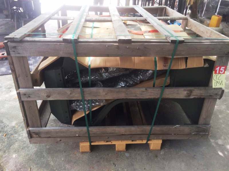

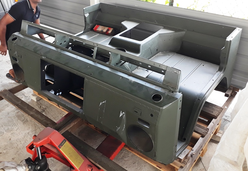

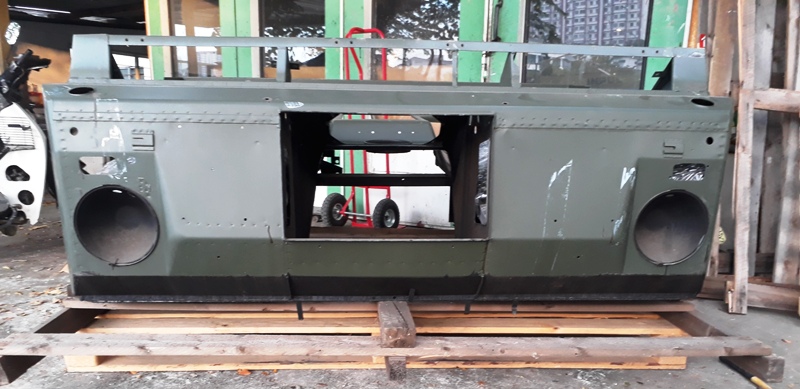

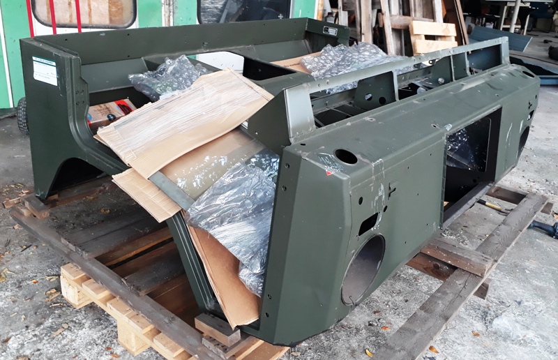

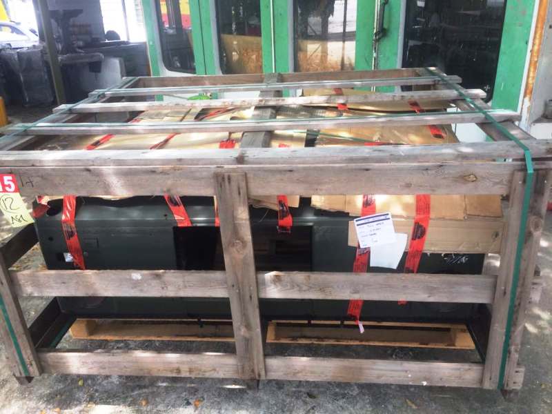

However meantime the freight company contacts me 12th July the Container arrives and delivery will be around 17th July.
The 13th 2pm I get a OCS message with pics on it the Cabin bottom has been delivered to the workshop. Wow less than 24 hours in dock and it's delivered.
I pop over after work and spend 90 minutes pulling the crate apart. The cabin looks immaculate.
Then Saturday I popped in and we move the cabin to the newly built Volvo 2 bay in the workshop
Any illussions on whether I should have bought the cabin are squashed by this pic.
