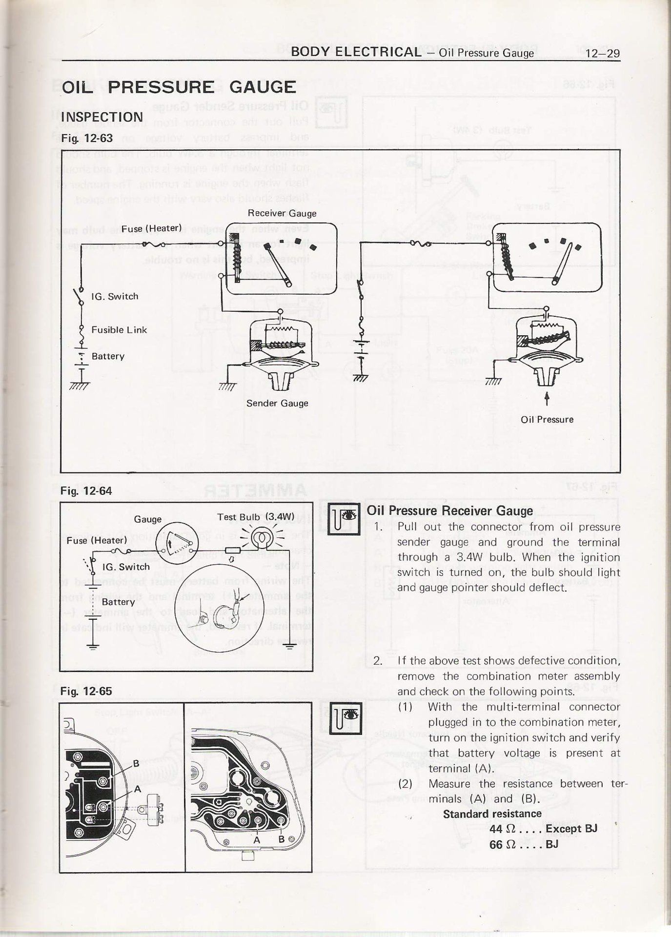

Follow the FSM:
Rudi
Thank you Rudi, positive to the bulb, negative from the bulb to the sender. Now to find a 3.4 watt bulb. I think I have some from the old '70 that I bought and never needed to use. I will check that tomorrow.

I think my brain was getting in my way. I was confusing 3.4W with 3.4V and thinking the terminal of the sender was providing the resistance. I mean, a tail light bulb would do the same thing, wouldn't it? Maybe just not as bright?
The bulb acts as a sender or as a gauge, depends on the test. A 5W bulb will do.
The bulb I had set up for testing is an old dash board bulb. I can read the 3 but not anything after that. Connected to the battery terminals it is bright. Connected to the oil sender, key on, no light. Start engine and the bulb is very dim, just barely glowing. Increase engine rpm, no change in the dim bulb.
