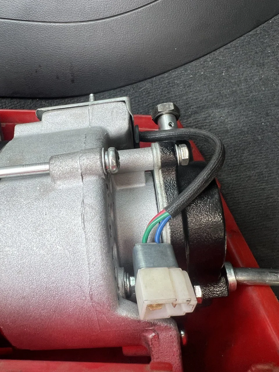

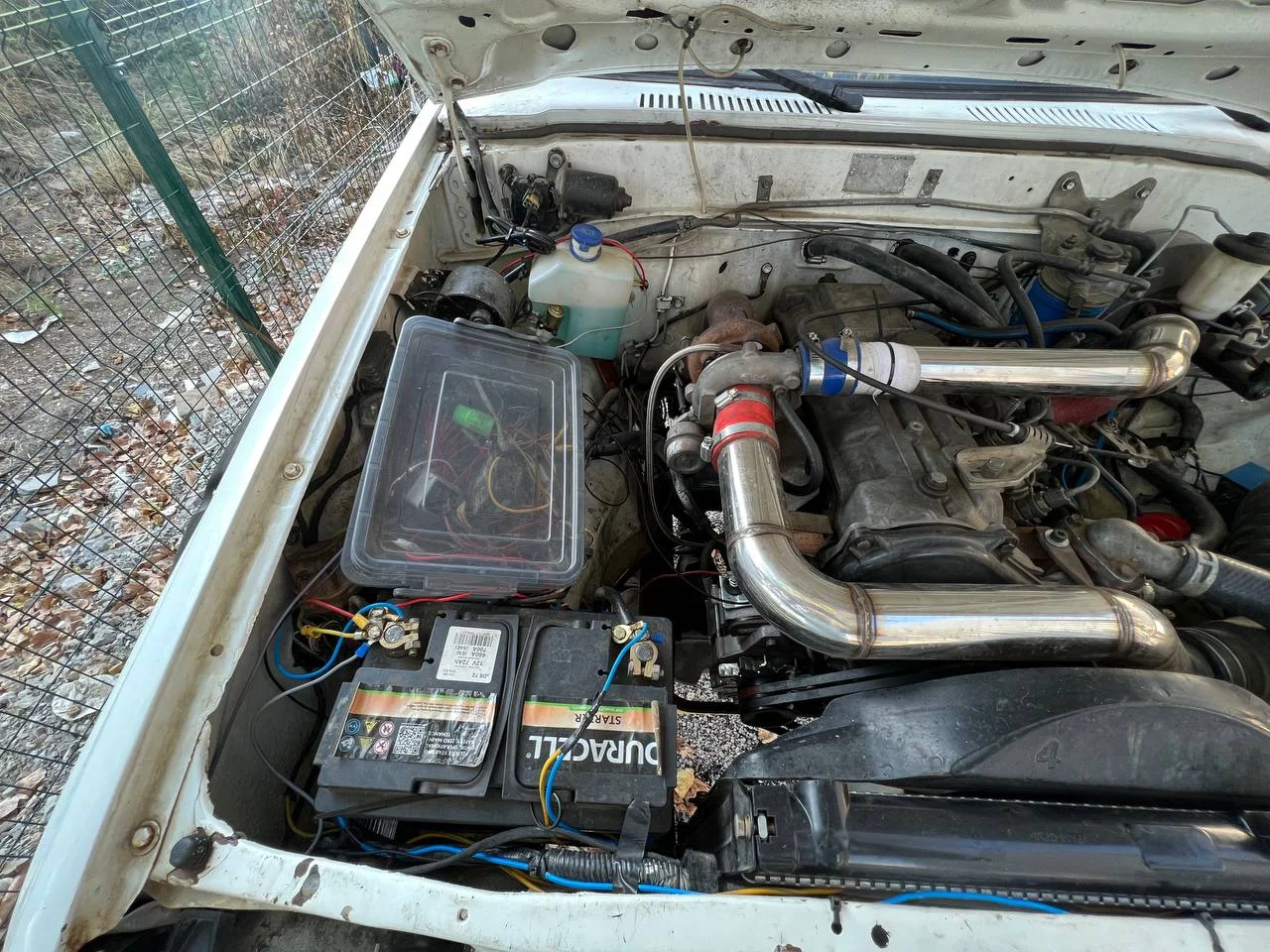

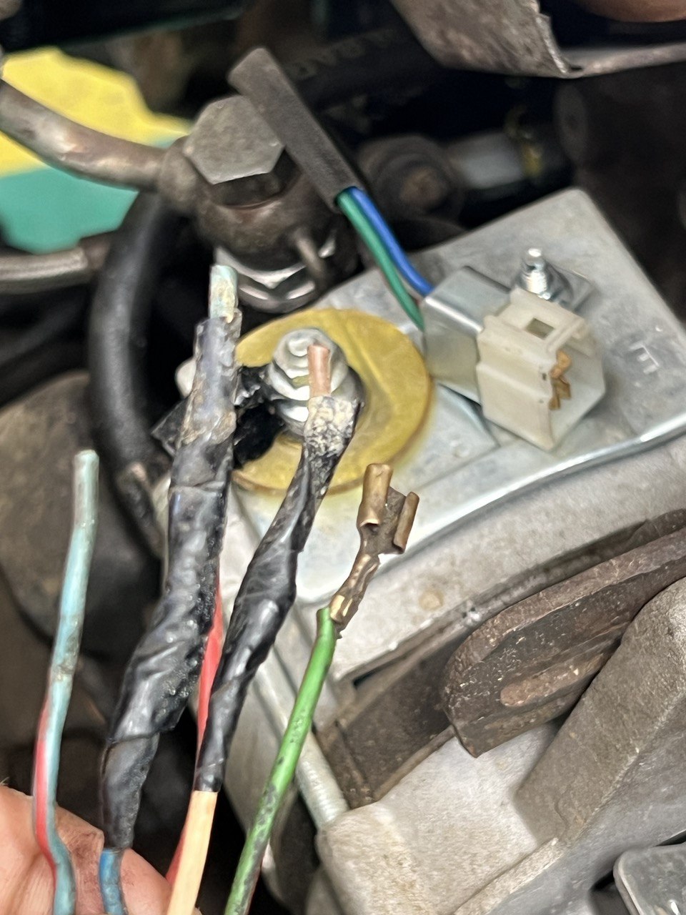

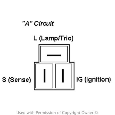

Reading 13 pages and I'm lost, can anyone help wiring my brand new 55amp alternator w pump , 1986 crewcab 2L diesel. PO tried to do something but the alt was never working. I wired my alt 3 plugs accordingly to this
and the Sense wire being connected to battery+ started arcing and I read 3-4 DC amps regardless the engine is running or ign is on. I'm 99% sure the above picture is not how mine should be wired. Also FYI I never wired the top Lamp connector as I don't think I have an alt lamp on my dash (w o tach)

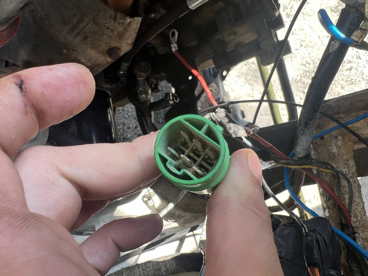

On one side there is a circular green 6pin plug that goes somewhere but connects nowhere atm; red, white, blue, black, yellow and green.
Under the hood there also is another set of unkown stripped wires, the green wire with the connector is actually Yellow-Black cut at the loom.

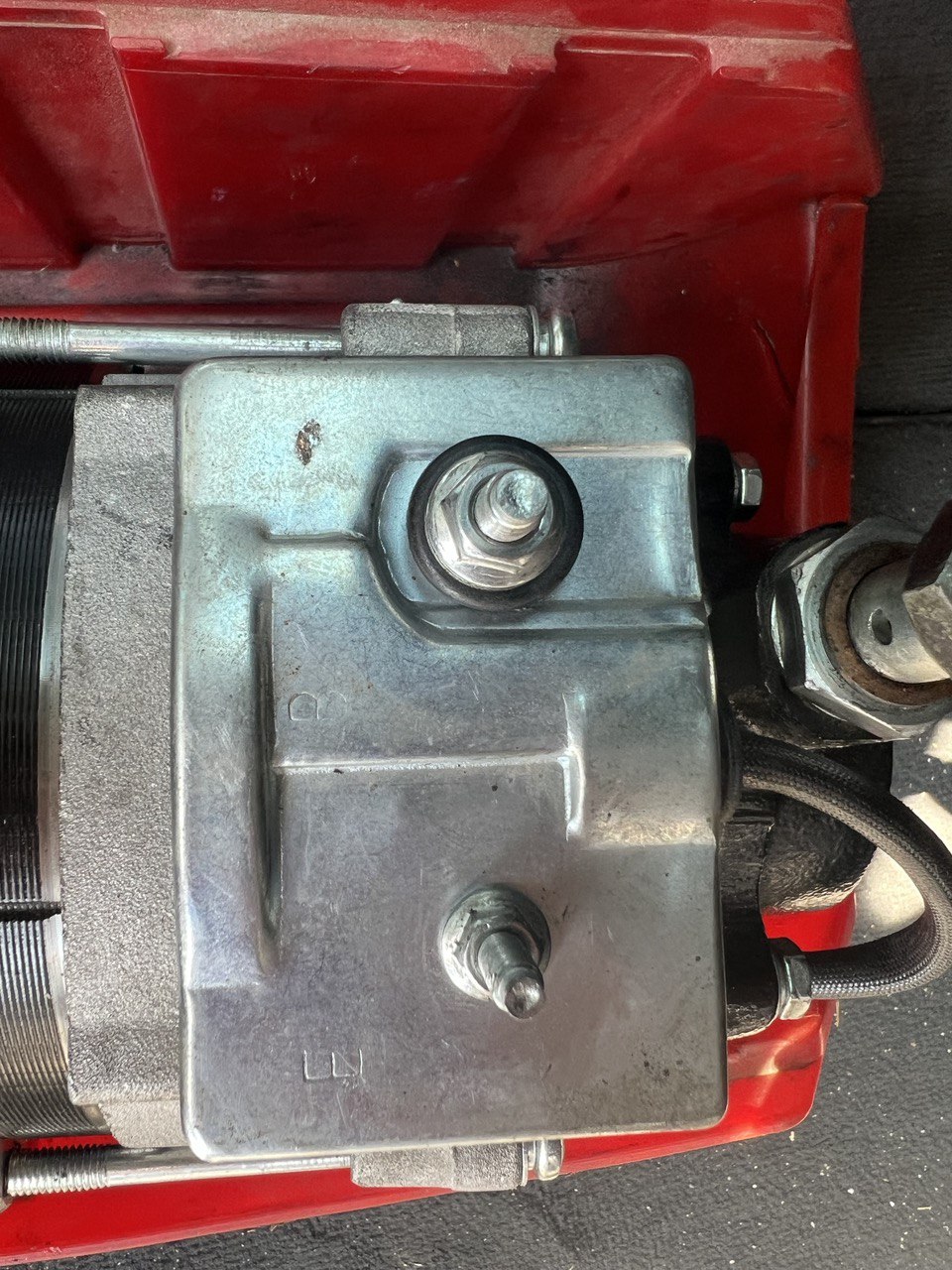

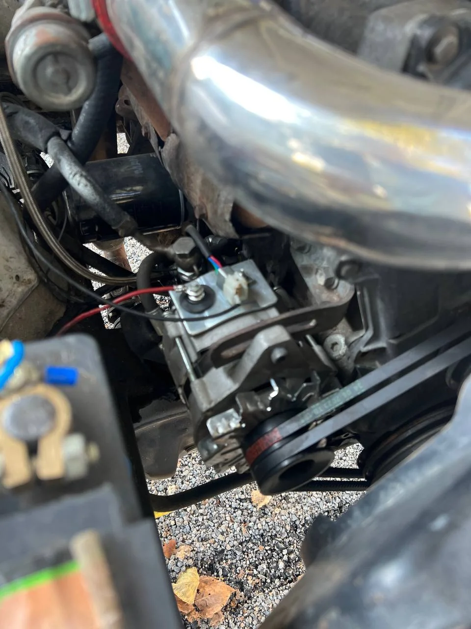

Aand here is the alt: Remark ALT962 is the model name, the one thing I didn't understand is the seller said its plug n play and don't need an external voltage regulator, I can measure/ check cont. and do all testing but I certainly lack knowledge of this electrical wizardry.

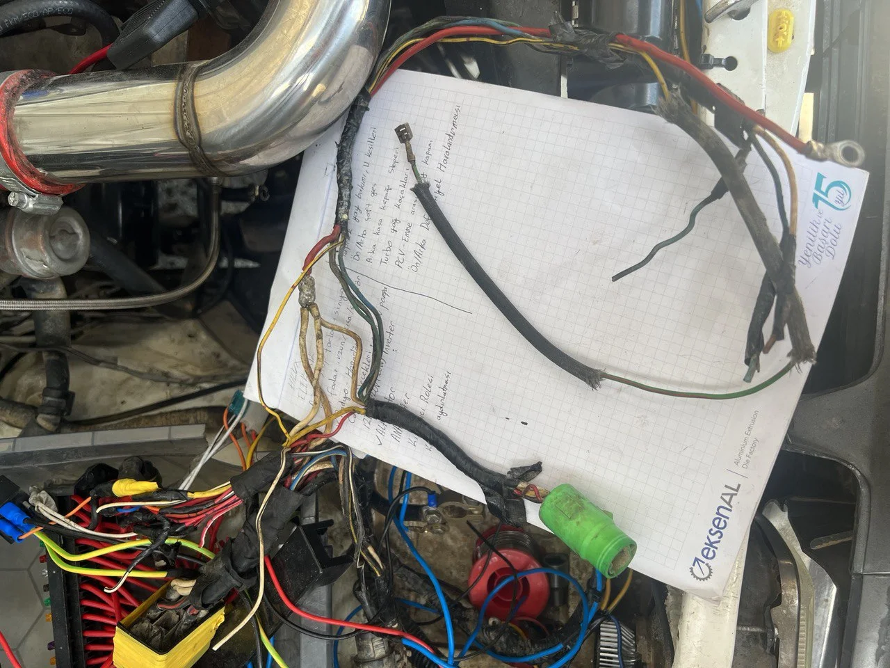

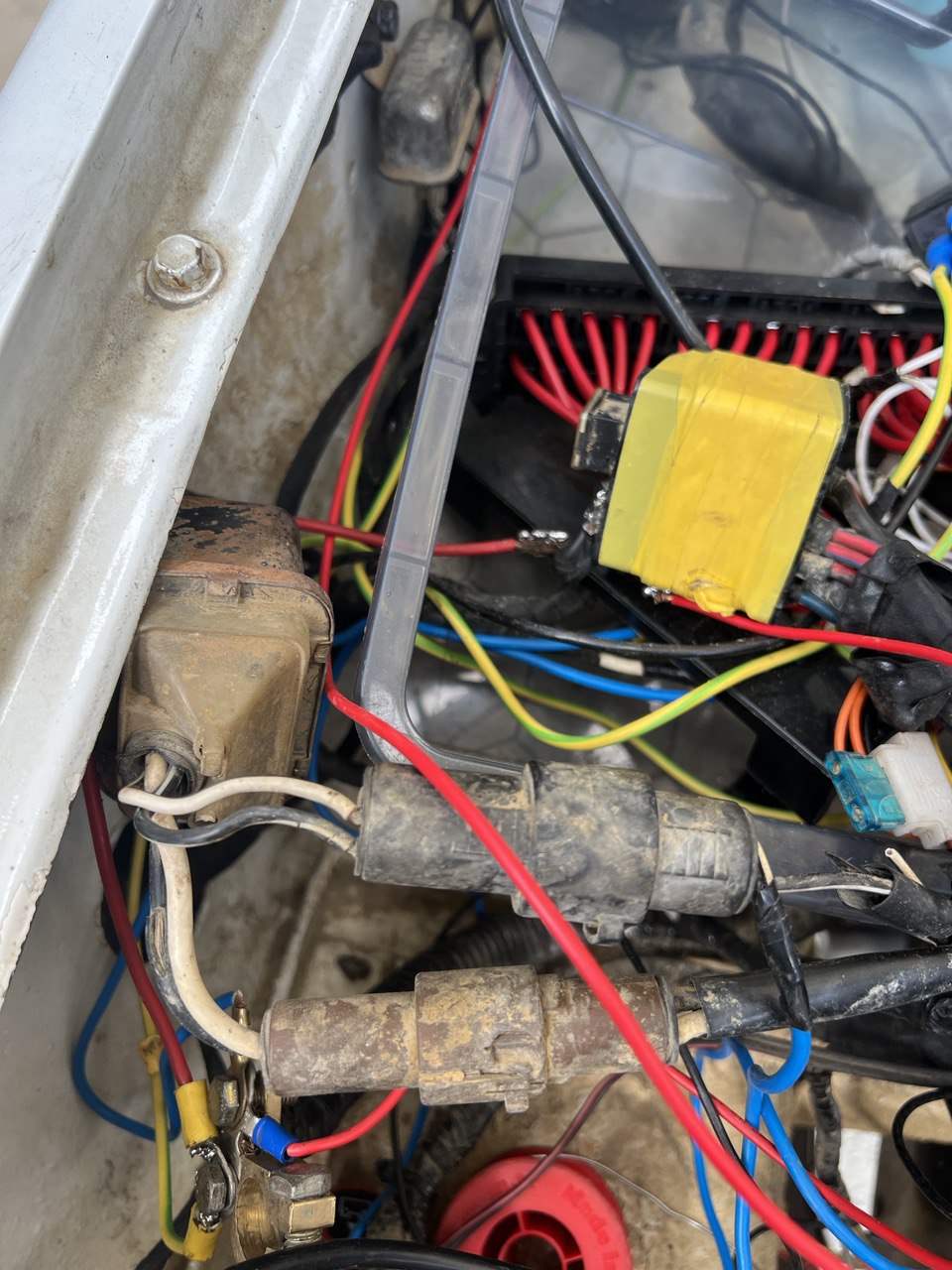

this green round 6pin male connector your holding , .....

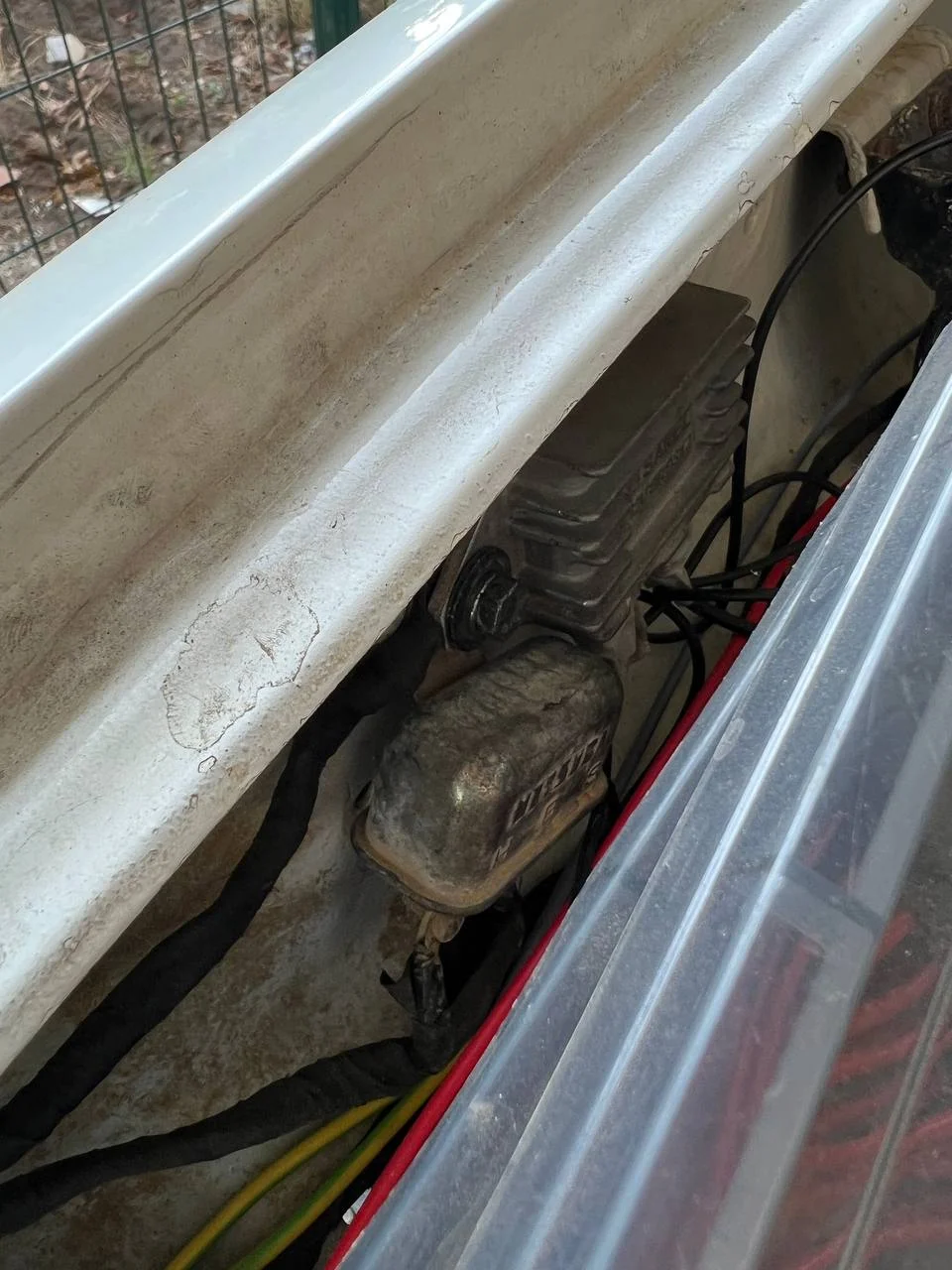

isn't this attached to your current remotely mounted voltage regulator on your fire wall or inner fender ?
the black square box with 2 feet on it ....

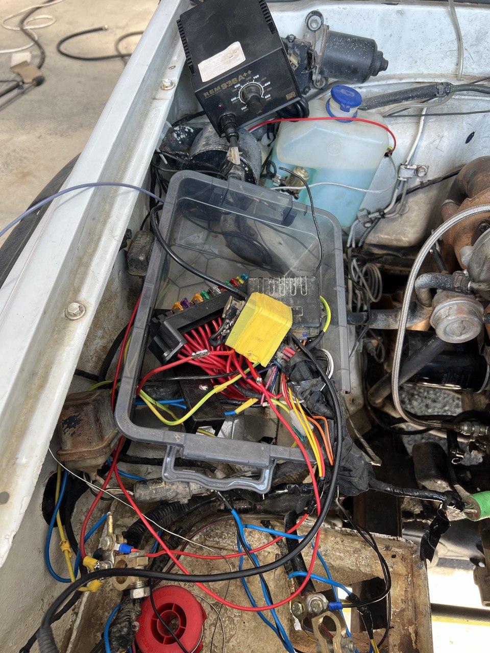

View attachment 3709434View attachment 3709435Do you mean the brown rusty box with 4 connections coming from bottom? or the smaller box nudged between the tupperware and fender?

your old alternator has
GREEN 3pin plugs on it right , that are shaped differently from the white one on the new alternator in your photos above ?
or
is it a black 3pin plug set up ?
or

The previous alt and new one is exactly the same besides the 3pin plug color was BLACK on old one, the plug size/type is same.

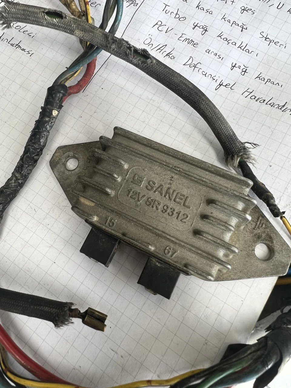

I think(!) that blue-white wire from the old alt wiring was going to a small box written 12V which I can assume now is a voltage regulator or some sort? I'm thinking the alt seller doesn't know what he has and this alt does need the external VR.
And the green wire with the connector I mentioned goes thru the loom all the way to battery + terminal. Which leads me to believe the green connector(battery+) end goes to the presumably voltage regulator box with 12V written on top. RIGHT??:bang:
BTW I'm super thankful to you ToyotaMatt! I feel we are making progress and some things start to make sense! Only if the P O burned the truck down and doing it from scratch would've been easier.
EDIT: Whoops, I was wrong about the green wire. It turns into a yellow-black wire which leads through a thick harness that goes into the left side fender and to somewhere in the cab, yet I couldn't see a yellow-black wire anywhere near the ignition switch nor the combination switches. I'm guessing that it leads to ignition switch with a different colored wire. Or perhaps it might be the alternator light that leads to the inst. cluster?
Tomorow I will fix the shorts and fix previously cut cables and attach the battery to see if I get a reading with ignition ON/OFF from the green wire (yellow-black)
Got it working, the VR acts a bit lazy but starts to charge the battery at 12.1 Volts and keeps it around 12.1-12.5V.
Green wire from alt goes to no.67 on contact of VR, Ignition (I wired to a unused switch inside my control panel because my ign barrel is not 100% functioning) wire goes to no.15 contact of VR and grounding is done via VR casing.
