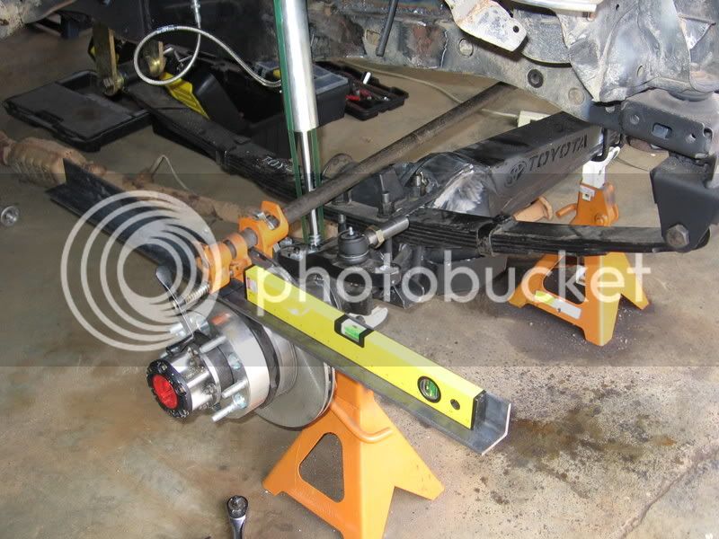

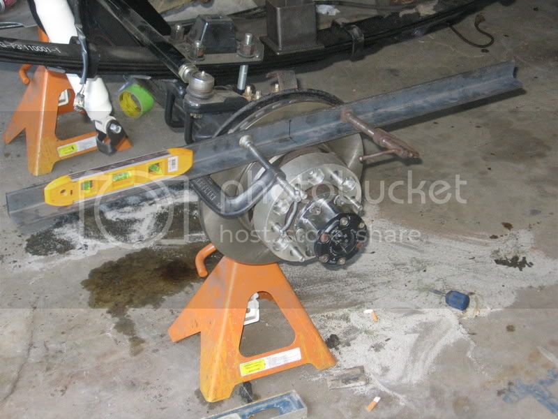

I find it hard to measure accurately with knobby tires so I do this....
I can drive 80 mph with no hands on the wheel completely straight. It works very well!

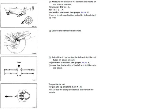

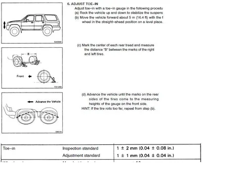

:steer:Here's the method from the 1990 FSM:
If you don't have access to those tools, it can be done with a tape measure. A way to mark the tires is to jack up the front end, use white spray paint to mark a line around the center of the tread, then a tool (screwdriver, scribe, etc.) to make a fine line in the center of the paint before it dries. Lower the vehicle and jounce :bounce2: the suspension to settle it. Measure the difference between front and rear of the tires (top view /____\) at the center point (side view -O- ). Then :wrench: away!
