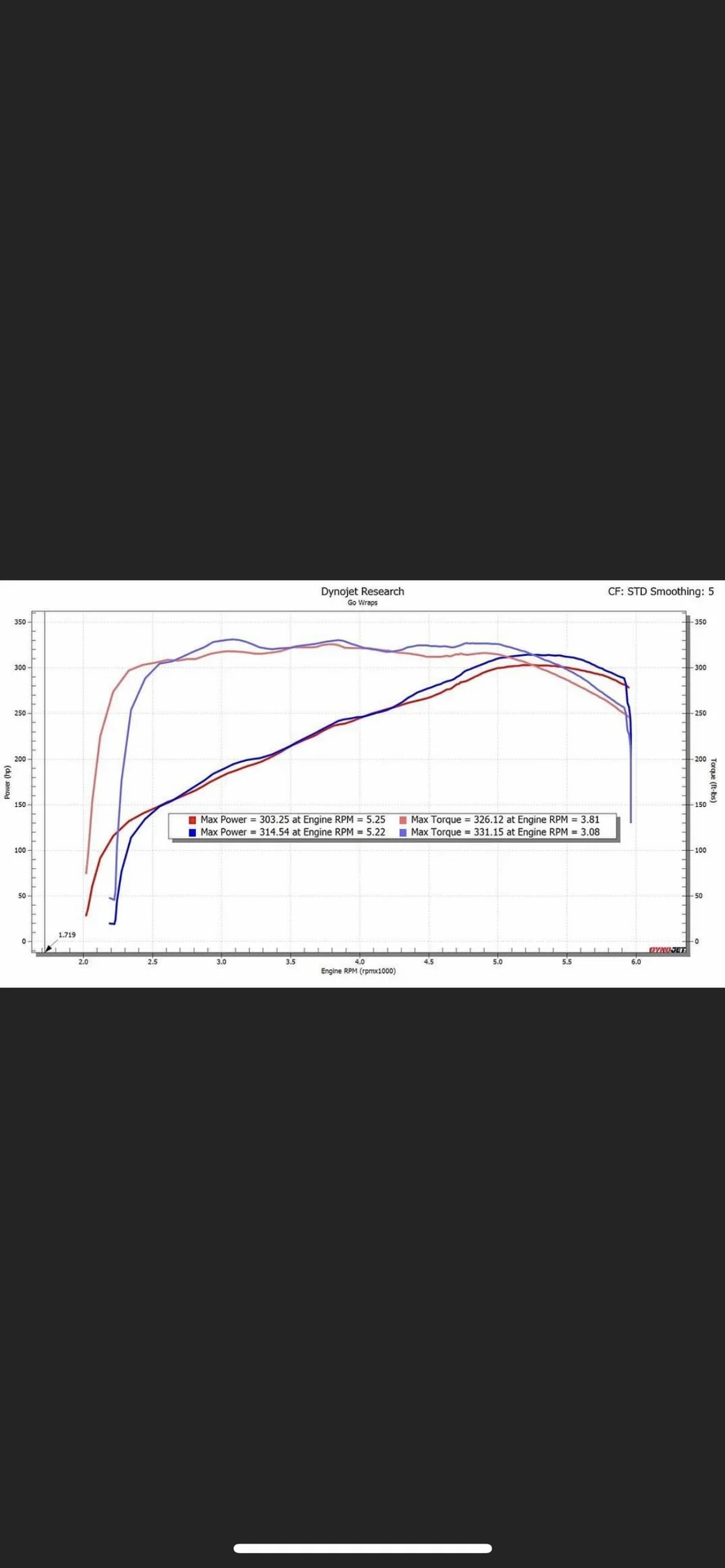

Just wanted to pass along that I have confirmed it is possible and being done. If this is common knowledge, it's news to me. You can use Techstream under "health check" or a Snap-on OBDII scan tool to pull the ECU calibration ID # which is what’s needed to rewrite a custom file.

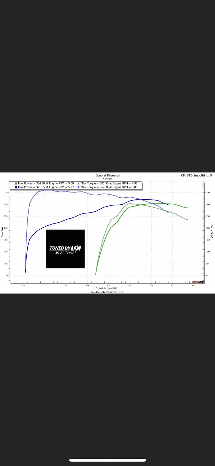

Here are some maps of NA Tundra's and possibly an IS350-not sure. The big gains are the power coming in much sooner in the power band. Torque came in 800+rpm sooner on a naturally aspirated truck on the dyno. Also seems to have fixed the trans hunting for gears for those who have that issue. I'll report back once I have a custom tune written and installed with my impressions on my supercharged LX.

Yes sir, the trans is tunable as well. If you are NA as I understand it this tuner is able to rewrite ECU and TCU maps remotely.
Since I have a SC I need an in person dyno tune. Check him out on FB, IG, YouTube. He is based in Des Moines, but travels to Fremont, CA and Houston and works with shops to tune there. Look up @tunedbyloi.
