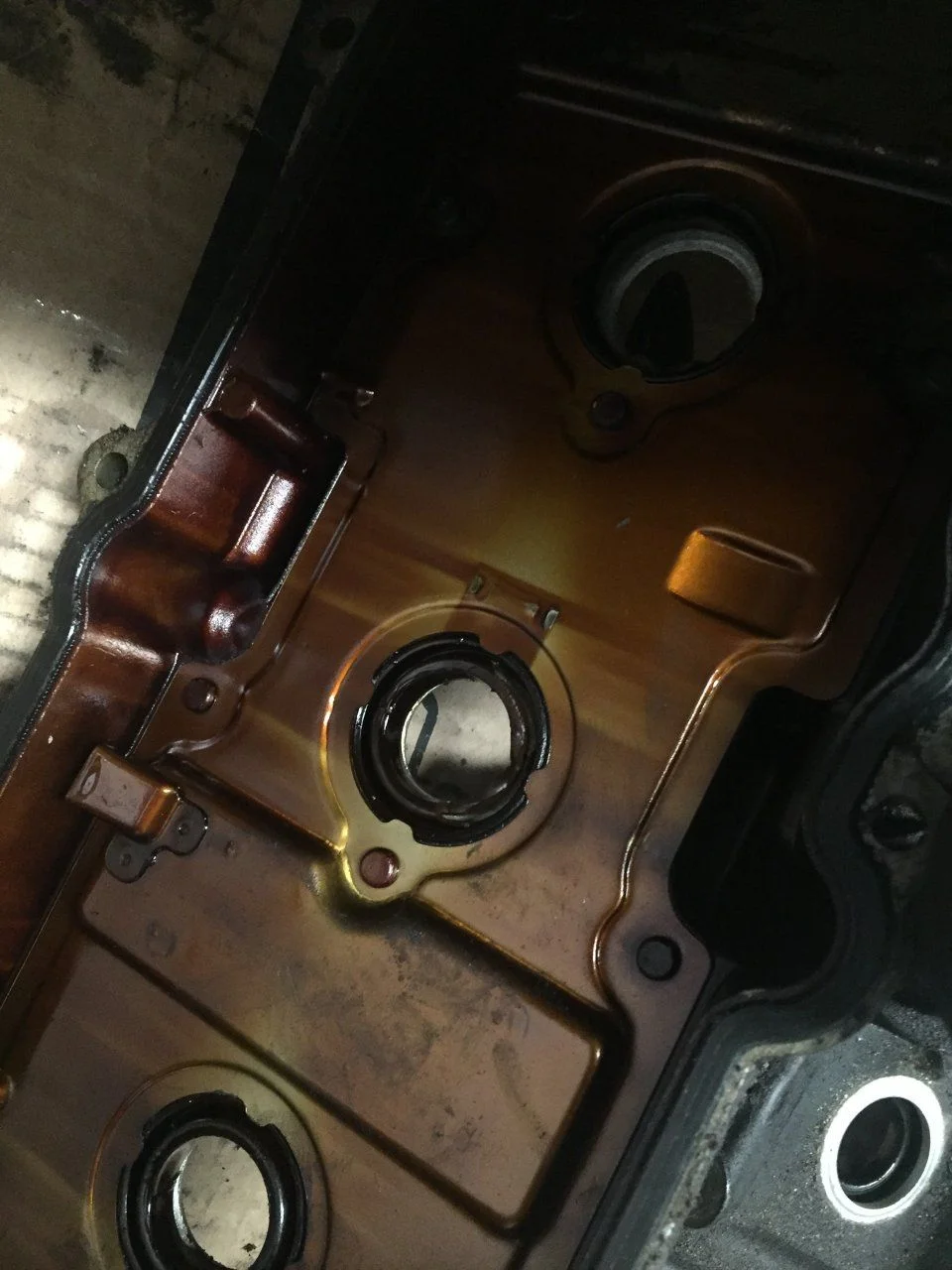

Any one have an idea on how to replace the tube seals? I am doing my timing belt and also replacing my valve cover gaskets and the tube seals on the PS are cracked. I read about removing the rivets but to much work. the seals have like a metal notch holding them in I wonder if bending them out of the way would help to get them out. In the 80 series its quite simple.
The FSM gives very specific torque spec and procedures' for doing head cover gaskets and spark plug tube gaskets. I'd not attempted the job without a FSM. FSM state to bend the 4 ventilation case claws (tabs) holding in the plug tube gasket up 90* or more. Some have just dug out without bending.
