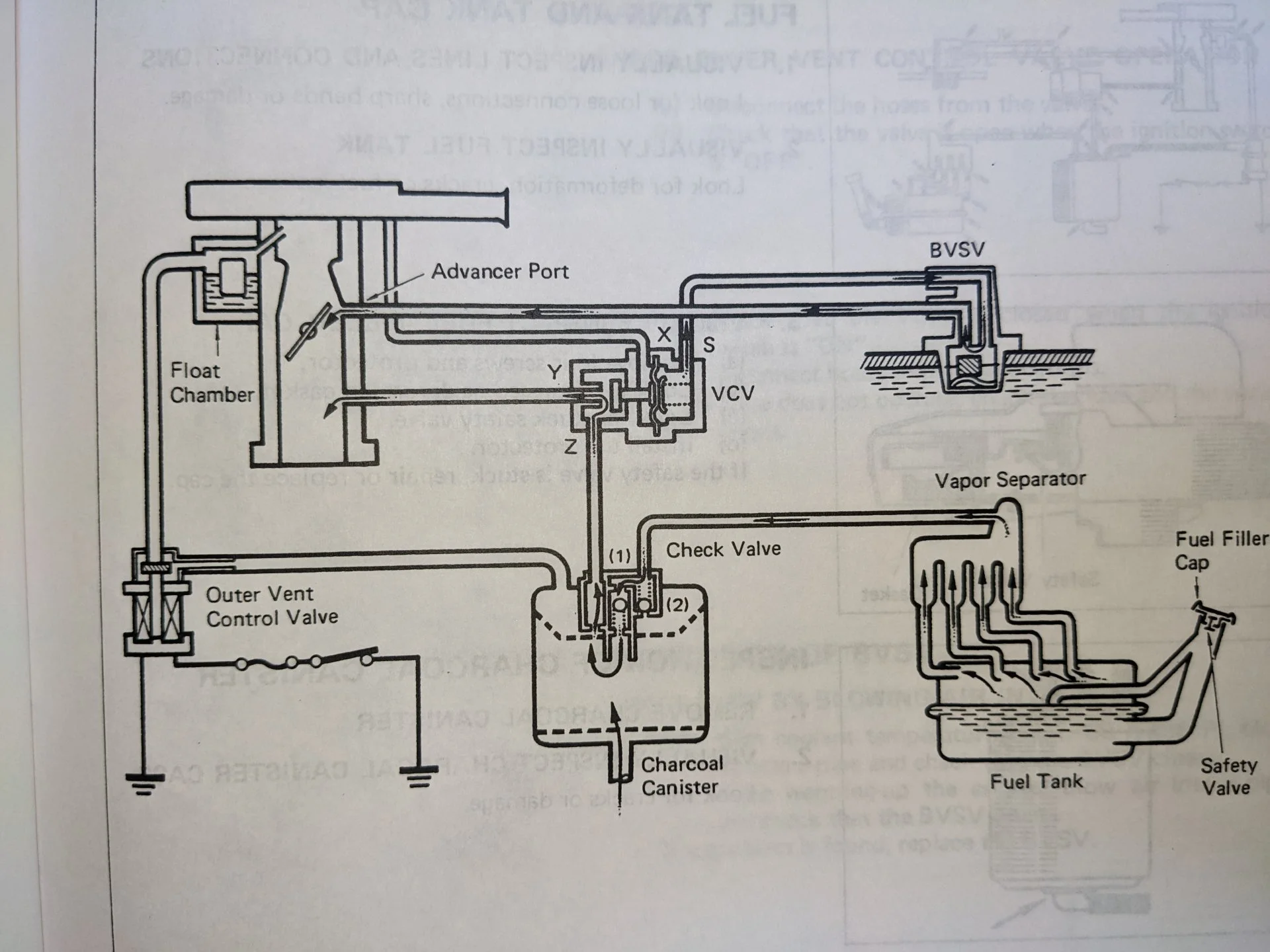

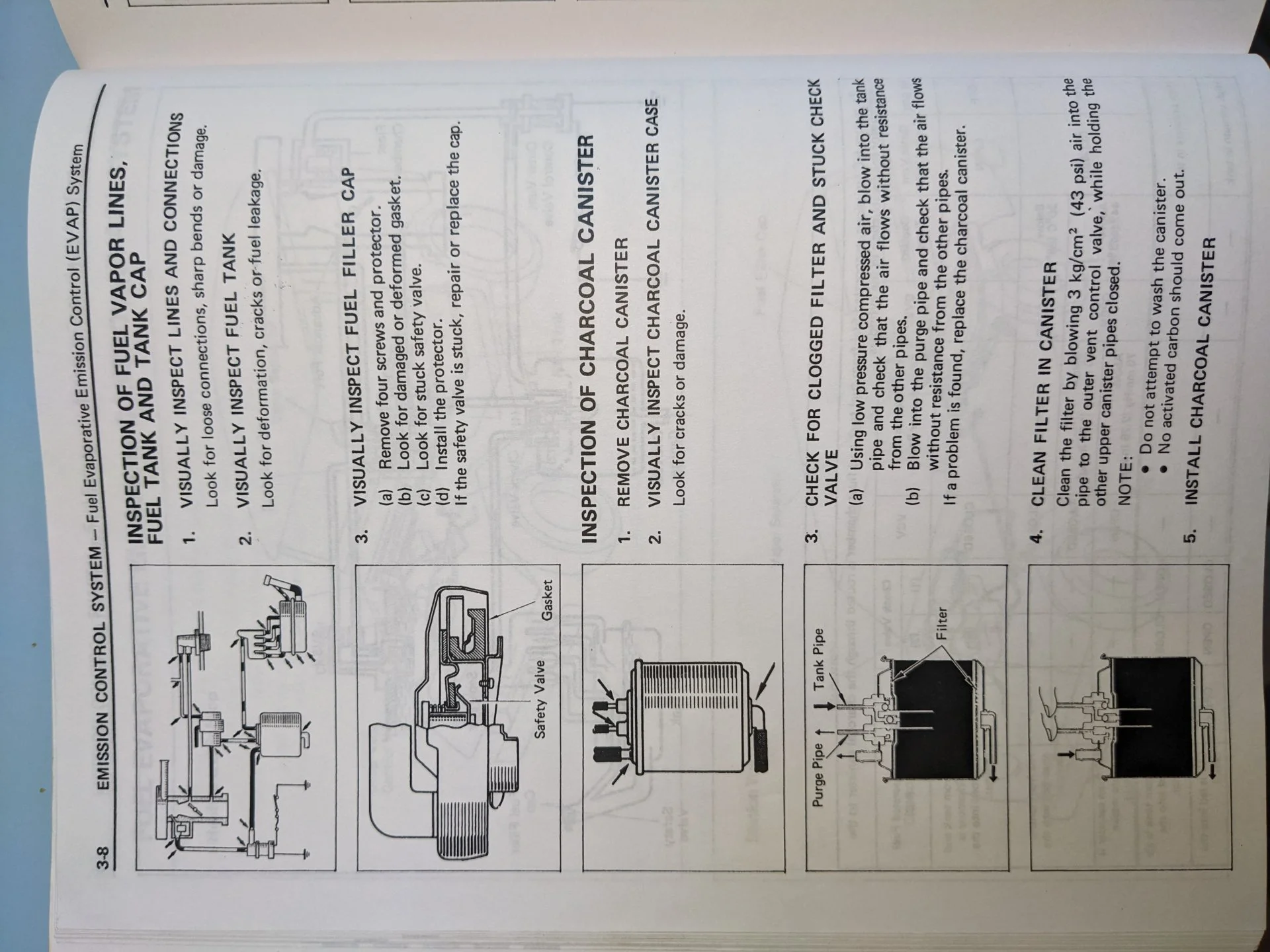

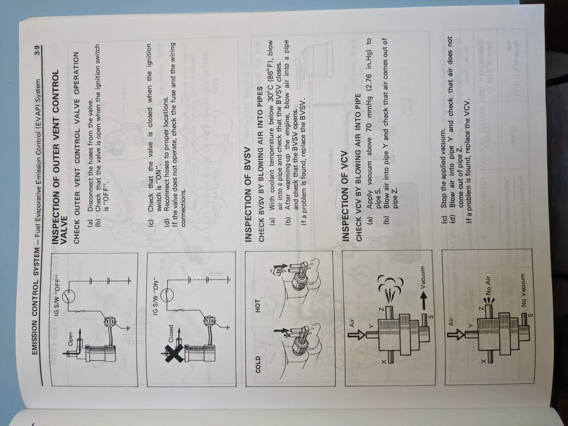

So I got some help from Jim C (on the clock) and he helped me sort some of this out for my particular circumstance. In the course of this I referenced my factory service 2F engine emission control manual. I'm attaching the pages relevant to the EVAP system here for others to reference. I hope this helps.
