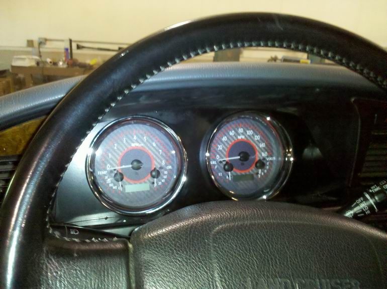

Kirk, I forget, did you get those gauges working? I don't see why my 91 cluster won't work. I should have my oil pressure gauge from Toyota and Temp sender tomorrow. I finally got my TB elbow and MAF. I was running Speed Density conversion but am going to do lots of injector testing so would like a MAF in there.
You should make a vid of the gauges!
wp...
Gauges are not working yet. Laser cutting two more brackets today to mount control box. I decided to go aftermarket bc the tach and water temp is very inaccurate. this Dakota Digital system is really nice. Awesome quality, design, great service and instructions plus made in USA. Highly recommend.
Kirk
I was, it did work. I removed it and put in the dakota sender. The tach was 99% of the reason.
Gauges in and working. Dakota Digital has a fantastic product here.

very cool!!! What wire did you use for the fuel gauge? Tks.
there was a wire in connector "d" that plugs into the back of the gauges i dont have my fsm diagrams but i think it was #14 and grn/yel still having issue with turns and brights working on the dash. The thermo is a 180 and the motor runs dead on at that.oil pressure is abut 35-40 and pushes 55-60 at wot.

Thank you, There are shifter gear position messages that light up in the led area on the bottom of the tach i did not use them.
I am making an addition to the dash that is not ready yet. I am chopping out the oem f + r diff lock, center diff, etc pieces out of the factory cluster and backlighting with LED's in a small pod that will be mounted to the right or left of the gauges.
Also since my speedo and trip odo is working I can now calc MPG. Here are the highlights from the Dakota Digital website:
