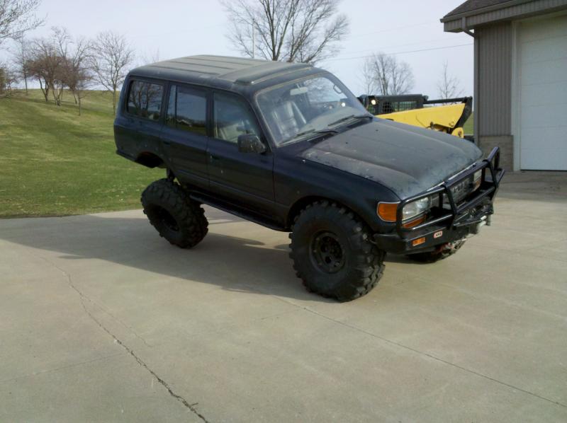

Heck, I thought I posted pics of the paintjob. Here is one. the 80 spent most of the summer at the bodyshop getting a oem green repaint. It looks great. I have been reading up on the audio threads. I am looking to put a nice, but not the ultimate system in it. No video, small sub etc. I am truly confused. too many opinions and options out there. Any mud audio gurus out there I would appreciate your thoughts. Thanks Kirk
