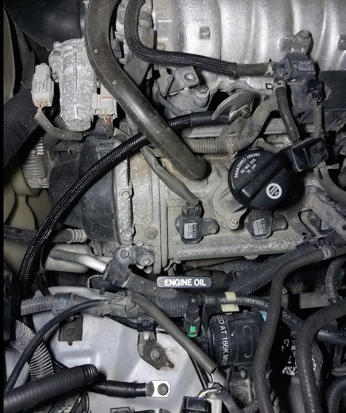

This kit was top notch, some photos below. I decided to replace these mostly because I installed a winch and was on an electrical kick. Cleaned up AUX power setup and added these ground cables.
The thick cable from the engine hoist hook seems to be best run towards the front and then looped back around. The angles looping it back the other way like OEM seemed to bendy for the cable.
I'm looking forward to testing the winch out and seeing if lights still dim, or if there is any affect worth noting with the upgrade. Maybe more consistent charge voltage, who knows. I will say my OEM cables were a bit crusty and starting to green so it was worth the quick and easy upgrade.
Battery to fender. If you have a larger terminal mount make sure you request it
Engine hoist to wheel well. Make sure you angle the cable so it doesn't put pressure on those other small wires or rub on timing belt cover
>> @Fourrunner is this what you had in mind for routing?
Firewall to intake. I kept OEM because IDK where it goes and seems fine either way
That routing works! Looks good!
Right one...... On the firewall cable, I wasn't sure if grounding to the intake manifold like that is logical. Is it aluminum, does it provide a ground....IDK. I'm going to poke it later with a multimeter and see if there is continuity to ground.
