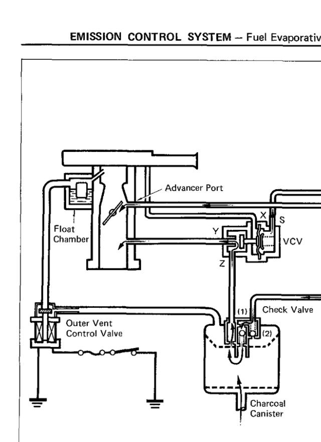

There is only one part of the OEM charcoal canister that can make starting more difficult.
I'm not convinced though that the CC is the cause of the problem.
If the Outer Vent Control Valve that is attached to the OEM canister is stuck in the open position, or its plug is disconnected, starting a cold engine is more difficult.
To be honest, I'm not sure exactly why this is so, as it's only venting to the top of the bowl... but I just know that that's the case.
How to test that valve is described in the emissions FSM.

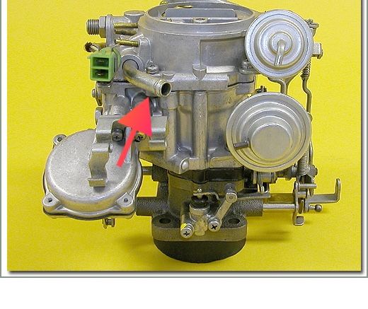

Air pressure above the fuel in the bowl is calculated and vented through the tubes into the venturi opening. Remember air pressure pushes fuel into the carburetor. Altering this may change flow rates to the accelerator venturi below. But I agree, this is not likely a CC problem.
It turns out that the tubes that go to the vapor canister are pretty important. The one that leads back over to the driver side needs to be capped or it can create issues starting. After going through this for 4 months, my starter finally died Saturday morning but would work after a thump. I went and got new starter and while I was at it I put a screw in hose. This morning in the frost it started right up. Thanks for the information everyone. This problem is resolved.
Can anyone think of a reason to put a vapor canister back in place? I have the GMC one now but was pretty happy with performance this morning. I guess the tube not being open when off could cause issues later?
Thank you Output shaft and Silver City Cruiser for the help. The capping the tube nailed the issue. I guess my old canister somehow did not block port when the tubes were switched? Leaving them off did not help either.

If you're going to cap off the float bowl vent pipe, you've got to make sure that the distributor venting VCV (clipped under the passenger's side of the air cleaner housing) is working correctly and that the venting plumbing for the distributor is correct and working properly. Otherwise you run the risk of blowing up the distributor cap.
The purpose of the float bowl vent was an emissions requirement to direct evaporating fuel in the bowl to the char canister. But it also serves a dual function of preventing the fuel vapors from ending up inside the air cleaner housing and migrating back down the distributor vent hose...to collect in the distributor.
yikes on that! Hopefully that takes a while?....So I guess its time to drill a hole in the bottom of GMC canister and then figure out where each tube goes. I am sure there is a thread somewhere explaining it in detail.
