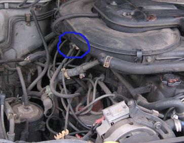

Thanks Jim, I was hoping you would chime in with some wisdom. This pic isn't of my truck but I was hoping to identify the VCV you talked about. You rebuilt my carb in 2006 but that was probably many rebuilds ago for you to remember.
Yes, that is the VCV hiding under the air cleaner.
