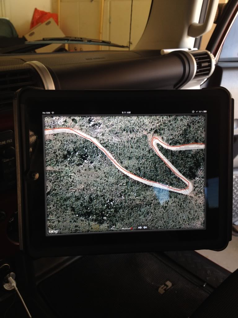

I'll chime in on my (semi recent) iPad install in my 2008 FJ Cruiser. I opted for a iPad 1 64GB 3G (AT&T) to save on the initial investment. 3G allows for GPS without WIFI.
I only use the iPad for couch surfing and in car navigation. I have movies uploaded and music is available via the cloud (I typically use my iPod for music though).

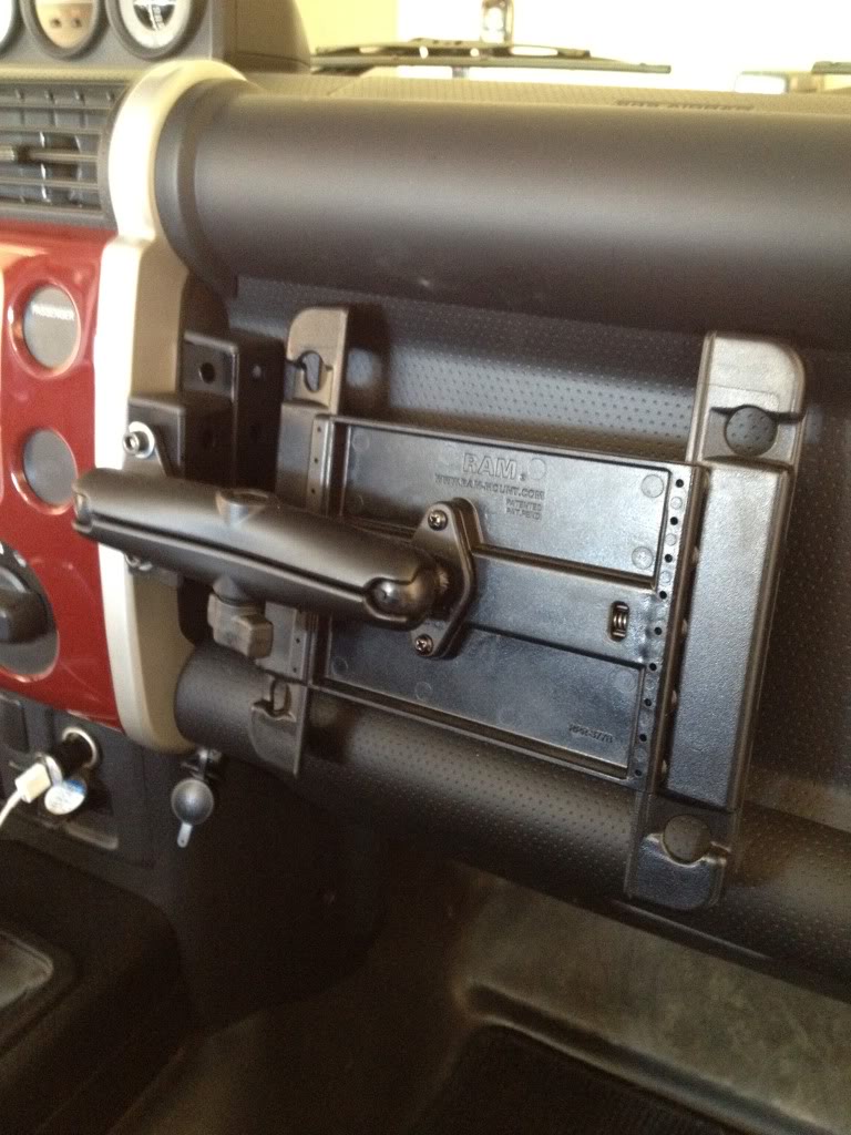

My install mimics others. I used a slightly different approach though.
Ram mount mounted to 1 1/4" x 1 1/4" square tubing (Lowe's) The holes allowed me to 'assemble' without the need to weld.
http://i917.photobucket.com/albums/ad14/C-Fish/40d2ba9d.jpg
Square tubing doubled up to allow the arm more articulation.
http://i917.photobucket.com/albums/ad14/C-Fish/6e5d2105.jpg
I chose the generic Ram mount for the iPad as I utilize a Otterbox Commuter series case.
http://i917.photobucket.com/albums/ad14/C-Fish/098a1ed1.jpg
Setup is solid, very little movement offroad, easy to adjust and allows multiple viewing angles for driver or passenger alike.
Mount also folds flush if iPad is not in use.
http://i917.photobucket.com/albums/ad14/C-Fish/0fffafd0.jpg

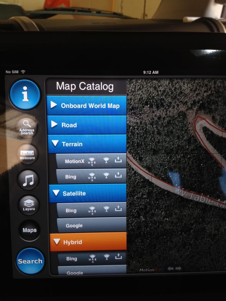

Apps installed are MotionX, Gaia GPS, CoPilot Live.
MotionX is a fantastic app. The only issue is downloading maps via WIFI. I've had downloads take 5-6 days for bigger files 1.5GB. I wish you could download to your computer and then upload to the iPad. Gaia allows much faster (TOPO) map downloads.
http://i917.photobucket.com/albums/ad14/C-Fish/c1031285.jpg
http://i917.photobucket.com/albums/ad14/C-Fish/09e913cf.jpg
I use my iPhone as a hot spot when I have cell coverage to cache maps, but I still have downloaded about 20gb worth of hybrid and TOPO maps on to the device. The zoom settings I use are 10-17.

Charging is done by a 2.1amp USB charger added into a (always hot) 12v source next to the glove box.
Parts list:
(2x) Amazon.com: RAM Mounts RAM-B-238 RAM 2.43" x 1.31" Diamond Base with 1" Ball: GPS & Navigation
(1x) Amazon.com: RAM Mount Long Double Socket Arm f/1" Ball Bases: Sports & Outdoors
(1X) Amazon.com: RAM-HOL-TAB3U: RAM Tab-TiteTM Holder for the Apple iPad, iPad 2 & HP TouchPad: GPS & Navigation
(1x) 1 1/4" x 1 1/4" x 36" square tubing (Lowe's)
(2x) 1 1/4 square furniture caps (Lowe's)
Assorted fasteners
Black spray paint.
Let me know if you have any questions.
-Mark
