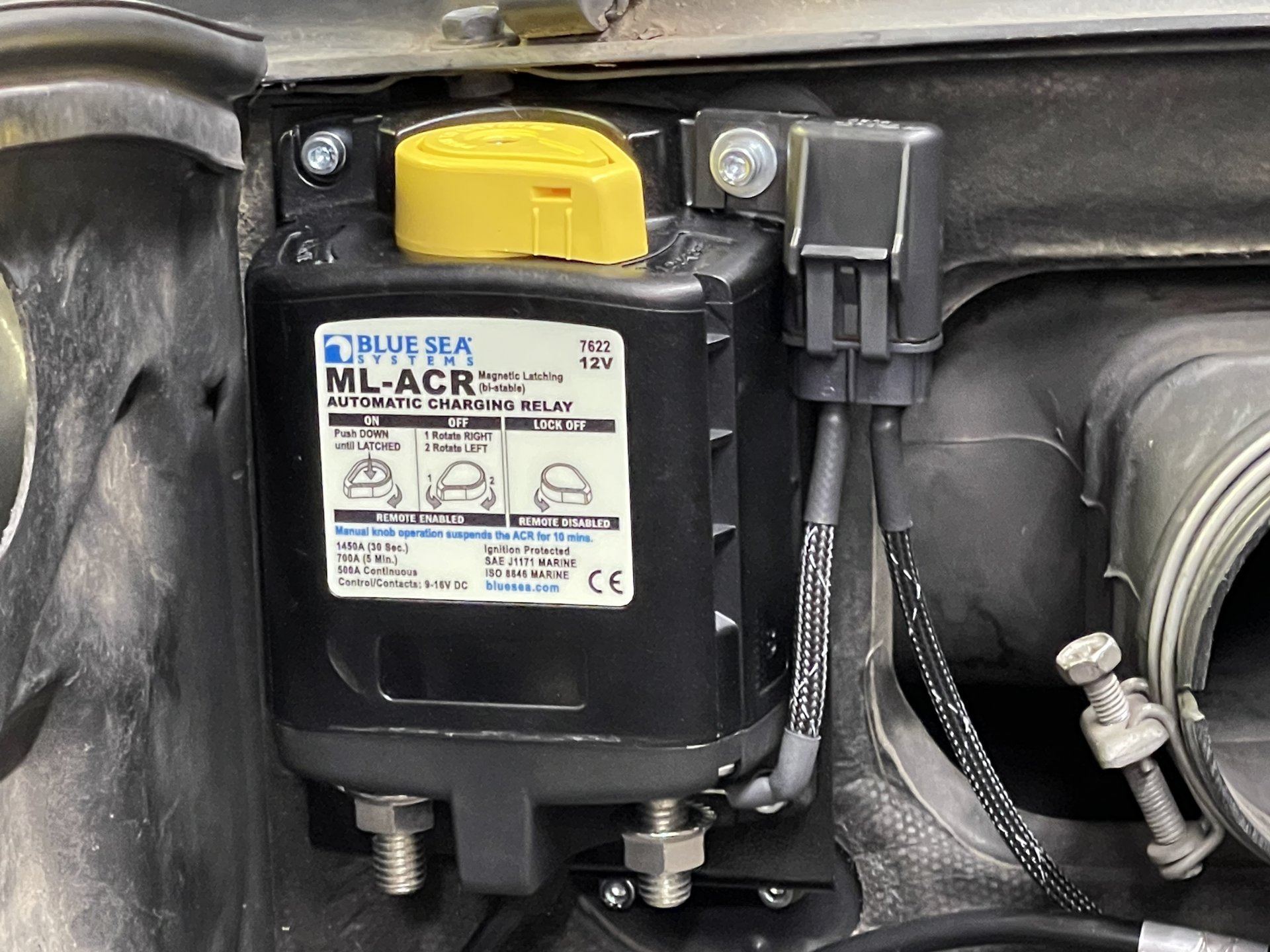

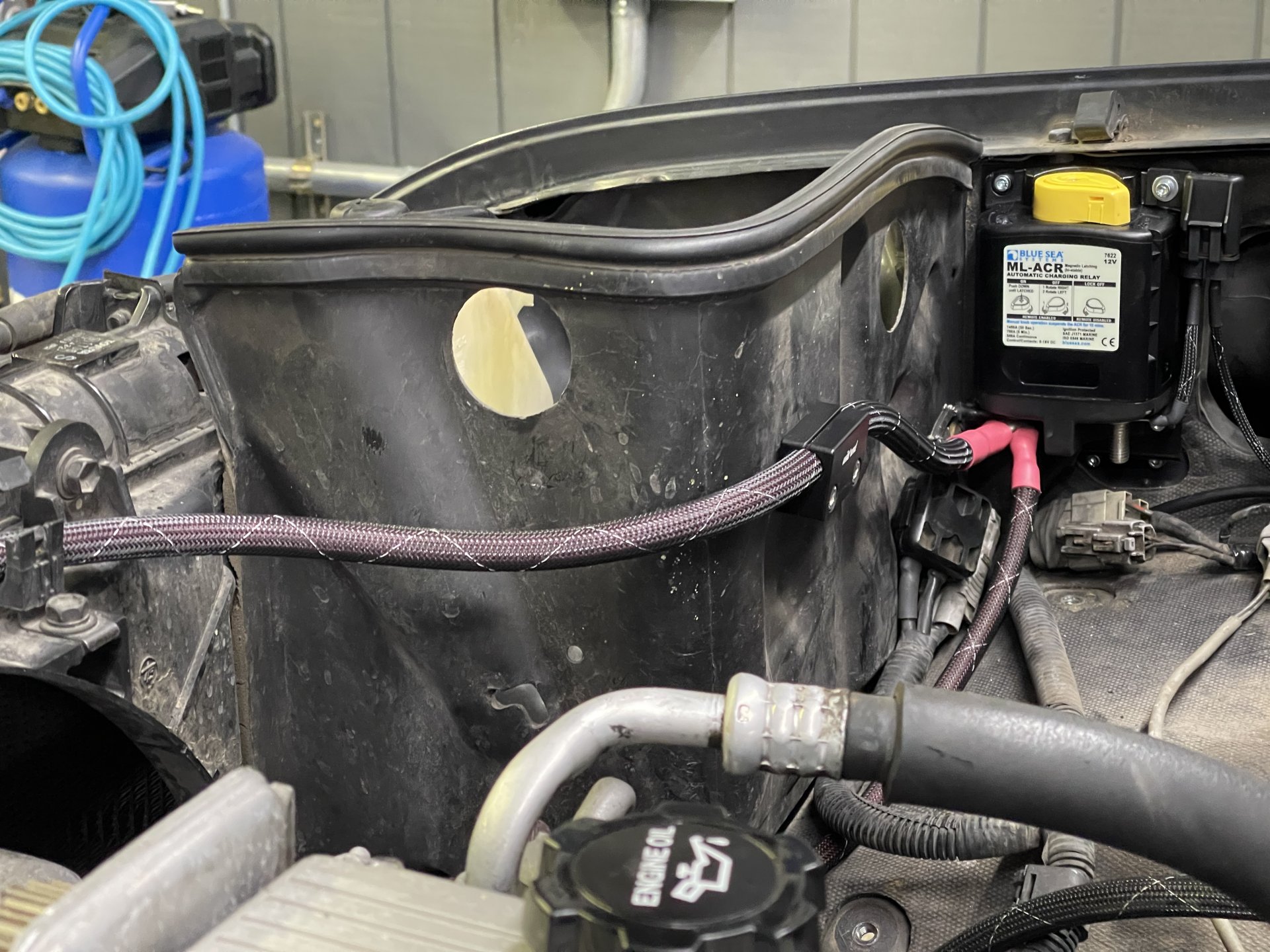

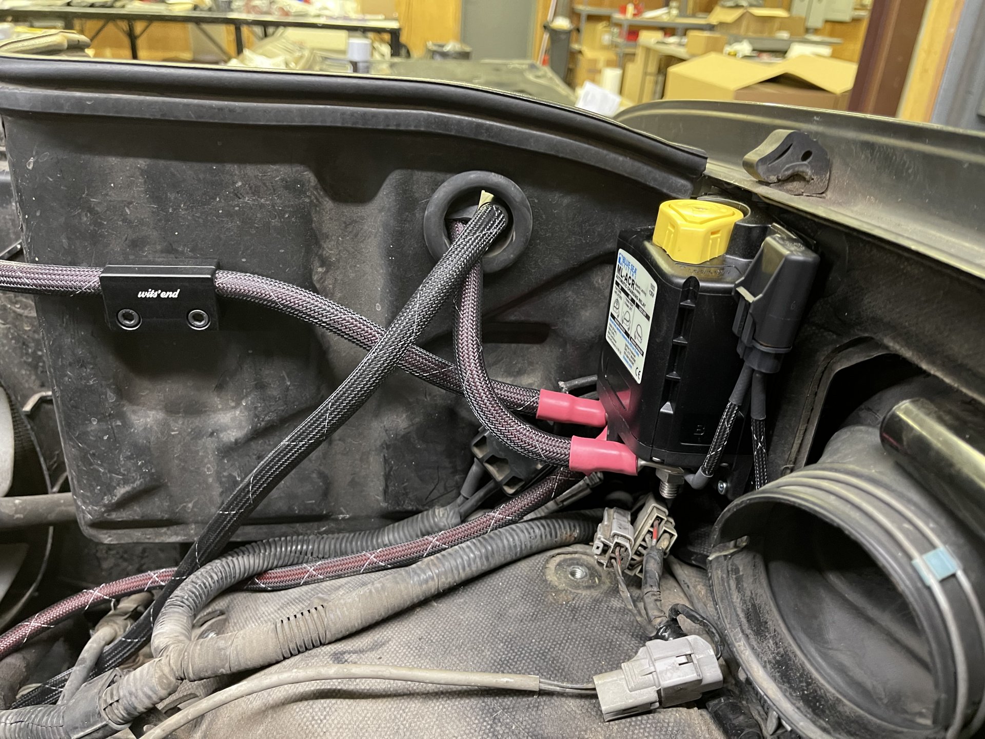

You need to swap out the starter. I used an ML-ACR to convert the 24v to dual batteries.

This is what I recently did for a customer (I’ll post schematic later):
