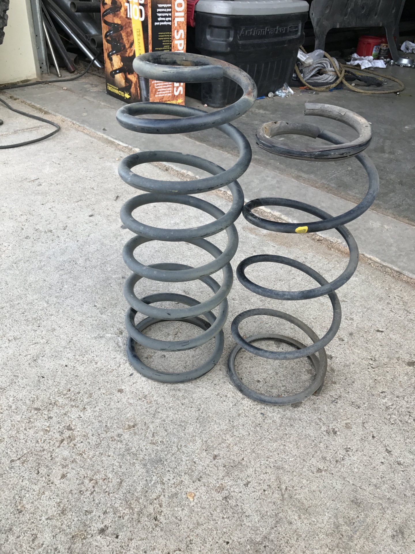

here is a comparison of stock lx470 and 80 series springs. Doesn’t seem as tall as the 100 springs
