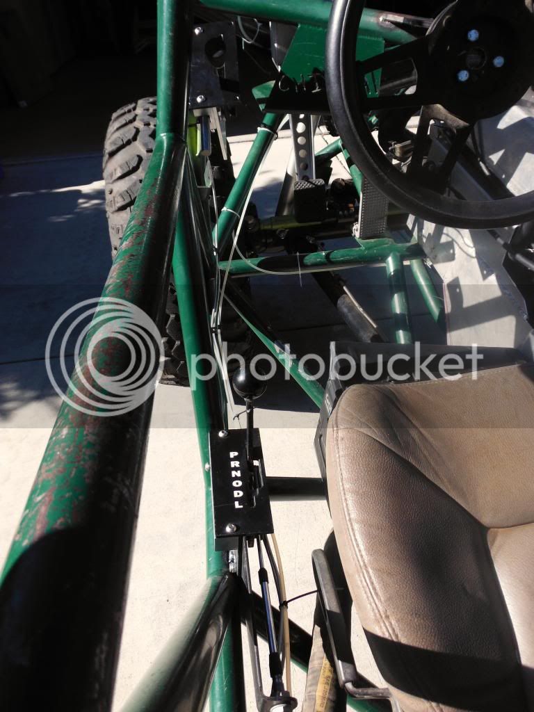

Update! I have basically finished the wiring harness for the engine. I took everything apart and soldered all connections one at a time and wired in the constant duty cycle solenoid for the Taurus radiator fan as well. The limit straps are installed along with the RAdesigns shifters which work awesome so far! Hers some progress Pics :popcorn:.
Both shifters mounted where I could reach quickly
