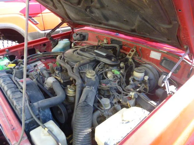

Before
After
Now hold on one dag gum minute, that must be some miracle cleaner! Turned all your vac lines, valve cover and body orange and took the wrinkles out of your air cleaner hose.
That weekend I ran the valves, painted the valve cover, replaced all the vac lines, plugs, wires and the intake hose is the same one, just a close in shot.
BTW, that's 309 freeborn red, not orange. Same rig, same motor... lighting I suppose.
