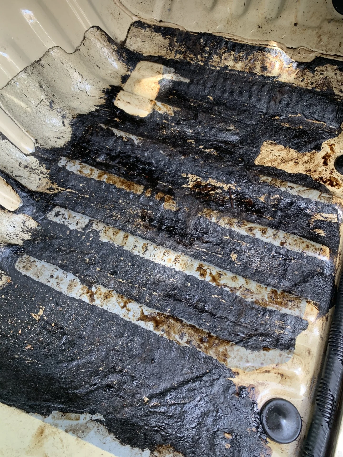

It is an asphalt product, even smells like roofing tar. If it were super frozen with dry ice, it might work. But at room temperature it will just put a bunch of dimples in it.
Use a plumber's torch, heat small areas about 4x4 inches, keep the torch about 6-8 inches away so it doesn't catch fire and only until soft, about 5 seconds, then scrape with a putty knife. You want it soft like clay and it comes off nice and clean (mostly). If it is too hot it will melt. It will still come off but will be messy. A few seconds to cool and you're back in good shape.

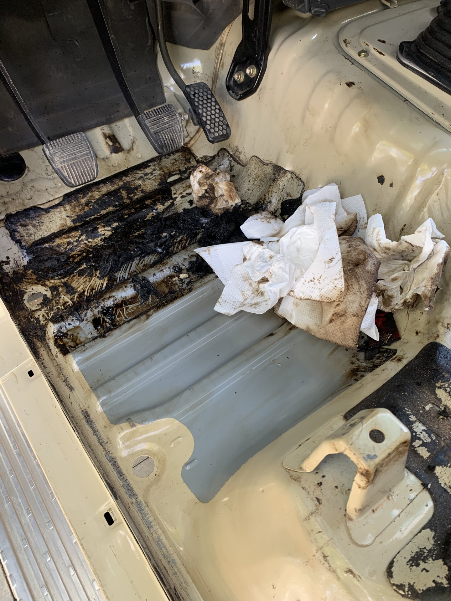

My apologies to everyone. Yesterday I was mindlessly scraping and made a hastey assumption of what I saw. Today I took care to assess what I was looking at while scraping some more.
That brown stuff, while coincidentally the same color as the tar film looks to be a coating. It is transparent but appears to be protective. Working on the passenger floor today, as much as I tried, I could not avoid scraping down to that coating. I did not find any body colored paint. I did, however, find a couple spots of paint still having some integrity. The paint is black. And, there is a spot where I inadvertently scraped through it.
Anyhow, Toyota did put something on the underside metal. It kind of looks like cosmoline but more durable. I did scratch it while scraping off the undercoating.
That's what I think. Now I want to just get back to mindless scraping while streaming Pandora.

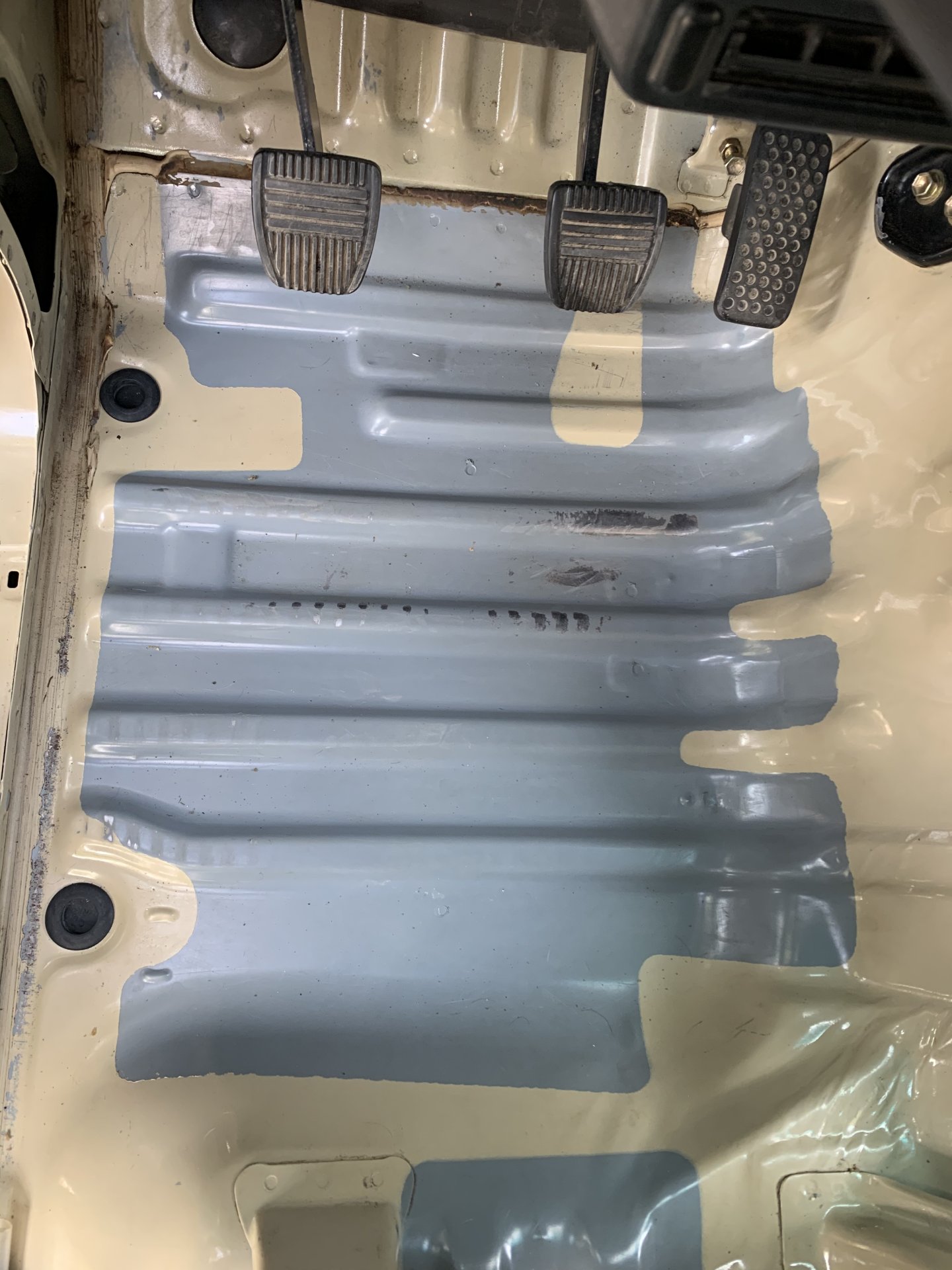

I had good luck removing the factory sound deadener off the floor pans of my FZJ75 using a scraper and a heat gun. I know a plumbers torch has been suggested but the heat gun will soften it up as well without having an open flame. By using this method none of the paint was removed. Of course that's not applicable if there isn't any paint under the coating.
Nice work. Did you use plastic scrapers to avoid scratching the paint? As some have said, there is paint on the underside, but it was more like over spray than actual paint. Anything that resembled body color paint was softened, I believe, by the solvents in the undercoating.
I tried 3 or 4 different plastic scrapers and they all got too soft with the hot sound deadening material. In desperation I "borrowed" one of my wife's Pampered Chef scrapers. It was perfect; thankfully she was out of the country at the time. :D
While scraping the softened undercoating with the putty knife, surface looked very even and "coated" with a brown, transparent material. It did not come off scraping any more but I could scratch it with the corner of the putty knife. Today I went over it with mineral spirits and it cut right through it. It looks like it was a stain on the metal from the undercoating. Progress.
