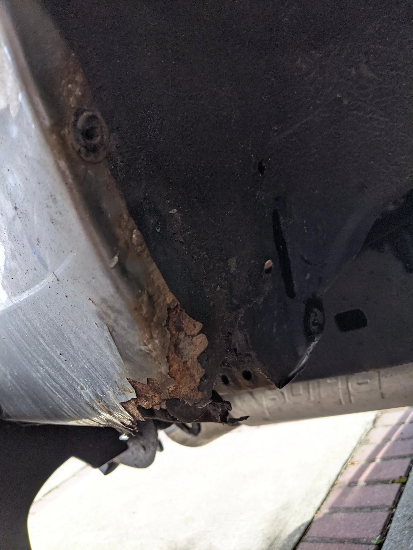

Here some other photos I just got some welding done by the rear wheel well. It was really rotten. Welded, primed and painted. It seems like a common spot for rust to start on the body.

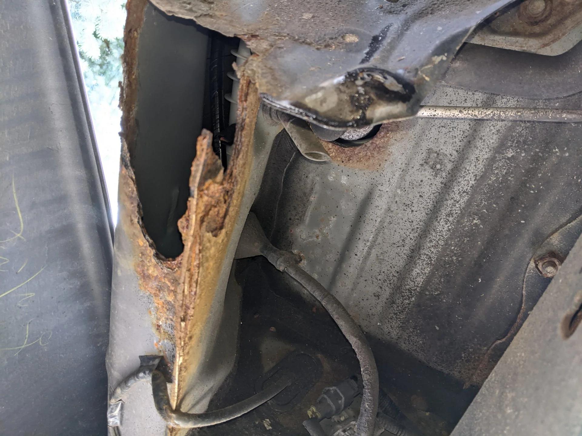

At this stage of the rusting process, you would normally also get a leaky tank, and filler pipe.

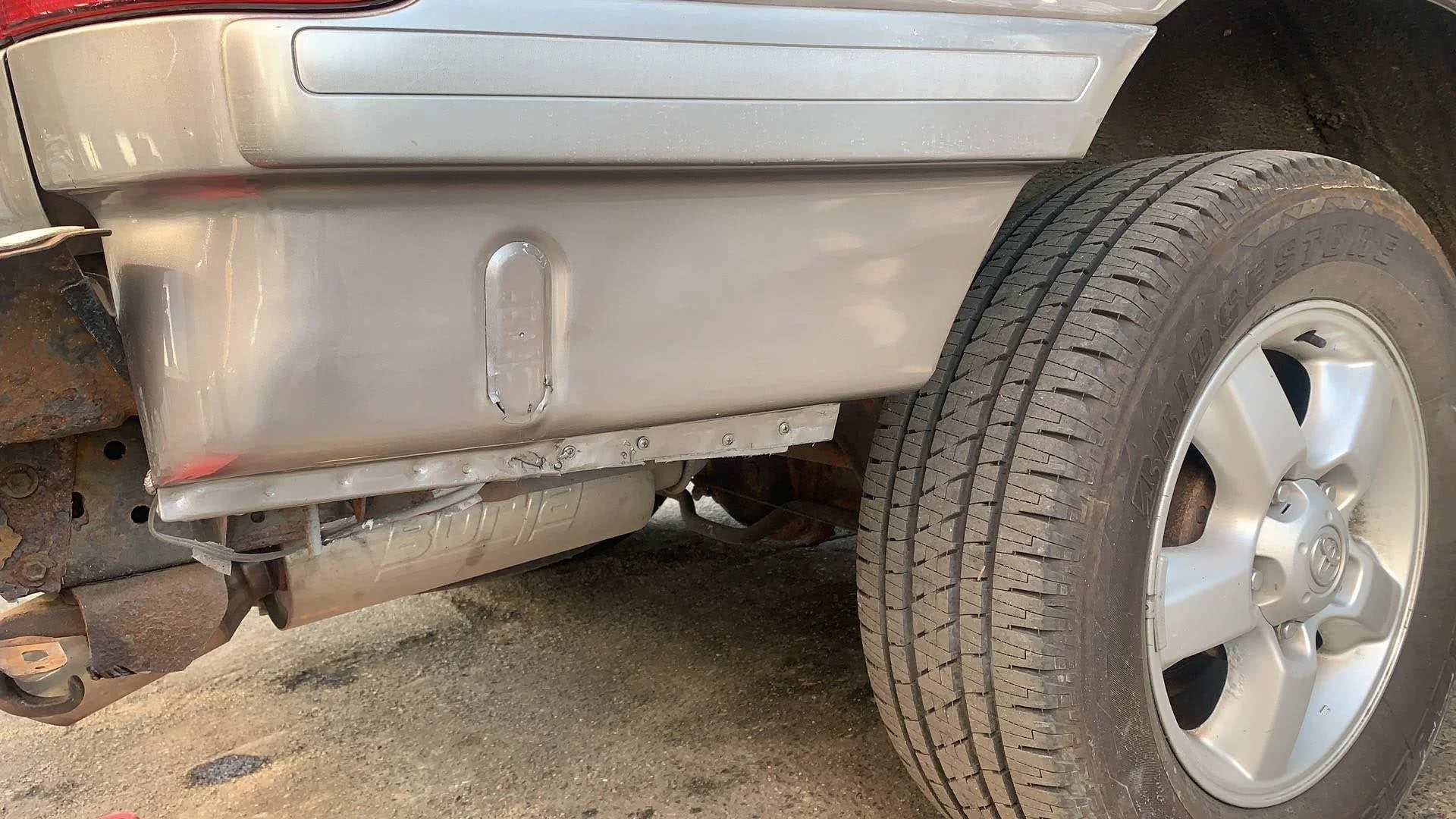

One owner, garage kept 2000, but the truck spent 4 years in PA, which left a mark. A 2nd, trusted opinion, tells me there is plenty of steel left in the frame, but I would like to remove, if not replace the plastic skid plate that is broken. What is the name of this part?
TIA, Fellas.

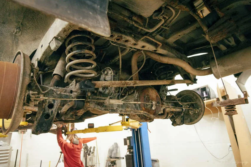

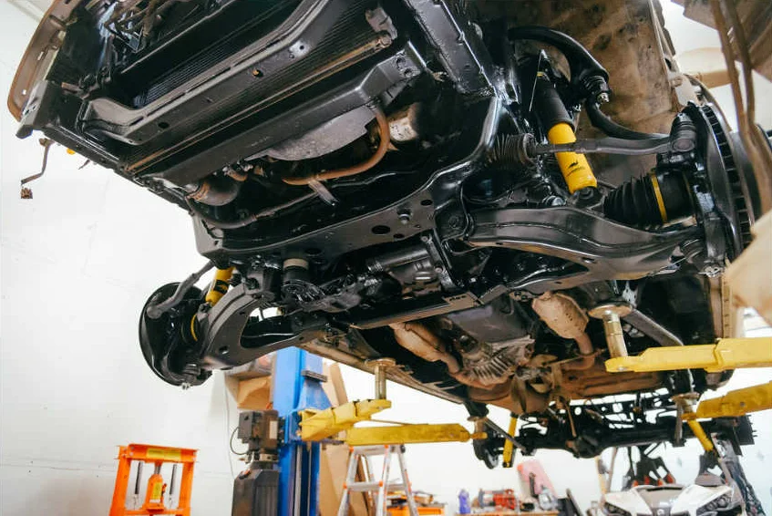

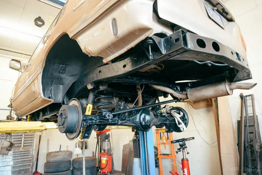

Some body repair is obviously needed and in progress, but the frame and suspension cleaned up pretty well. I do plan to drop the rear axle in the near future to fully strip and rebuild it. It needs all new hardware, brake lines, and a little more rust attention. Otherwise, the structural parts came out pretty well.
