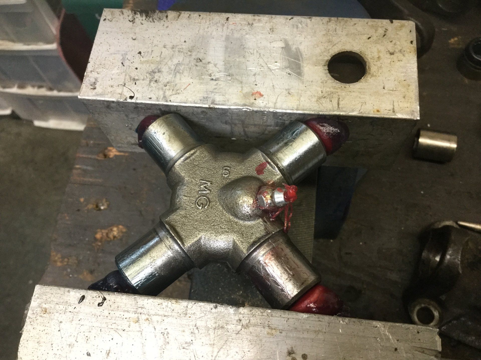

So I had a seized front cup on my rear driveshaft. So I replaced it. The question is, what do I do when only one
of the new bearing caps accepts all the grease? It goes to one of four and excess just squirts out around the seal.
Should I punch off the clips and run a cleaning rod through the center of the joint housing to clean it out?
Pic of grease imbalance
The grease needs ooze like that when pressurized by a gun from all four pivots.
Try some fast pumps to maybe clear whatever's blocking the flow, otherwise take it apart and find the problem. Or maybe drive it around the block and try greasing it again. Maybe something will clear out once it gets exercised
It’s still on the bench. I guess the easiest would be to take it all apart.

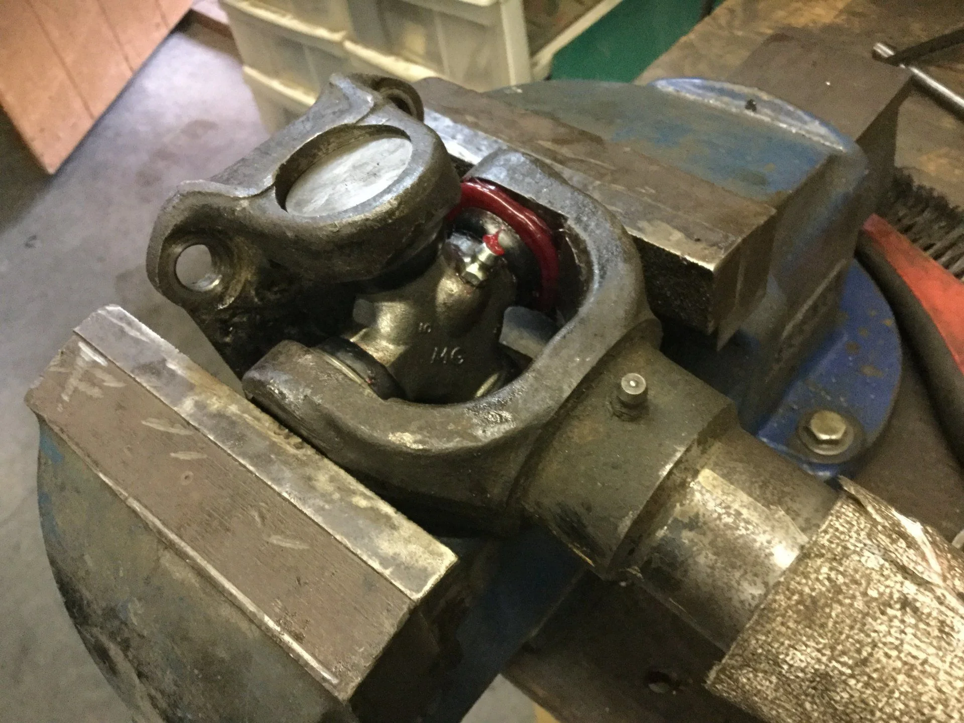

So took it back apart. Ran a skewer through the body. It’s not a very clean design.
Anyhow, greased it prior to reassembly just to confirm it goes to all four corners,
but it still was really weak into one corner. But I put it together anyways, and I’ll see
how it accepts grease after I’ve driven it for a while.
I did learn, that to insert the tension clips back on just firmly push them down with the face
of the hammer until they are held on with tension. Then tap them on with a chisel.
There it is with the body greased. The storage grease is pretty ugly and hard. God knows how
long these things sit in bins until they get bought.

When installing the new grease should last a long while, as it takes the least resistance it will exit the nearest, the inner hole is so large the grease should have no problem reaching at least a few pins, maybe grease after some driving when the old grease heats up a bit.

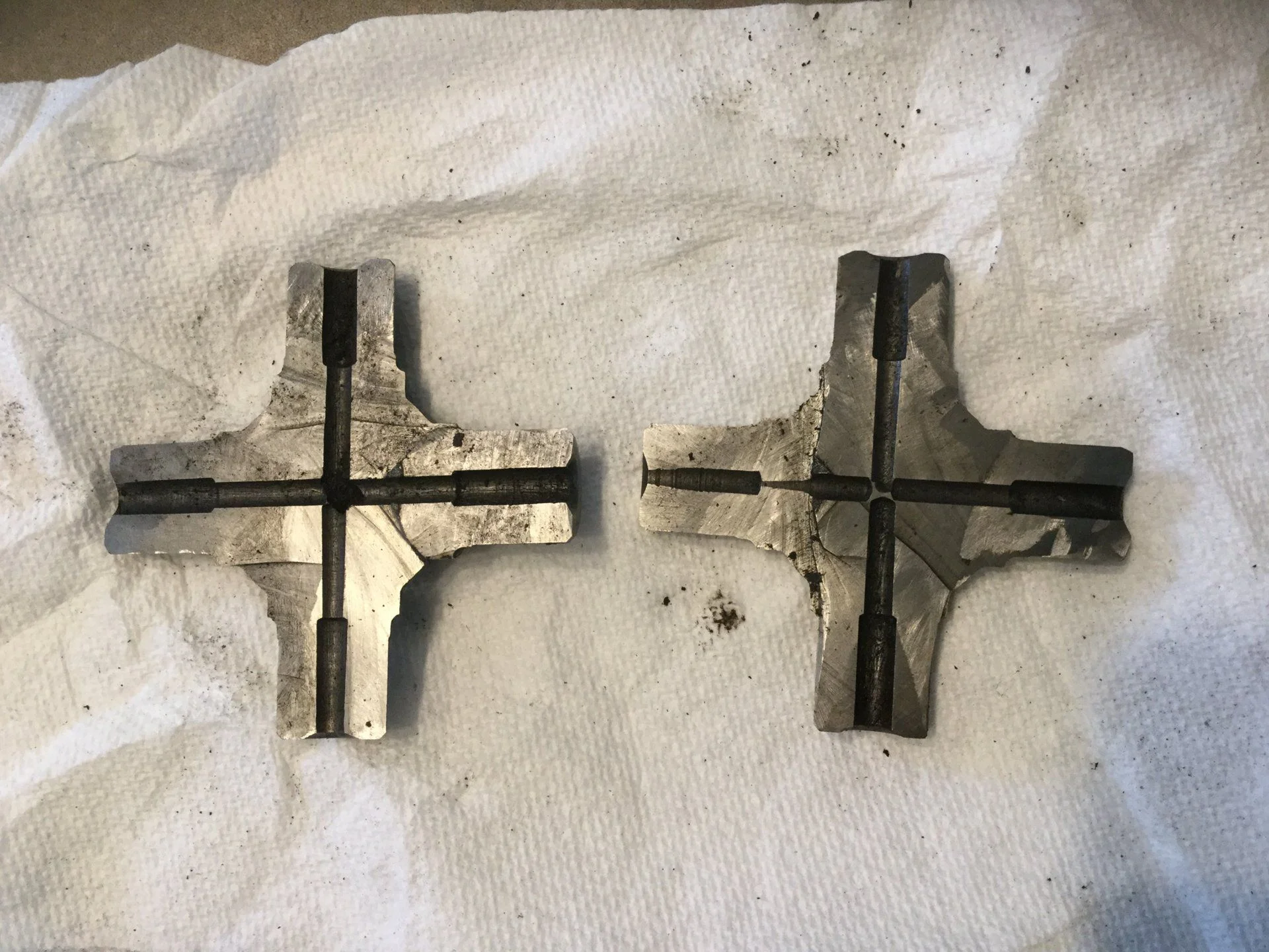

So I’m pondering work, and had some time so I cut the recently removed u-joint right
down the middle. As I thought. With an imperfection... This one was ok, not bad just
getting side to side movement on one pair of yokes. It’s a rear and I plan on 20,000 kms
of backcountry gravel this year.
I opened it up like a sandwich, so the two yoke ends are together as they came apart.
i can see that the drilling isn’t even and thorough through the middle, this could easily
lead to grease imbalance and potential failure. In the future, I’m not sure how to
deal with this. These are very high carbon steel. I will try to drill with one of my
Walter bits through the next one, just to see if it will cut.
This one did have proper grease on all four corners when I took it apart.
