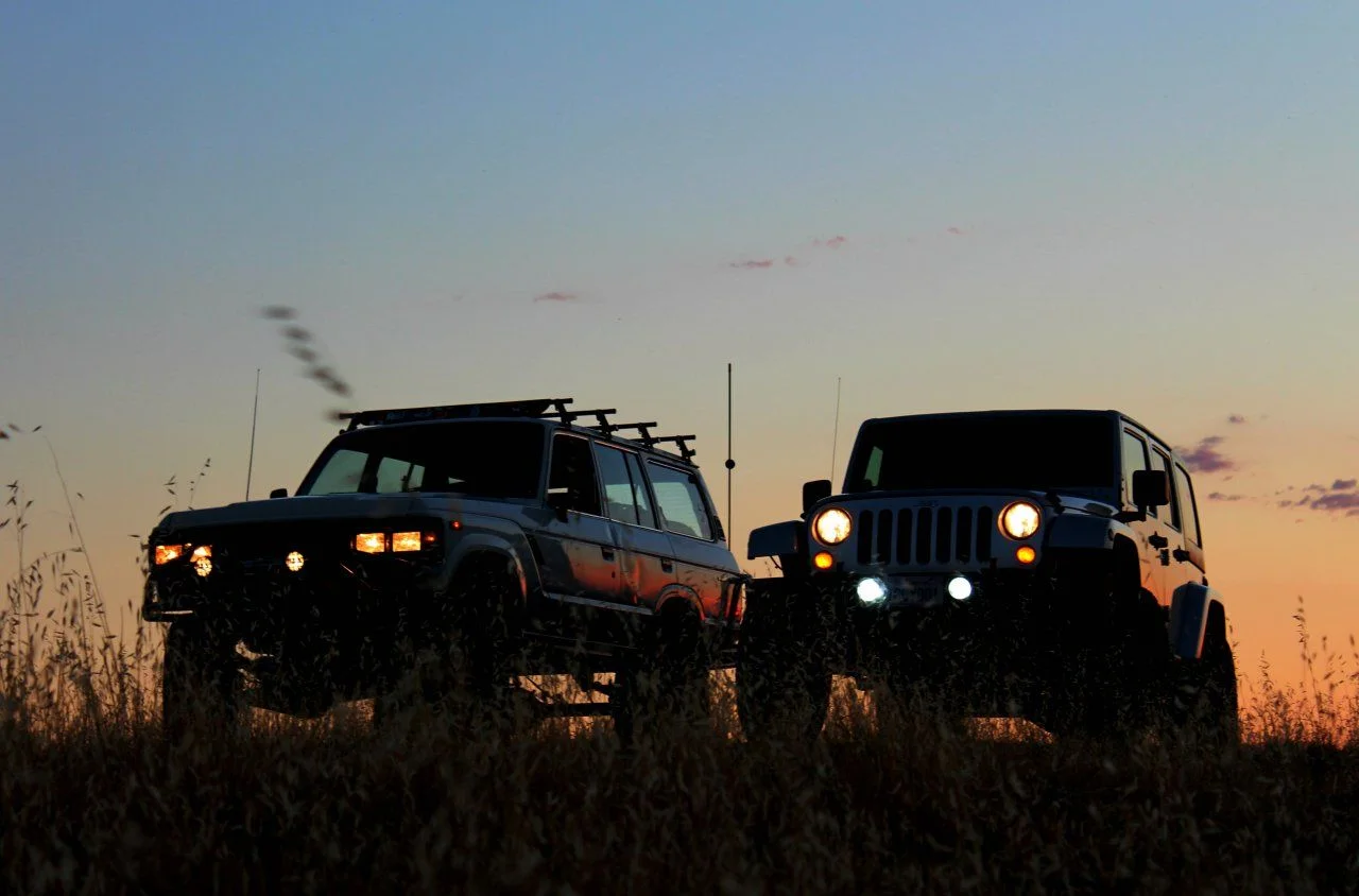

messed around with a j**p the other day

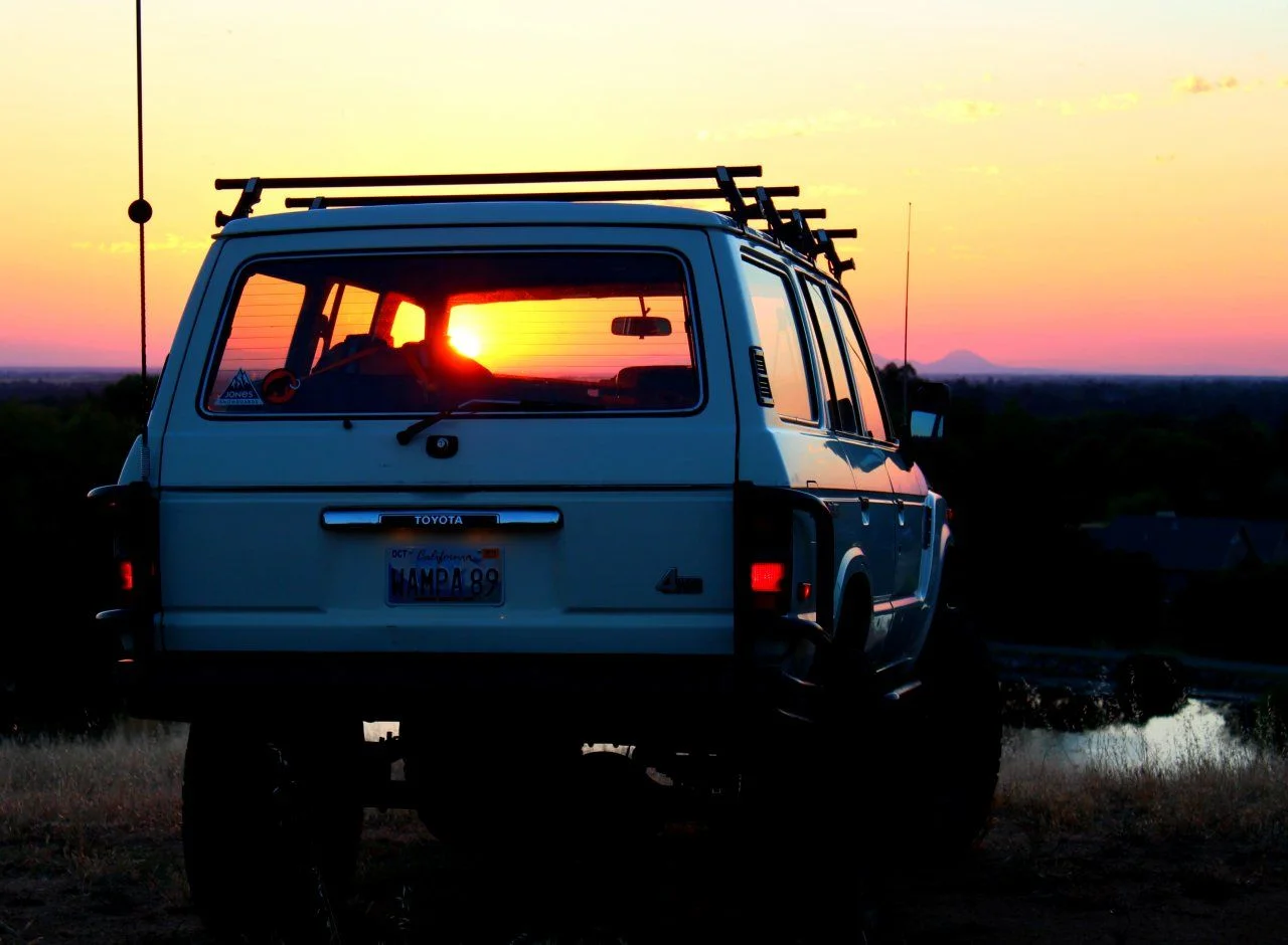

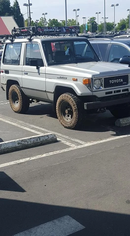

Alright guys.. I know its not an update on the truck. Its been about a year without WAMPA. You know its bad when you start having dreams about your old cruiser. I really wish i kept the owners name and number just so i could check up on her. If anyone knows or sees anything post it up! I have gone through a TRD Tacoma and now i have a Turbo diesel BJ70 and i still dont get the same feelings that i did driving WAMPA. Im definitely not ready to buy it back but its just amazing how you can get so attached to a vehicle. Who knows.. maybe WAMPA 2.0 will be in the making in a few years. Anyways.. im always lurking and getting jealous of you guys!
