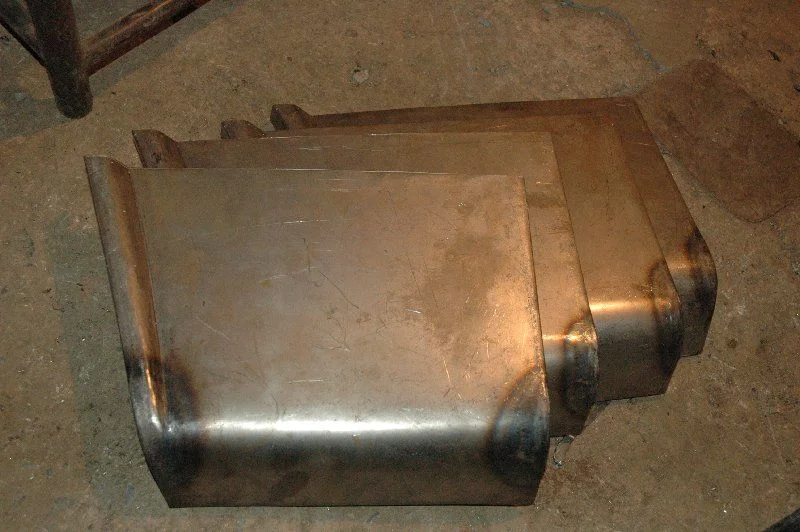

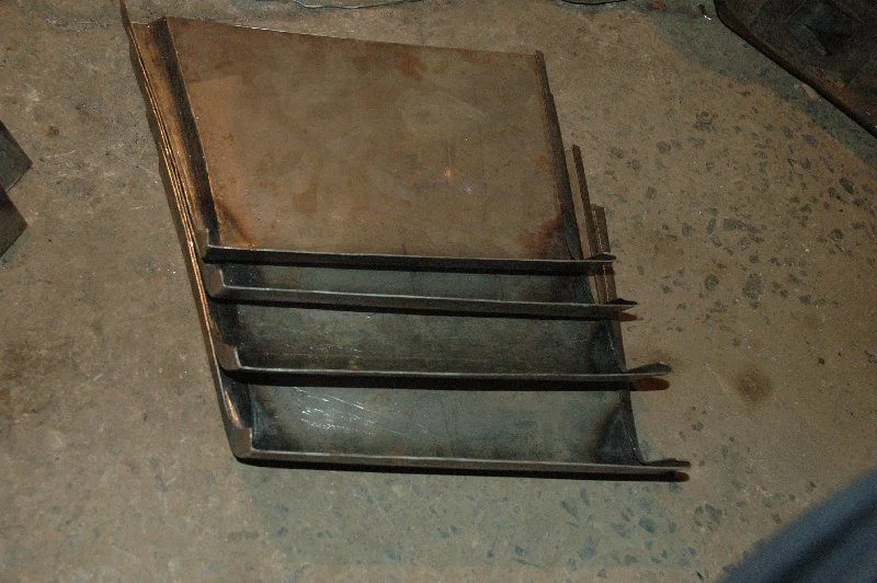

Rust behind front wheels..........best fix is to replace sheet metal.IMO fiberglassing only hides the problem and it will come back much worse; Ehsan from this forum made up 10 sets of fender patches and from personal experience they work very very well.HTH

Hello there
Kindly see the following for our repros.
attachment.php
attachment.php
