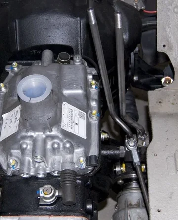

I had to bend mine in basically a Z pattern so they would line up and look okay. Here are some crappy pics that I found in my build pics. I have never had a problem shifting them. Georg's kit kicks A$$.

Stock linkages are kind of a rube goldberg contraption and some are loose and wobbly and don't engage positively. Twin sticks made a world of difference for me in terms of easier, postive shifting, after I installed an Orion transfer case that has stiffer detentes than stock.
