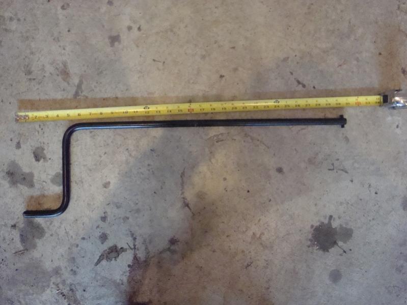

I have the hand crank style nut the crank pulley. I made this up pretty quick with 1/2 pipe. Works great.
I don't have mine anymore... got rid of it with the F motors. It'll even start the rig in a pinch. Keep it well lubed if you don't want to break things.
I'll add this to my list of unicorns to look for...
There are measurements and specs in a thread to make one... If they kick back it'll break your wrist, so be cautious.
