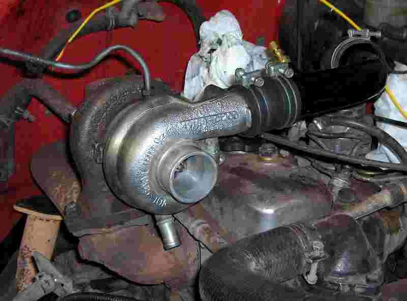

Okay I got it.
Hard to tell in the pic, is it a flipped manifold set up? How plentiful are these turbos in wreaking yards or availible elsewhere. I don't even know if I have heard of Diesel D-50. Seen the gas ones running around. There couldn't have been too many off them.
The manifold is flipped upside down, I am not sure about the avaiablity I got this one from one of my buddies who owns a auotwreaker as a gift. I checked into rebuilding it when I got it and I do know that the rebuild kit was not hard to find.
The performance is a huge improvment over stock, well worth the hundred dollars it cost me too install.. I dont have any bases for comparision since I have never really been around any other turbo'd 3B's.
No this Turbo is out of the D-50(like and s10 or older dakota) not the fullsized truck. I drove this truck when it still ran and i noticed it seemed to have a bit of lag, since it was a smaller motor than the 3B I took a chance and thought it might work. The Turbo spools quite quickly and does not seem to restrict in the higher rpms.

Just came back from the junk yard... and the CT26 I found from MR2 have a 4 bolts pattern and the 3B manifold have 3 bolts ??
3GTSE = what model/year ?
Some one can post some pics of there CT26 turbo... on or not on the manifold.
And if I flip the manifold from my 3B engine do ya think I have enought place under my BJ70 hood ? Some one already do that ?

Knew to this forum... THE FORUM ROCKS>> >>> The turbo information is good. I recently installed a Turbo on my BJ-42. It bolted right on to the manifold. No modification. The turbo came from an mid 80's Dodge D-50 diesel. I am boosting a safe 10 pounds and everything seems to run smoothly. This is a mitsubishi turbo however unlike the 2.2L mitsubishi gas turbos no coolant is required to be run through this turbo. A major bonus. With a diesel there is no need to run the coolant through the turbo so that is one less step to do the whole thing took about a day.
So you just flip the manifold ?
the D-50 turbo have a 3 bolts pattern ?
