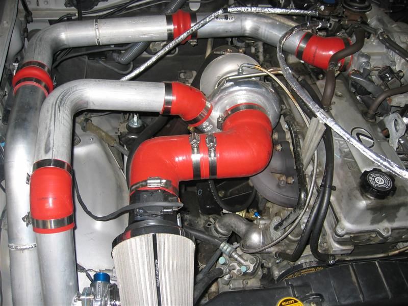

Here is my setup! GT35R ball bearing turbo. Stock inj/pump/computer (no tuning) with 8psi.

I see you aren't recirculating the BOV, that's supposed to be a no no. Have you measured your AFR coming abruptly off of WOT?
I have an Innovate WB02 sensor with the digital readout near the DIFF LOCK switch. It runs rich all the time. 10K miles later... no issues. It does like oil seemingly like all the 1FZ's.
I believe my A/R on the turbine is .82 I'll have to look this weekend.
Gives some turbo diesel trucks a run for their money :D
The packaging of the air/water intercooler will be much nicer. Mine has miles of intercooler piping that gets pretty hot to the touch. I'd like to measure my inlet air temps at the TB.
