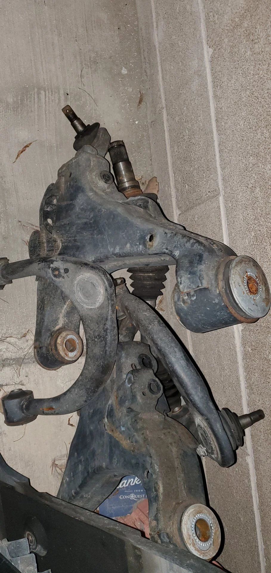

curious how 210k (Vegas rust free?) miles looks compared to my 125k set that spent 1st 6 years in NYC. Can you send me some pics? How are the bushings?
I believe there is a little bit of surface rust on some parts of them, the bushing were ok from what I remember. I'll get you some pictures later on tonight when I get home. They are defiantly good candidates to be rebuilt with new bushings and balljoints.

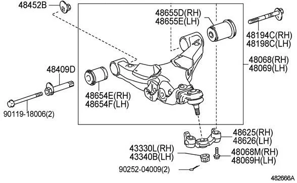

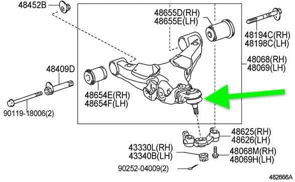

Possibly might work. It's the ball joint boot shown? Is it torn on both left and right sides?
I'll look around, i've never heard of that as replaceable, but who knows. The Phoenix delivery would be a BIG plus, because even with free LCA's, shipping can be pretty pricey how large and heavy these are. I'll look around and if anybody else knows any info about the boot pls chime in.

I believe the boot part number is: 4334509015
Def looks correct, prob not difficult at all if you have one of those tools to deal with the ring. Lemme go take a look and see what the ring looks like. MY13'.

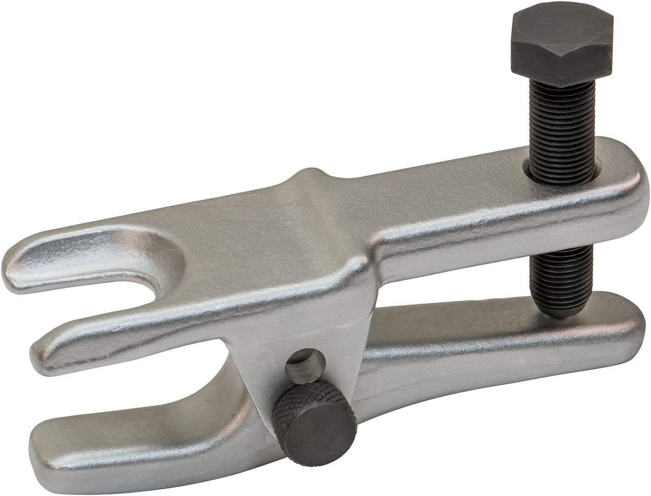

For anyone who's about to tackle any ball joints/TRE jobs and are sick of using pickle forks and struggling - I wised up and got this tool. I was busting my ass working on separating the tie rods on my truck with the pickle fork and a sludge and this tool literally got it off in 10 seconds. I'm a huge fan.
OEMTOOLS Tools 27308 - $21.73 on Amazon.
The boot came off very easily and it's def the part shown above. The ring however is still on there and it looks like it's just flat overlapping wire (ok not really wire), I'd assume there's some easy way to get the old one off and the new ones on.
The ball joint looks good too.

Absolutely, we stock the boot kits too!
