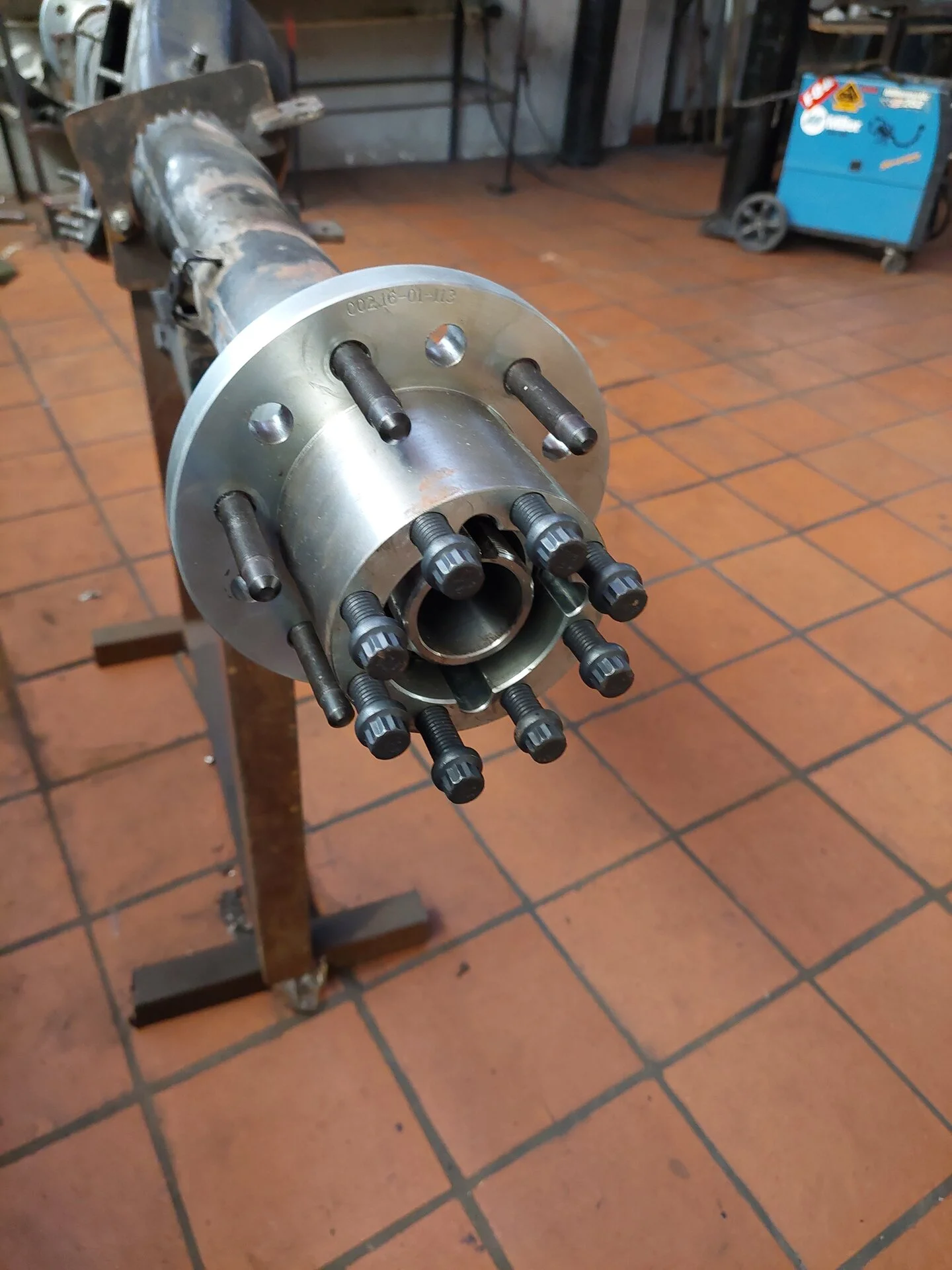

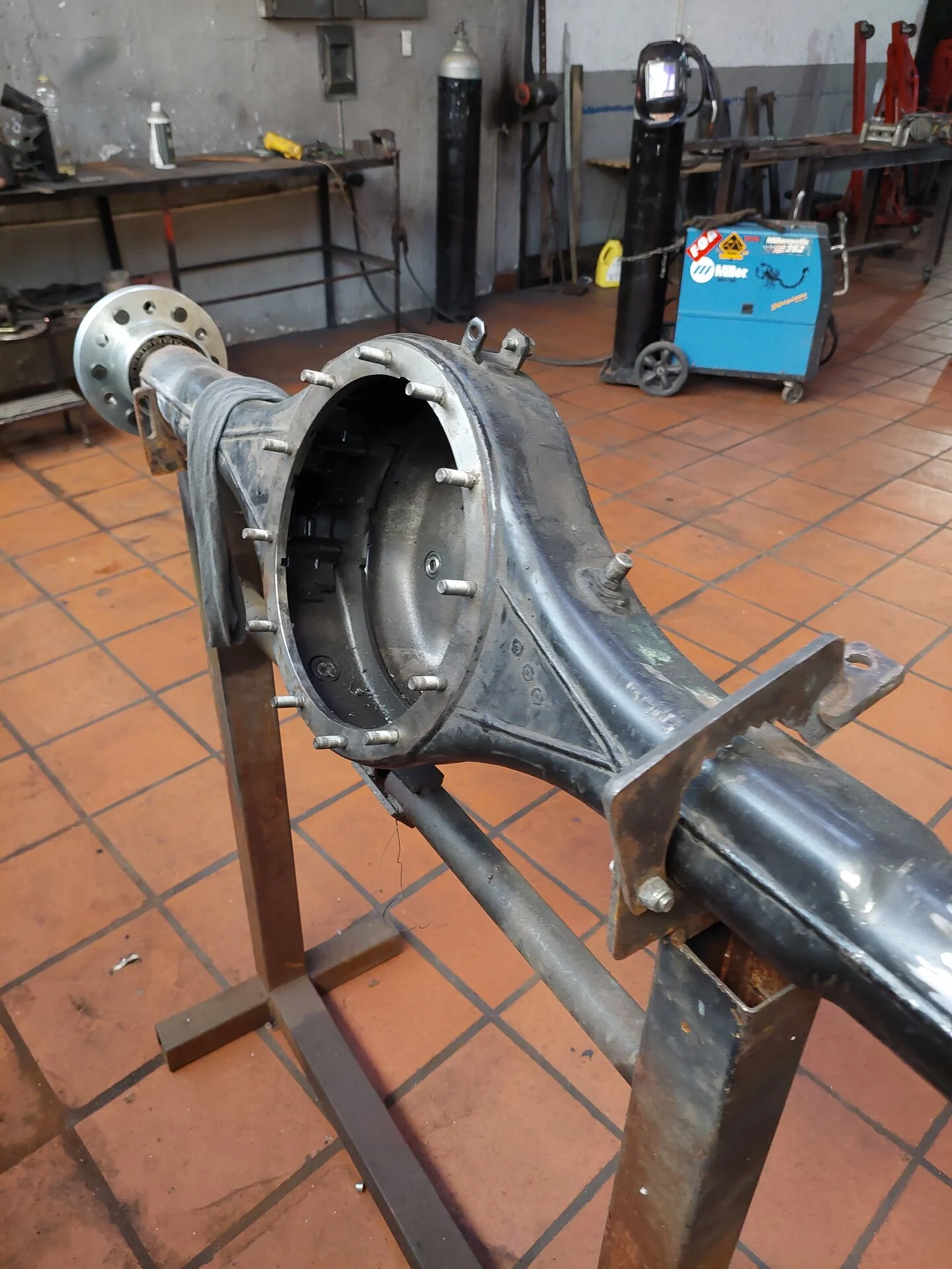

Nice Im using OEM axle housing.. i bougth spindle and hub from ruffstuff for 14bolts 6 lug , cutting 3/4 inch wider each side from stock 80

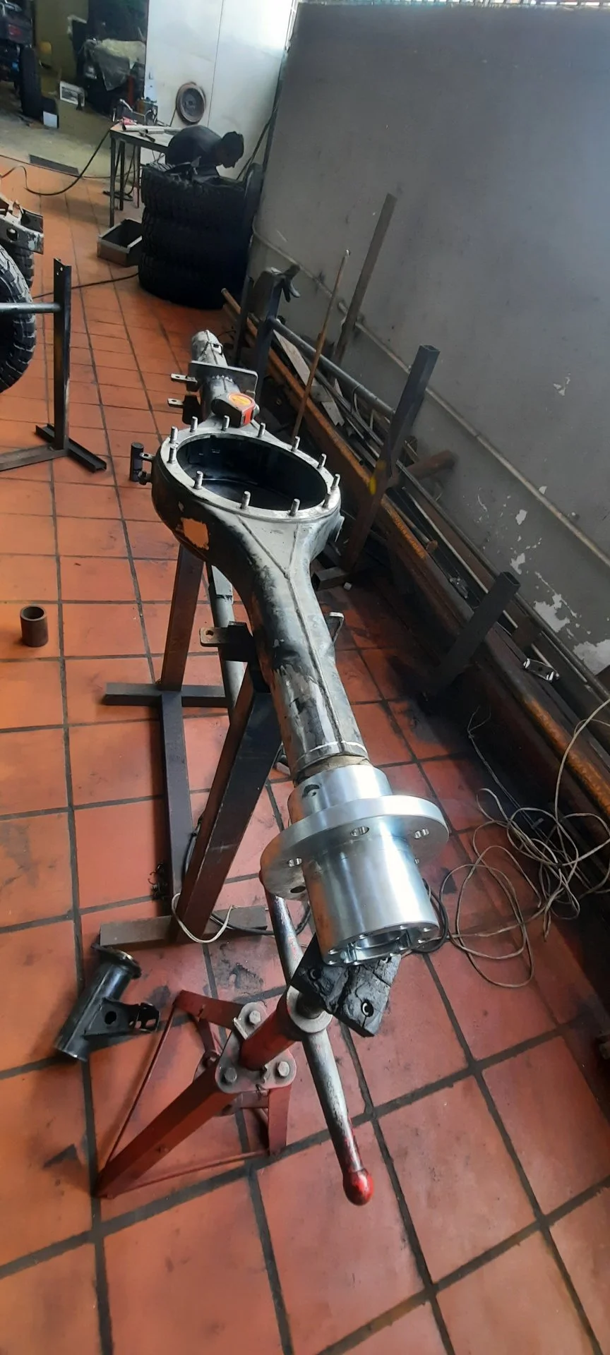

Need work a lot on the latle, the inside diameter of the OEM housing tube, is Way to big for the ruff stuff spindler, so need to re-size the spindle, the hubs need to re-drill the lug to acomodate 12mm lug

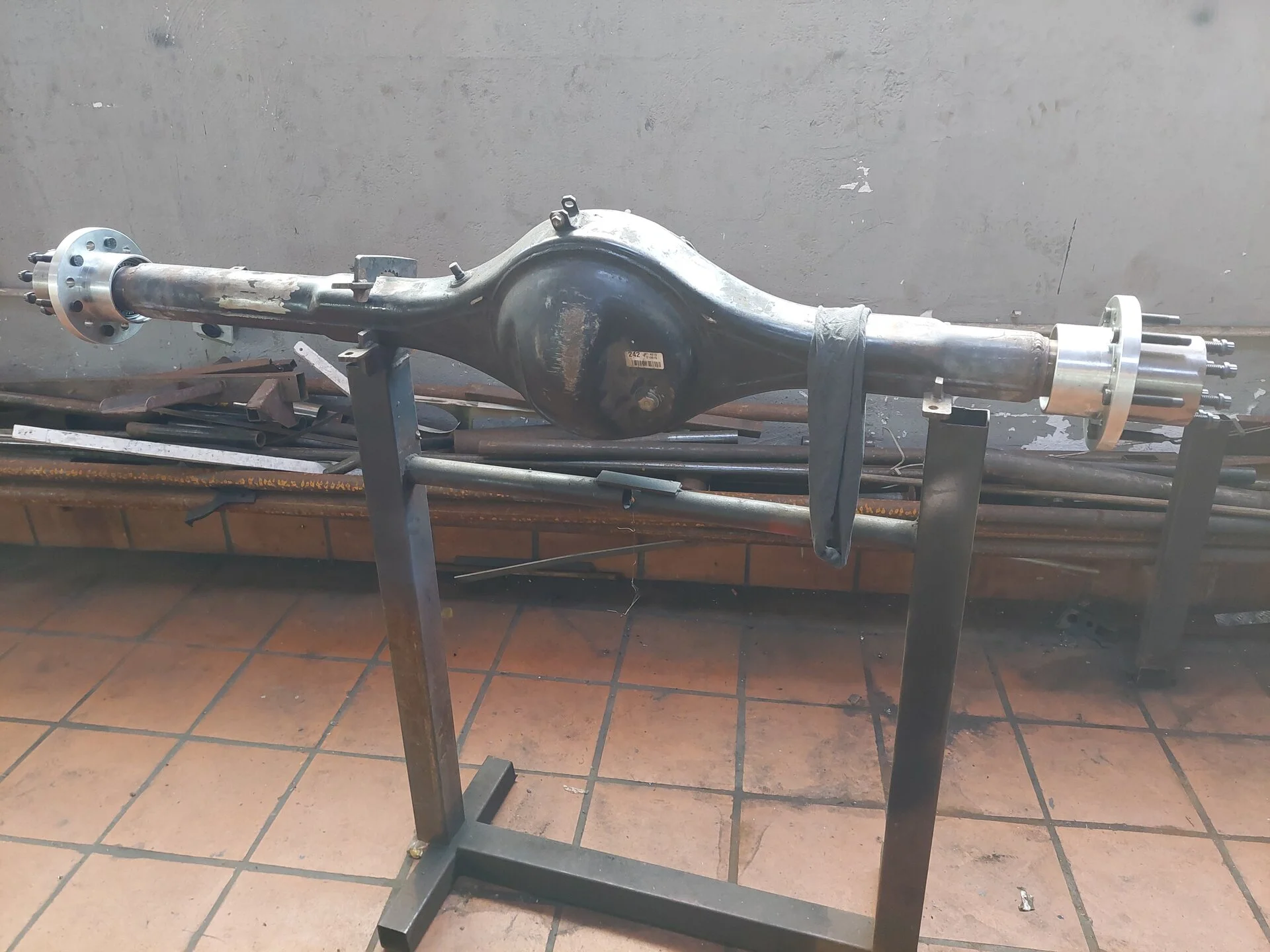

Well ita done ... now.. need to measure axleshaft to make it....
Rad. Any more details on how you installed the spindles into the factory housing?
Did you use any kind of alignment bar/pucks in the spindles and diff/housing to keep everything aligned when you welded it out?

The Ruff Stuff Toyota 10.5" is ready to go in. Raised the axle coil spring mounts to eliminate the coil spring spacer on top of the springs. Used Ruff Stuff link and shock mounts to help speed up the process a little bit. Just waiting on the axles shafts to show up from Moser Engineering.
