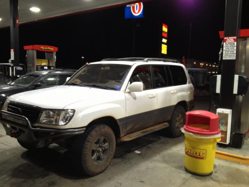

Good job Shaggy...that pretty much is the best you can do as far as approach angles for these trucks....well done...
Love the look of this bumper.
umm, ya I want one of those. Are you thinking of selling your design to a fab shop?
+1 on this. I've always been surprised by the lack of aftermarket front tube bumpers for the 100, especially considering the number of options for the 80.
Looks great Shaggy. I usually think most tube bumpers don't work well on modern vehicles because they leave so much wiring, radiators, etc exposed and it looks bad. Your combination of plate in just the right spots makes it look very clean. Just the right amount of plate, and right amount of tube.
Great job!
That is a very nice look. Clean and simple.

I will be inquiring to some known fab shops to see if they would be interested in this tube style bumper. If you like the style, let it be known! And give your critiques.
Great build. Nice to see a real tube bumber that doesnt have a ridiculous hoop on the front, or stick out 3 ft past the grill. Nice, simple, functional & slimlined...the way they should be.
Looks pretty good for a tube style bumper. You definitely have a talent for fab work. Personally, I prefer a bigger bumpers looks and angles still though. That said, it looks like there is a significant market for your tube bumper. I wonder if it is as strong as a bigger slee/arb welded plate bumper. Have you done any winch testing with it?

Gotta be honest, I didn't think this was going to come out looking as good as it does.
Nice work!
Thanks, I am pretty confident that it is on the same playing field as far as strength is concerned when compared to a fully boxed plate style bumper. The center section alone is well overbuilt and arguably stronger than other plate type bumpers on the market. That extra strength is not needed, however, in certain cases it might help. That extra bulk also helps keep the front end of my vehicle down when loaded up.
When you say winch testing, do you mean casually using the winch, real world usage or stalling out the motor? I have only used the winch to test its clearance while sitting in the bumper. The winch cradle and its supports are built in such a way that the whole bumper (and vehicle frame) would have to bend or break out of the way for failure to occur. In a nutshell you would have to destroy the whole front end of the vehicle for the winch cradle to fail. Before you reach that point, either the shear pin in the proclip would break, the line would break, or the 4 3/8" bolts holding the winch on would shear.

Shaggy, would you be willing to fab a replica of this for a small fee? I'm actually very interested in purchasing a (low profile?) front bumper and this one looks awesome!
Looks you have some interest brewing.
I'm not a huge fan of tube bumpers but I like it. Maybe offer an additional plate instead of a place for the lights? Unless that's a dog light that's needed.
Is it bolt on? That's a must have as I'm not comfortable cutting my cruiser up as others might be.
What's the cost come to? And what winches are supported? When does production start? Will it hold up to extraction?
Sorry for the noob questions; never had a tube bumper.
It's obviously personal preference but for whatever reason I really prefer the look of tube bumpers to the bigger, bulkier looking boxed plate bumpers. I really like it! I'd definitely consider one based on price.
My .02c is I like the round cut out better than the slots but that's a minor detail.
