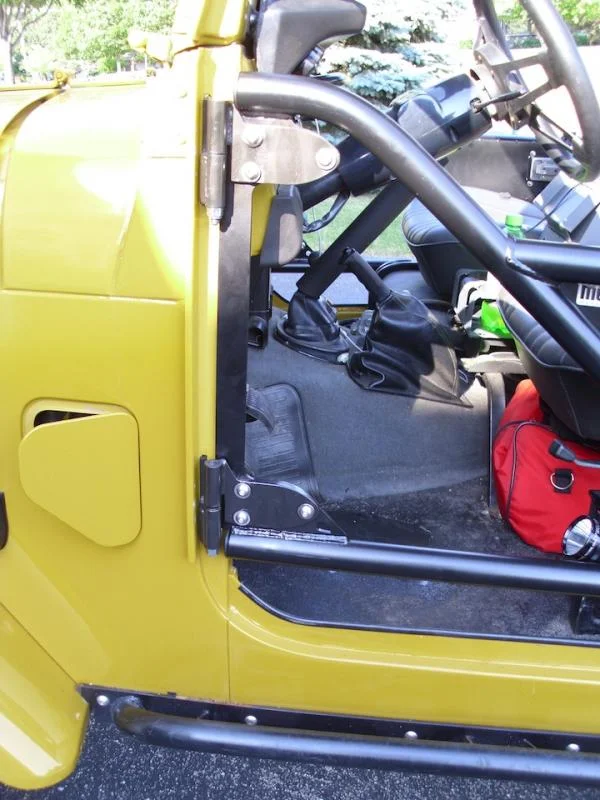

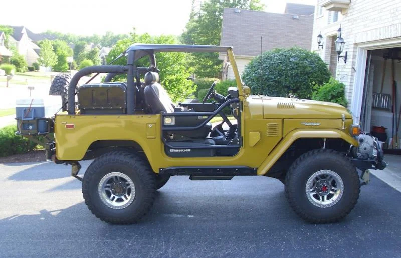

The Metal Tech doors currently list for $319.95 plus shipping on their web site: http://www.metaltech4x4.com/p-26-metal-tech-fj40-tube-doors.aspx Shipping from Oregon to Texas via UPS was $34.44. These doors were substantially lighter than the Redline doors; the Metal Tech doors are advertised as weighing 13 lbs. (I didn't weigh them or the Redline doors). I bought these doors quickly and easily from Metal Tech's web page; the transaction was simple, easy, and painless. The doors were in stock and shipped the same day as I ordered them, and arrived impressively fast, in only a few business days. The Metal Tech doors come powder coated black, which would save you some time and coin, if you want black doors. Black was fine with me after trying and missing on the color of the first doors, plus I happen to think that black anything looks good on a Rustic Green Cruiser anyway. YMMV :)
My Metal Tech doors have much more, er, "utilitarian" welds than my Redline doors. The welds are complete and I'm sure they're sturdy, but they're not near as pretty as the Redline welds (photos are of Metal Tech door welding). Mind you I'm not complaining, they're probably better than I could do myself, but they are a contrast to the Redline doors and that is the idea here.
One big place the metal Tech doors really shine is the fit of all parts and to the tub itself. Every hole was accurate and straight, every adjustment slot had full smooth range of movement, and everything fit PERFECTLY the first time, with no filing or enlargement needed anywhere. I was impressed with the perfect fit and ease of installation. Most other 4WD parts manufacturers have room for improvement in this regard, in my experience.
These doors are made to use with your own stock hard door hinges, so unless you have an extra set or are using Quik Hinges like me, you will have to remove the hinges from your hard doors to put on the Metal Tech doors. But the upside to this is, Quik Hinges (or other stock door hinges) bolt right up without any modification. My doors installed easily in minutes, and adjustment was fast and easy because everything lined up and all the holes were straight. I also put foam tape between the doors and the tub for these doors also, but in slightly different places than the Redline doors because of the difference in shape.
Both sets of doors appear to use the same (aftermarket) paddle latches, but the Metal Tech doors were easier to install and adjust because the holes were straighter and their design of the door strike plates is a little better, and they have much more room for adjustment than the Redline strike plates.
The Metal Tech doors have a small Metal Tech logo on a white background on the outside of each door. They're fairly unobtrusive, and if you don't like them I suppose you could pry them off or paint over them with black paint.
The Metal Tech doors installed on the same truck as before:
