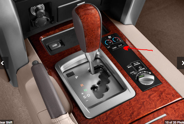

Trying to understand center diff. vs. rear vs. front lock
you mean this thing?
o_O LOL. I've only owned my 200 for 7 years. Haven't had a chance to figure it all out yet... I'm going to go out and look for all the other buttons I no longer see or have never used. Next your going to tell me I have 4LO...
yippee!
you found it :cheers: :cheers::clap:
now you can call it a day!
