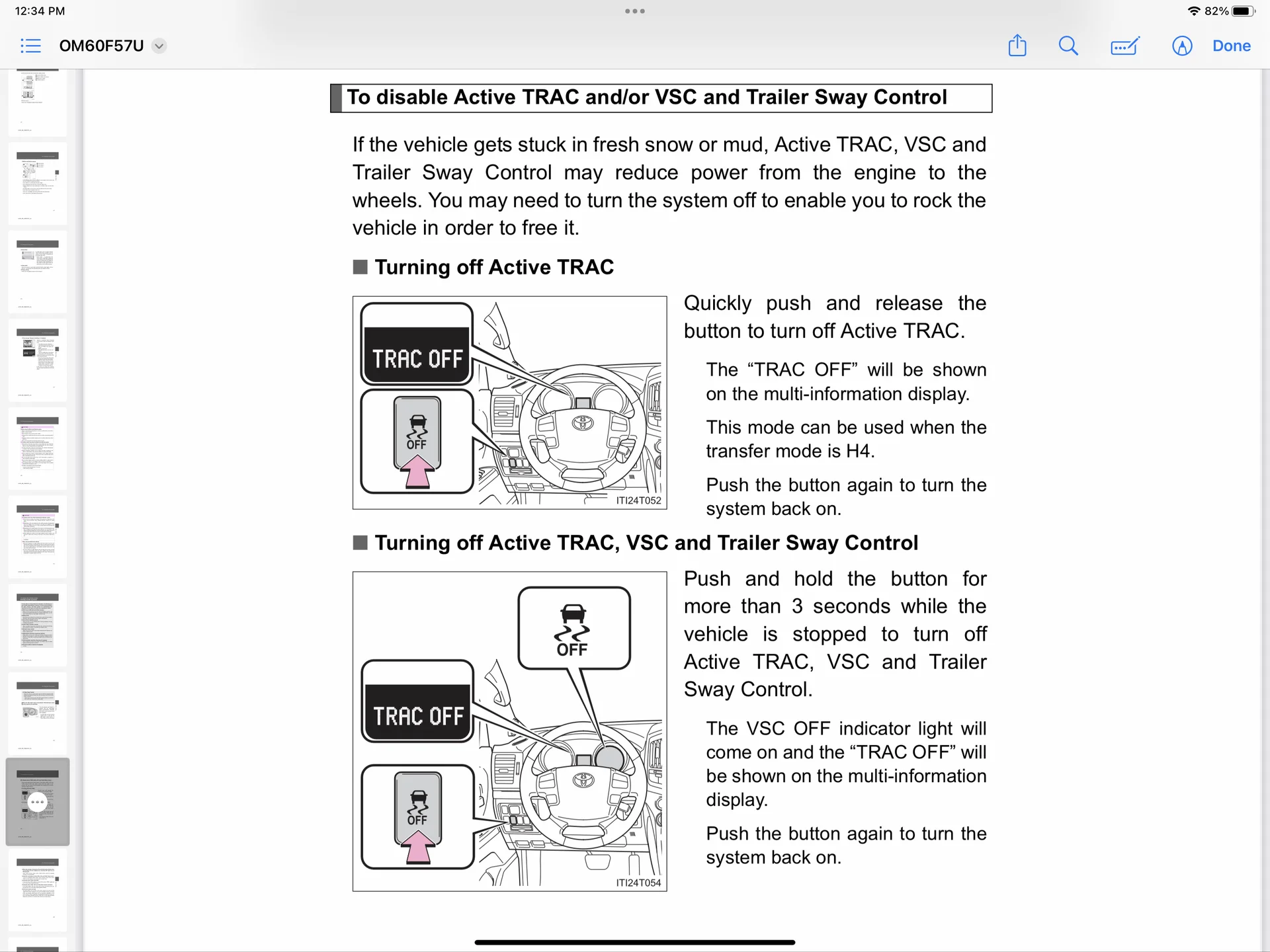

Just a couple of comments related to my 2013 LC, other years may have different options. There are 2 options with the one button, Trac Off and VSC Off. One quick push is Trac off and push and hold for 3 sec is Trac & VSC off which is even more options for your table. Also, in 4Low, Trac Off is automatic, not an option to have on or off on my 2013, so for mine, only options in 4Low are Center Diff Lock or Crawl.
Edit for snapshot from the manual
Thanks, it appears that things evolved over a few years. Mine is a '19 and I think is the same as a few years prior and good for the last years of 200's.
And, I don't consider VSC as a traction "feature" and, RSCA isn't switchable on mine (my '13 Taco does have a button for that)
Definitely must be differences by year.
VSC might be called TRAC, not sure. It is the icon of a car with the two squiggly lines, if you have that button. If you don't turn it off, it will be a huge hassle offroad, trying to brake when you want to keep momentum, etc.
VSC, TRAC (or ATRAC), MTS, and crawl are a bit confusing. To me, all of these are essentially the same thing but they are tuned and triggered differently. What I mean by they are the same thing is that each of them use the cars computer to activate ABS at each wheel independently and make throttle adjustments. What's different is when and how aggressively the computer intervention is made.
VSC is really for high speed situations when the vehicle looses traction and starts to fish tail or swerve. As you say, you don't want this on when you are 4 wheeling through mud or sand when you need to maintain momentum. What I don't know is if VCS uses anything other than wheel and transfer shaft speeds to know if the vehicle is swerving or about to.
ATRAC is different from VSC but I don't really understand what the difference is. In 4Hi you can shut off VSC but ATRAC is still on unless you hold the VSC button for 3 seconds to shut all of the computer traction control off.
MTS is the same as ATRAC except you can "select' the amount of slip (rock mode is low slip and mud/sand is high slip). Maybe ATRAC in 4Hi is just a bit tighter than rock mode??
Crawl is MTS on steroids. Its "super rock" mode (doesn't allow much slip) with 100% throttle control by the computer.
Here is a pretty good video on all of this:
I didn't know about the 3 second thing until I saw this video.

You have to hold the button down for 3+ seconds before it does anything. My 2016 LC has the RSCA OFF button, and it works in 4HI or 4LO but only if you hold it down for 3 seconds. Then a light on the dash comes on to confirm air bags are off.

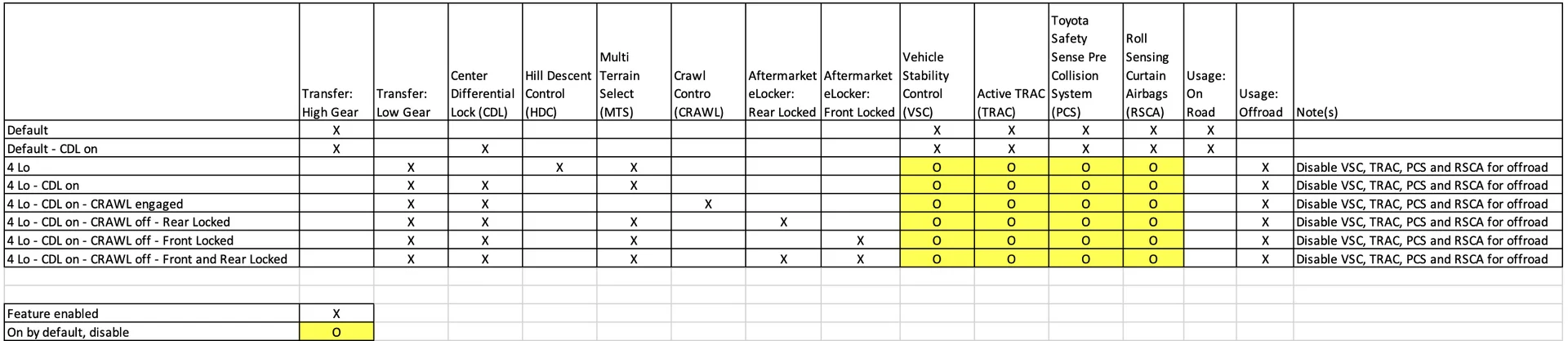

I like being in 4lo, trac off, center diff lock on, and my rear locker on for questionable crawling
