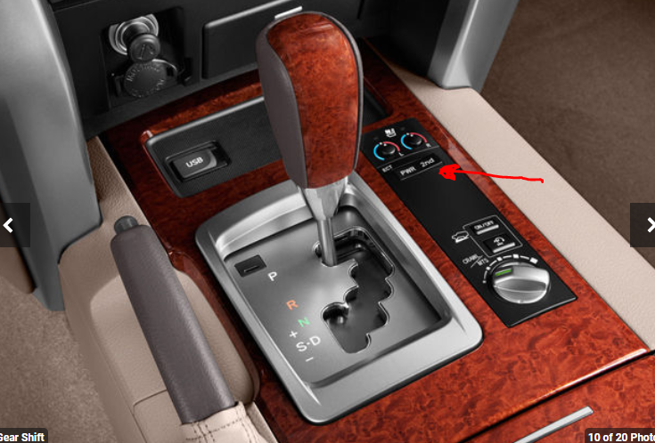

is there some automatic mode for "2nd gear start"? The only 2nd steer start I know about is manual (easy enough, don't really need some setting to lock out 1st gear, just curious). I may be doing more of that on ice with my new 4.88s installed.

I don't know about your year vehicle but mine has a button for 2nd gear start by the shifter. My '97 LX450 even has it.
you mean this thing?
o_O LOL. I've only owned my 200 for 7 years. Haven't had a chance to figure it all out yet... I'm going to go out and look for all the other buttons I no longer see or have never used. Next your going to tell me I have 4LO...
