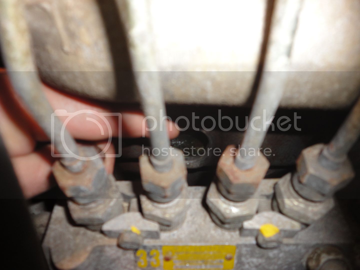

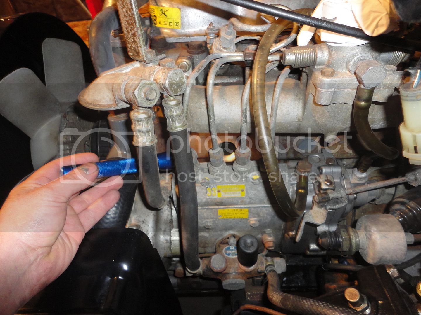

My block heater was never installed in the proper place. The 35mm plug is there, intact and looks original. My BH is directly behind the hard lines from the injection pump as seen here:
So, I can A) find a BH that will fit there, even if it's not ideal or B) Get a freeze plug, try and install it (which given the location might be a pita), pull out the 35mm plug and put the heater in there.
I like option "A" for simplicity... What plug would that be called? I see there are 28 and 30mm plugs according to a previous post...

That's where my BH is as well, must have been some tiny fingers to get it in there...

The bigger question is can you find a block heater that will fit there? How much space is there between that hole and the other side of the cylinder jacket? I don't remember (even though I've replaced all the freeze plugs on a 3B), but sometimes it's tricky to get a freeze plug that fits and does have too deep of a heating element.

That Block heater you say you are running, is it in the same spot as mine?
I have the old block heater so I will measure that and try to find a replacement. The phillips temro website has a catalog that lists 30mm BH but the question is the element size.
If it's a 28mm however, that will be a different ball game!

I have found a zerostart from phillips temro part number 3100011 that fits in this location. I'ts a 30mm and the element is small enough if you point it to the rear of the truck. I had to plug in the cable before installation as well since the IP does not leave much room.
Hope this helps someone in th future!
