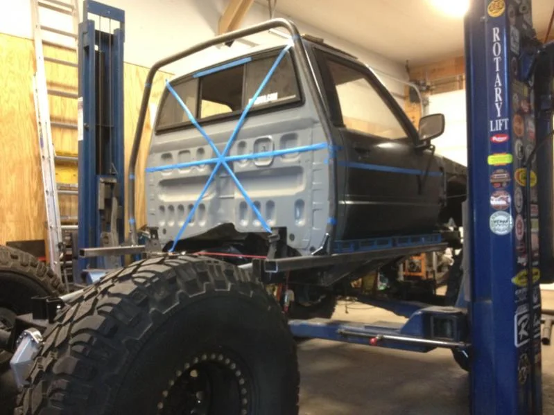

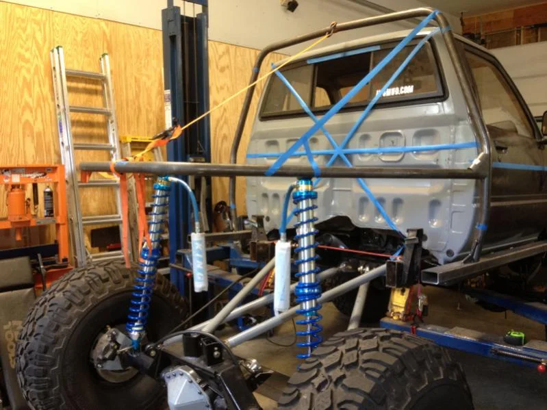

With the 39s at 30psi truck is 7'1" to top of exo and has 29" of belly clearance.
and it looks like you dont have any tubing on the front end either or a winch so that might lower it some.
I actually threw a M8000 on the front (it didn't do much), but you are right. Tubework, radiator with fluid, battery, bumper, etc will add up. I also think the springs will settle some.
Glad I did this before I welded all the rear tube on (Good idea Cam). Still a bit of a guessing game, but not as much as before.

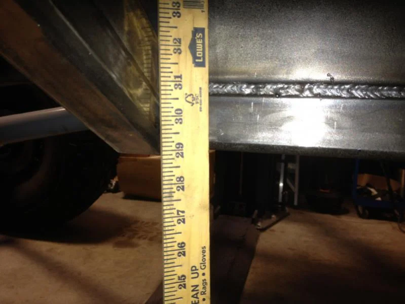

That looks like the measuring stick the state trooper used on my truck!
Yeah, I'd be in a bit of trouble too if they broke out the stick on me right now too. Might have to get some adapters to put the Mini's wheels on this if I ever drive it on the road.

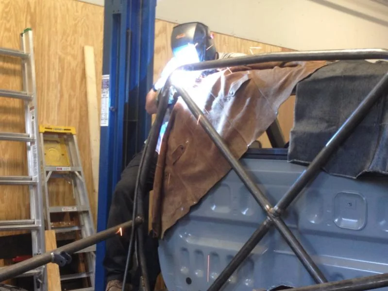

My brother came over Saturday and Cam on Sunday and gave me a hand turning blue tape into steel tubing.
Cam sweltered much of the tube for me. It would have taken me days. Thanks dude.

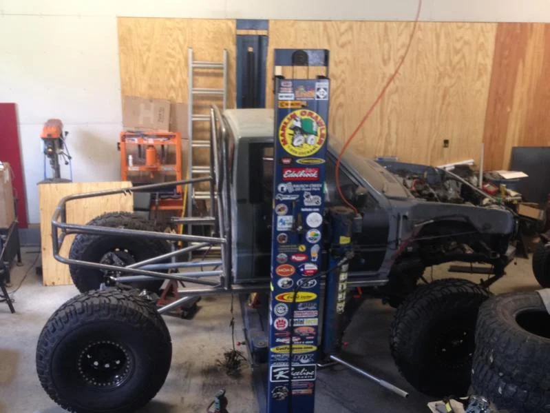

So is this thing going to be ready for fall crawl?
Great progress!
