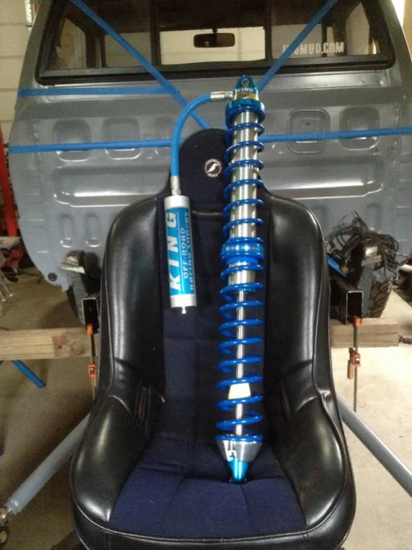

King 2.5 x 14 with internal bypass. Purchased from Downsouth Motorsports.
Tony, good thing your 4 Runner is about done, else is would be about to be put on the back burner.
Well, that doesn't look like those will make very good espresso...
I hear you, timing is everything. Those are amazing.
ah so thats what the new suspension seats look like. Dont look too comfortable.
