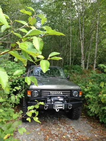

These are the newest version they offer right? I have the older truck lite model with multiple LEDs. I'm curios to see what kind of light output they give. Mine have a very sharp cutoff but I'm not sure I'm impressed compared to the speaker LED.

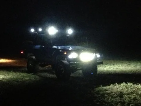

So I bought these from eBay... I really wanted the JW speakers, but they were more than I was willing to spend. I took the rig dove hunting this evening and the lights are noticeably brighter by a lot. There is a very sharp cut off, and may need to adjust them up a little. I'll try to get a pick of just the headlights at night.
Here's one I took to show my neighbor of all the LED's I put on over the weekend... All turn, stop, marker etc, front bar, Rigid duallies up top and rock lights. Still need to swap the one on back but will get to that in the next day or so.

Wow that is impressive! Neighbors must have thought they spotted a low flying UFO...
