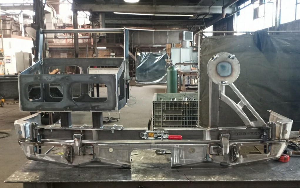

Ordered an RLC rear swingout bumper. James @ RLC has been great to work with. He did several customizations to suit my setup:
  • Equal length swingouts
  • Horizontal latch (required because of the above)
  • Roadvision tail light cut-outs
  • Changes to the jerry can carrier to also function as a ladder for the occasion I need to get on the roof
  • Wider (more square, really) trailer hitch opening so I can more easily access the locking pin
Cost was also very reasonable, and start/payment to delivery will be less than 6 weeks.
Given that the powdercoat on my front bumper only lasted a few years before starting to rust, and my sliders made it longer but even still the diamond plate on those is starting to rust, I decided to prep and paint the rear with POR15. I ordered some cleaner, metal prep, base, and top coat and will take a week or two once it arrives to paint before installing. Not sure how much material I'll need but if I estimated right it'll be about $120 vs $400-500 to PC it.
While waiting on build/delivery I built a wiring harness for the lights. Info including the schematic and parts is posted in the RLC thread at RLC rear tire carrier / swing out / jerry can / custom fab bumper - https://forum.ih8mud.com/threads/rlc-rear-tire-carrier-swing-out-jerry-can-custom-fab-bumper.871580/page-44#post-14358929. My goal was something completely plug-and-play - no splicing of any Toyota wiring required. I tested it with a 12V battery today (just applying power directly to the pins) and it worked perfectly as expected.
Will update with photos once it's received and I get rolling but James sent me a photo of it in-progress recently

What made you to decide to go with tire carrier on the right? I've certainly see both and pondered it myself. I went left for mirror or over the shoulder visibility and am happy I did that. The top of my cargo box I mounted on the accessory swing out is at the bottom of the rear window and I can just barley see it in the mirror.
Bumper looks great! What are the brackets thingy's next to the tow points? Locks for the swing outs?
I think the POR-15 is a good play with proper prep/application process. I use it to touch up my PC but I have been lax with the prep and my touchups are flaking off where they overlap the PC. The POR15 sticks to the bare metal places fairly well, even with little prep (just washing with water). Getting rust protection but it doesn't look so great. Who really wants a clean and shiny 200 anyway except maybe most original owners...

James does it on the right. I'm sure he could have swapped it, but I didn't have a huge preference. The spare tire sits a bit to the right of center so it seemed sensible to keep the weight on that side, especially since I only have one drawer and it's on the left.
I think those are guides to align the swing outs. Not sure if locking pins fit into those or what... we'll see.
POR15 seems harder than PC, so I'm hoping it holds up better. With the chassis black top coat it's a matte or maybe eggshell finish so decent. I do like the idea of an easy-to-match touchup option, as opposed to PC in which Rustoleum matches until it fades and then looks terrible. I'm hoping with using the metal prep which supposedly etches the metal that it'll stick pretty well. I do like to clean the LC maybe twice a year, typically before a big trip, but it's dirty within a few days anyway.

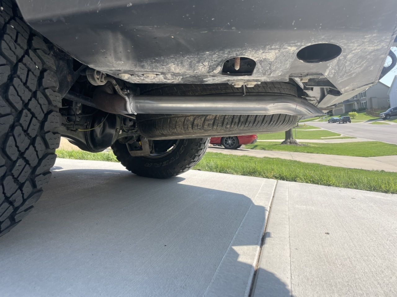

A sawzall with a long metal blade makes quick work of the resonator.
Yeah. For the moment it doesn't really bother me. If I chop it I kinda want to point the exhaust away from the undercarriage, and I have no welding skills (or tools)

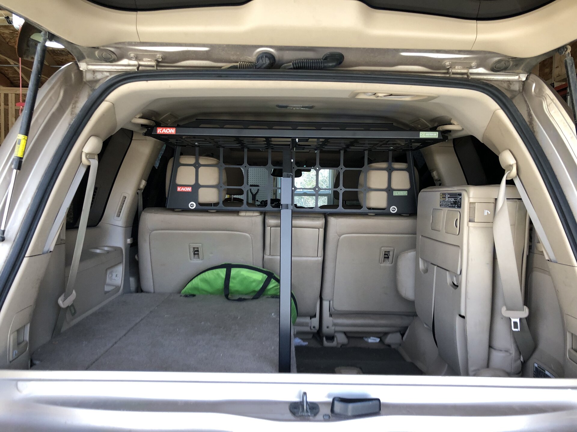

Added a Kaon barrier, shelf, and divider this weekend. Props to Kaon, shipped direct from Australia. Expensive but a very nice piece of gear, which should keep the dog contained and the gear secured.
I like everything except the hassle to use the 3rd row seat. Will likely replace a number of the screws with knobs so I can dismantle easily as needed. Need to think about how to do the same with the divider as that screws into the drawer, and I’m fairly sure if I unscrew it enough times the screws will eventually weaken the threads they’ve made in the wood.

Yeah I have those and thought about it. But where the divider mounts to the top of drawer I can’t access from the underside anymore. The problem is I used 8020 rails which are secured from the top, but the top is now carpeted so I can’t access the bolts that hold the rails in place without cutting the carpet up.
I was thinking about it while lying in bed jet lagged and unable to fall back asleep this morning. What I may do is get a strip of 1/4” aluminum bar to place underneath the divider, use recessed screws to bolt that to the divider, and then bolt the bar to the drawer using T nuts, as a 2” wide piece would allow me to bolt the bar down offset from the rail. Then if I want to remove the divider I just need to remove those ~4 bolts
Do you mean in the event of an accident? Do you guys not access gear in the back while driving?
Well that too. My 75# dog has a habit of deciding he's no longer happy in the back and then insisting that he needs to jump into the middle row. Or if someone is sitting in the 3rd row, sometimes he'll just decide to plop down on whichever kid is sitting there. So if he's sitting on top of the drawer, this should put an end to that nonsense. I do like the idea of keeping gear from flying around in the event of an accident, though despite how the Kaon shelving mounts I wouldn't count on it holding back a cooler if I rolled the truck while flying down the highway at 75 mph. I'd definitely still strap down heavy cargo like the cooler.
I do somewhat regularly have one of the kids reach/climb back to access stuff in the trunk... cooler, snacks, backpacks of books and other stuff they bring on a long trip, etc. This setup will mean more planning, or at least dropping through the middle seat arm rest and stashing stuff directly behind it. I would have preferred a 2nd/3rd row divider panel which was 3 pieces (an "upside down U frame that attached the headrests and grab handle mounts" and then a left and right panel that could be independently added/removed) that bolted together. If the design did that I would have left the passenger's side off, so the cooler would still be accessible. That setup would be more convenient for me for accessing the 3rd row seat, too.
I realize though that Kaon can't build something sturdy and infinitely flexible and still keep it affordable, so I'm ok with the tradeoff as I'm sure I've got a relatively rare use case. Even if it solved the above, then I'd probably complain about the occasional Home Depot run still being a hassle. As a compromise I have replaced a couple of the bolts with knobs and I'm part way through fabricating a plate to allow me to easily remove the divider, so my hope is that I can get to a point where it's ~5 minutes to add the dividers back in for a weekend trip and then pull them out just as easily when we're done so day-to-day usage isn't really affected.
