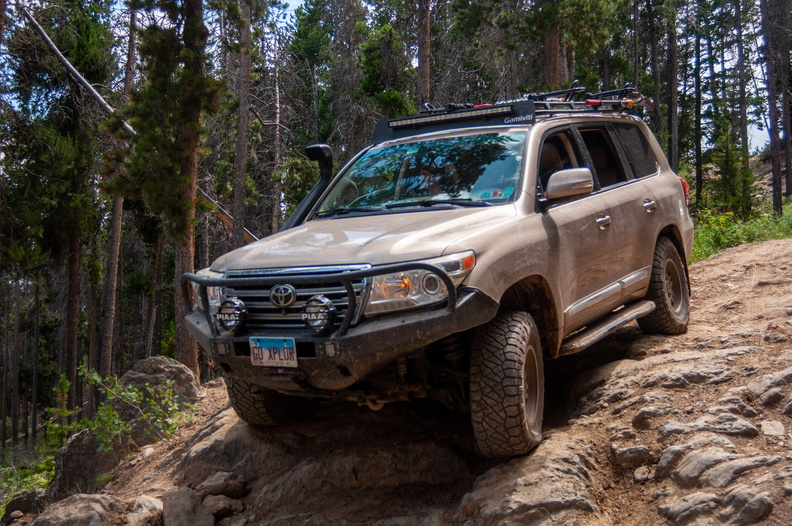

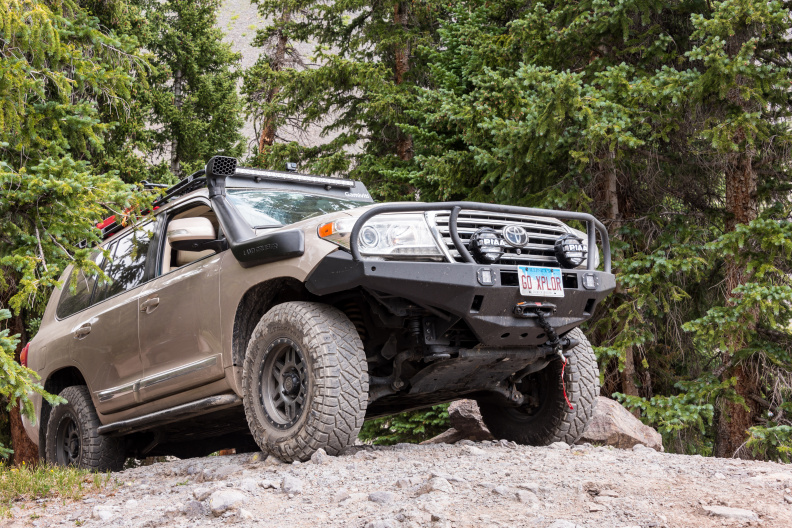

Anymore pictures of your rig and the Trail Tailor front bumper? It might the only full guard full replacement bumper for the pre-2016's that I don't hate. I appreciate the stoutness and air bag compatibility of the Aussie stuff but man those things are just ugly and stick out way too far.
I've got tons of photos in my travel gallery, depends a bit on what you want. If there's a specific angle or measurement you want, let me know.
The TT bumper isn't quite a shallow as the Dissent one, but it's better than ARB for sure. IIRC at the time my options were ARB, TJM, Ironman, and Trail Tailor. If I was doing it now it would be a decision between Trail Tailor and Dissent for me.

I appreciate the pics and links, I think it looks beautiful!!! I really like the Dissent bumpers as well but I'm interested in a full guard bumper mostly for animal strike protection. With the Dissent bumper sitting so flush and being aluminum I don't think it would protect all too much. The aussie brands would offer the ultimate protection but they are gawdy looking and bulky. I think the TT strikes a good balance between looks, profile and protection.
The best animal strike protection is probably the ARB, honestly. Anything which replaces the plastic bumper completely will put your steel bumper very close to the headlights, grill, and other components. In a serious strike it will likely not protect the vehicle from damage, though it should help protect the occupants. Most of these will likely reduce the overall damage though and for smaller strikes like deer without antlers all will probably save you from damage
Agreed. I guess it's all about compromises. While the ARB is great for animal strikes and stoutness it probably weighs close 100lbs more than the TT. If I do hit something hopefully there's enough protection that all major components are still fine and I could still make it home.

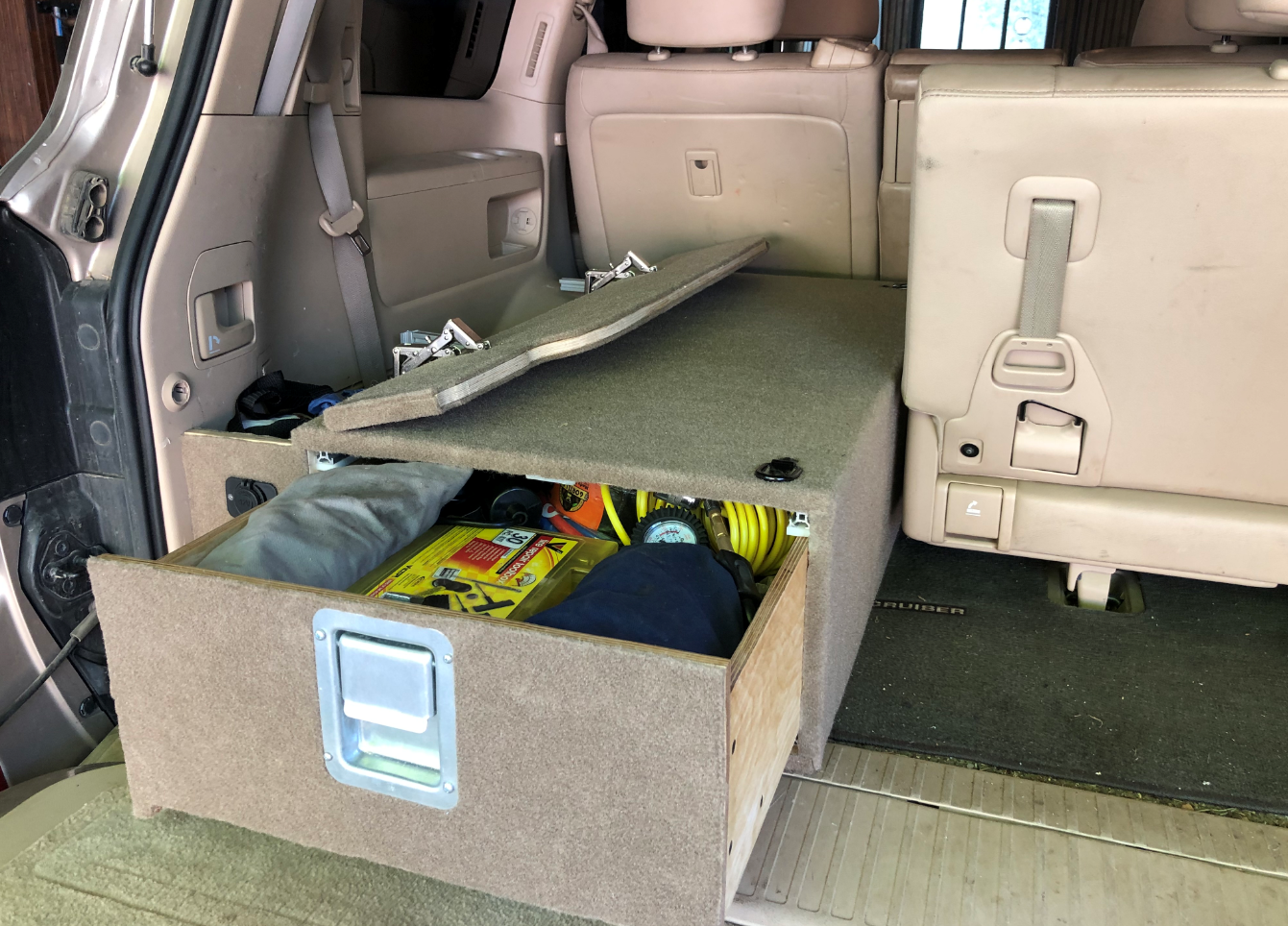

I need to finish the actual drawer. Waiting on some t-slot nuts to arrive (USPS says Monday) as I miscounted when I originally ordered. To keep me occupied I mounted the drawer in the truck yesterday evening and the mounted the jack this morning in the front cubby.
Finished the drawer this week. And promptly filled it completely. Wow. Actually it's not *quite* done, I need to put some small straps on the slide out table as I can't actually get it out with the drawer in place right now.
If I had to do it again I think I'd buy a set of heavy duty ball bearing rails. The UHMW slides are fine if the drawer is lightly filled. But I must have at least 200# of stuff in it, possibly more, and I almost cannot pull the drawer out by the handle alone. And I even used UHMW tape on the bottom of the drawer where it meets the slide in order to help reduce friction even further.
I might move the Superflow MV90 air compressor which is in the drawer into the side compartment, but that does limit access to it a bit when I'm on a trail if I have stuff on top of the drawer. Might be an excuse to get an ARB Twin and mount it under the hood, but it's hard to drop $550 on one when I spent $100 on the Superflow which is just as fast and it works just fine.
