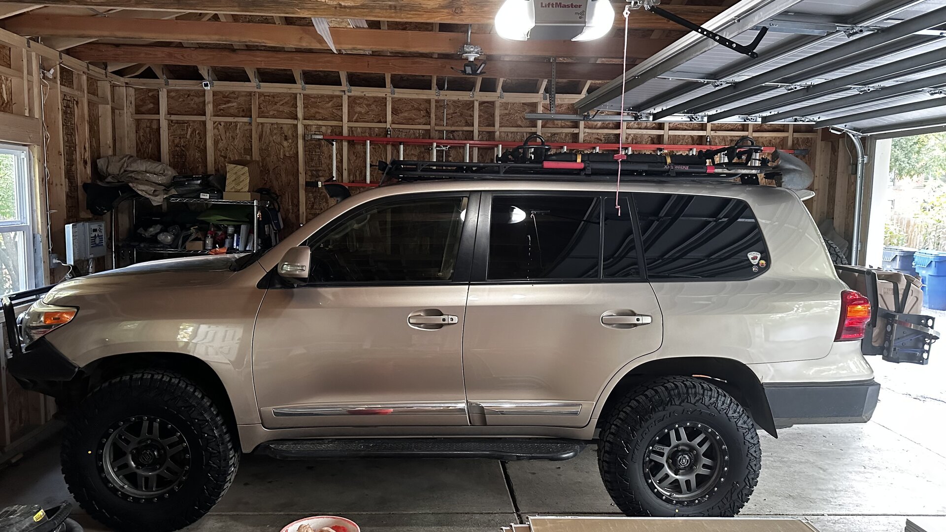

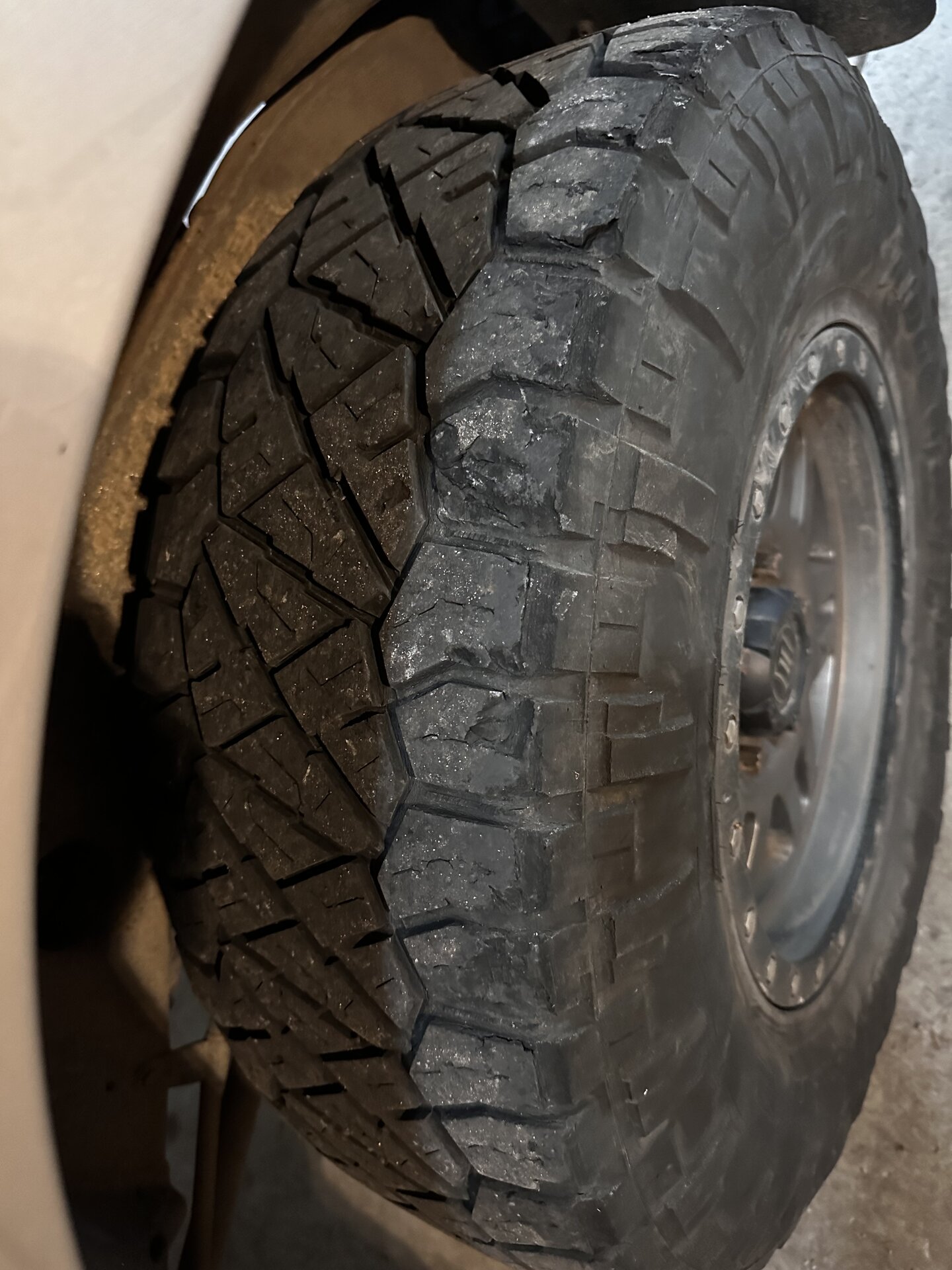

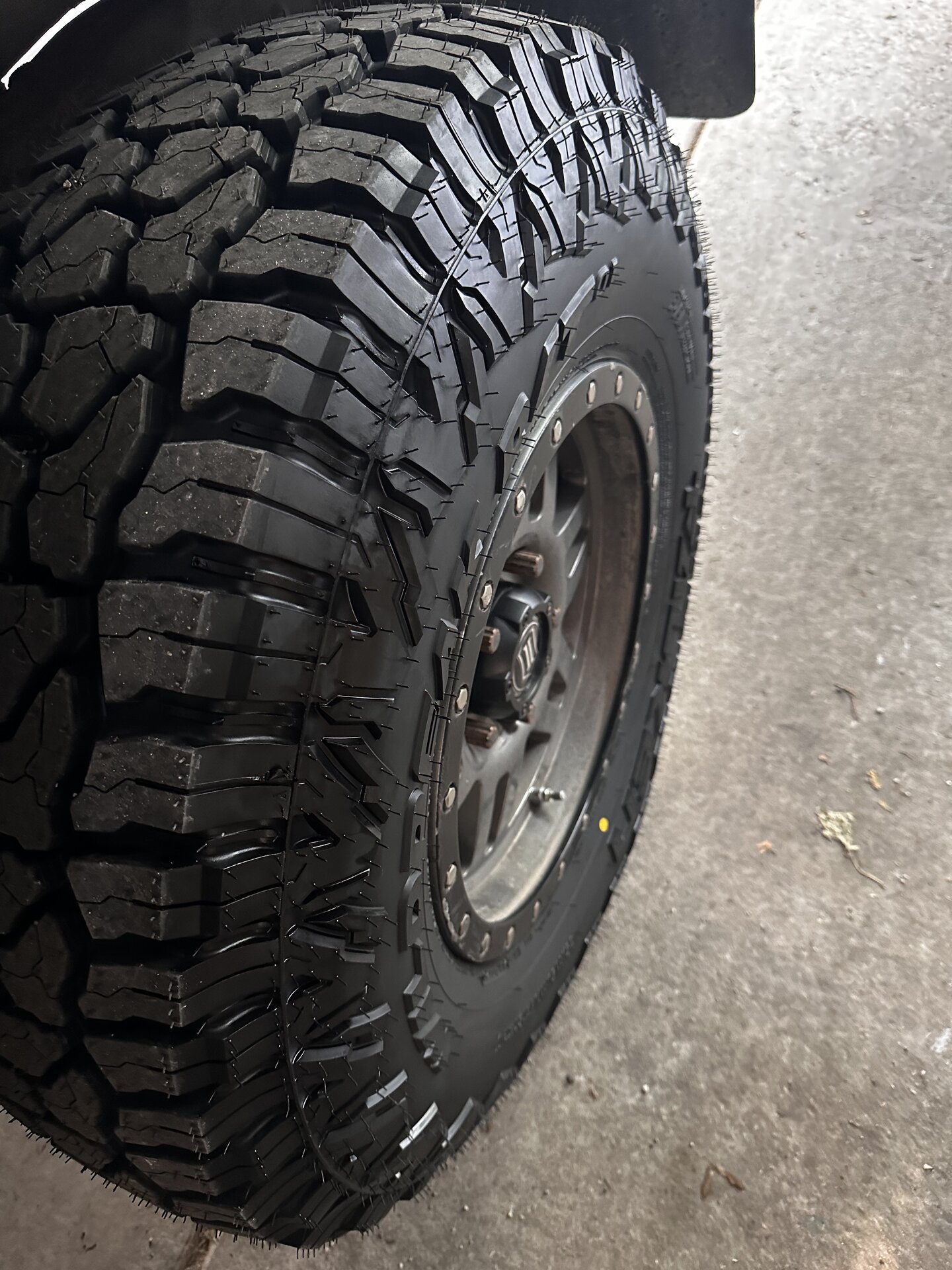

Out with the old, in with the new. Joined the 35s club with Falken Wildpeak R/T01 in 35x11.5R17. Very first impressions: a bit more compliant on bumps than the Nitto Ridge Grappler even at a slightly lower PSI (though this is a C load tire vs the E load I had), but also slightly louder than a new Nitto RG (but waaaaay quieter than a Nitto with 30k miles on it).
I'm excited to try them in some snow this winter - the partially siped edges make me think these should do rather well, even though they're not 3-snowflake rated.
Falken quotes this 35" tire as 34.8", so as close to a "true 35" as you can get I think. So far no rubbing at full lock very low speed parking. (Though for others reference I do have the KDSS relo kit and I'm on +25 offset wheels).

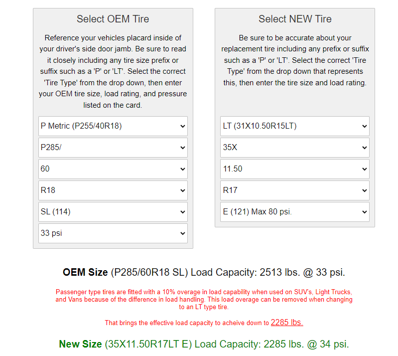

Based on this calculator I think the correct tire pressure for a 35x11.5r17 is 34psi. Paging @gaijin to confirm, as Discount Tire set mine at 39psi, which I assume was done to match the 2500# stated load capacity of a P285/60r18 and not to match the SUV-derated load capacity of the same.
The bigger question is what I should run my rear tires at when towing, as my rear axle weight can approach 5400# when I'm completely loaded down. If I use the same calculator with my new tire as the OEM and bump the PSI up I'm thinking I should probably run 44-45psi in the rear

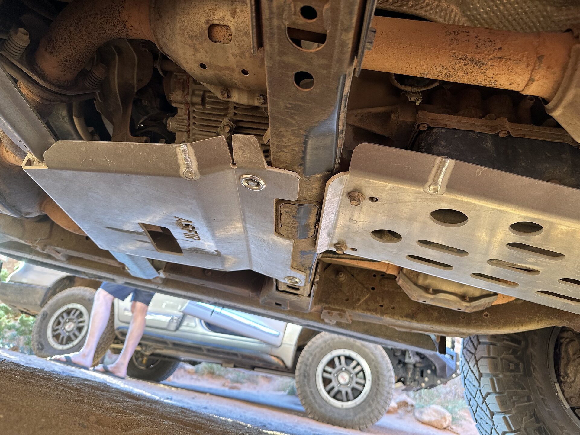

Asfir transfer case skid took a good hit in Moab somewhere in the Maze (I think on our way to the Dollhouse). Seems to have done its job. I need to pull it off and straighten it with a BFH.

My calcs show that the RCTIP for those 35x11.50R17LT E tires on your 2013 LC200 is 35psi F/R.
34psi is OK, it's only one lb short by my calcs, but I always round up to be safe.
I've given up trying to figure out DT recommendations... I just assume they are wrong unless I can verify.
Since the Rear GAWR for your 2013 LC200 is only 4300 lb, and you are weighing in at 5420 lb, you are overweight. Your choice, but I have no recommendation for that.
Just my US$0.02, but I'd leave it alone. Simply banging it back into shape may make it look better, but may actually weaken/fatigue the metal and leave it less strong for the next impact.
HTH
Fair enough. I'm going to pull it and see how much clearance there now is to the transfer case. If it's close I will likely try to straighten it, but if it's not then I will take your advice and leave it be.

Your tire load ratings are pretty close to mine. Your vehicle weight solo a bit heavier, and towing weights similar.
Unladen
34/35 PSI is good from a tire load perspective. If that feels good to you, then you are good to go. I find that I like 38-40 PSI much better from a handling and stability perspective. The ride is still comfortable but with taller sidewalls and a higher center of gravity, the few added PSI buys quite a bit more stability and cornering traction. At 35 PSI, my sidewalls will roll over too easily and cornering traction suffers. I get more cornering traction with a few more PSI and the shoulder tread blocks don't see as much punishment for my driving style. A bit more MPG efficiency is good here too. Props to DT for a good starting pressure, probably from more practical experience.
Towing
Definitely need to air up the rear tires and 45-48 PSI is what I target. The front doesn't necessarily need more air from a load perspective but can really benefit from more air as it plays a part in lateral and sway stability of the combined rig with more dynamic loads. I'll target 40-43 PSI at the front. I go for the higher end of those ranges for a few factors - heavier load out, hot summer days, high winds, and/or mountain driving.
Unladen
Towing
Thank you sir, I appreciate the real world experience.
