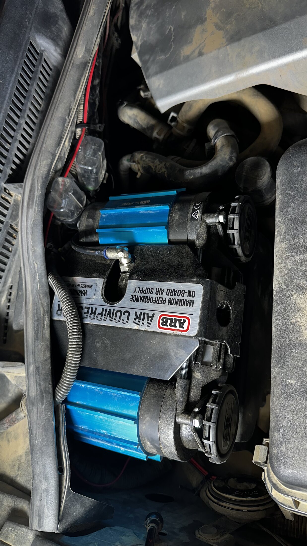

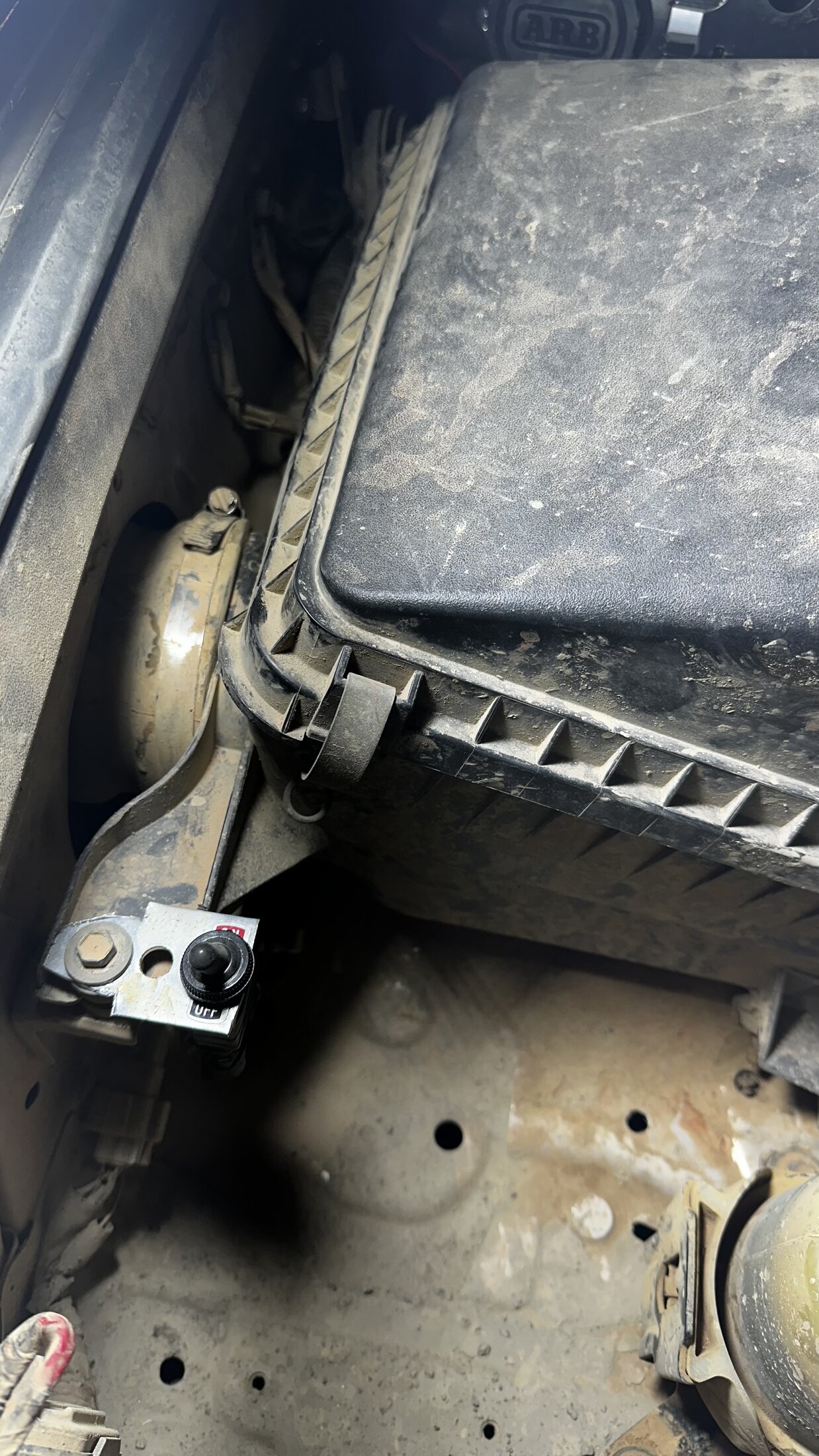

ARB twin installed on the SDHQ passengers side mount. I need to wire it up before it gets too cold. I didn’t want to use the whole harness for air lockers so I just purchased a basic switch and the 3-pin 150-series connector.

FINE! 🤣.
Well the compressor photos will prove I did it. I don’t have any sunroof photos from the swap, and TBH you really can tell the difference visually, it’s only obvious when you feel the difference in rubber softness. Still I wish I’d taken a couple pics while I was doing the sunroof, so maybe in another 10 years I’ll oblige :)
FINE! 🤣.
